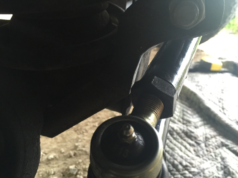

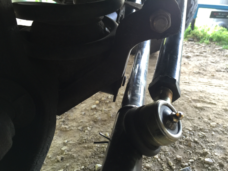

So I got hold of Rustys, basically bad instructions with the kit. Per the instructions and the Photo. The drag link tie rod end is to mount with the nut pointed down. Rusty said to rotate it about 10°. My clearances lot better, tried to upload photo but my phones not cooperating.

image-3054929221.jpg. Before
After

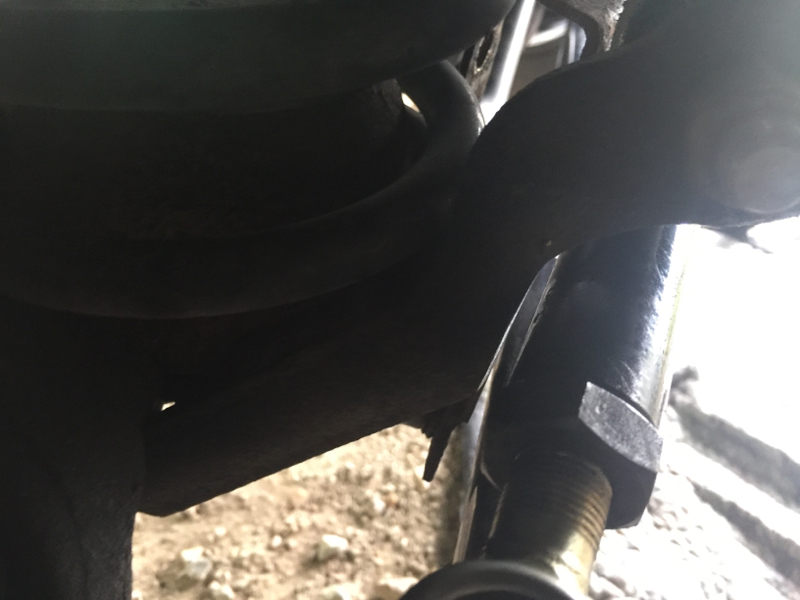

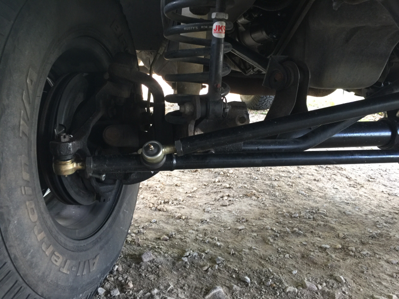

So finally adjusted my steering for the last time, turns almost as much as stock. Tie rod rubs just a touch on the new replacement bolt for the track bar from Rustys. Feels great, firm. Still think offset tie rods would be better. With that said I give it 5 and 3/4 stars.....
