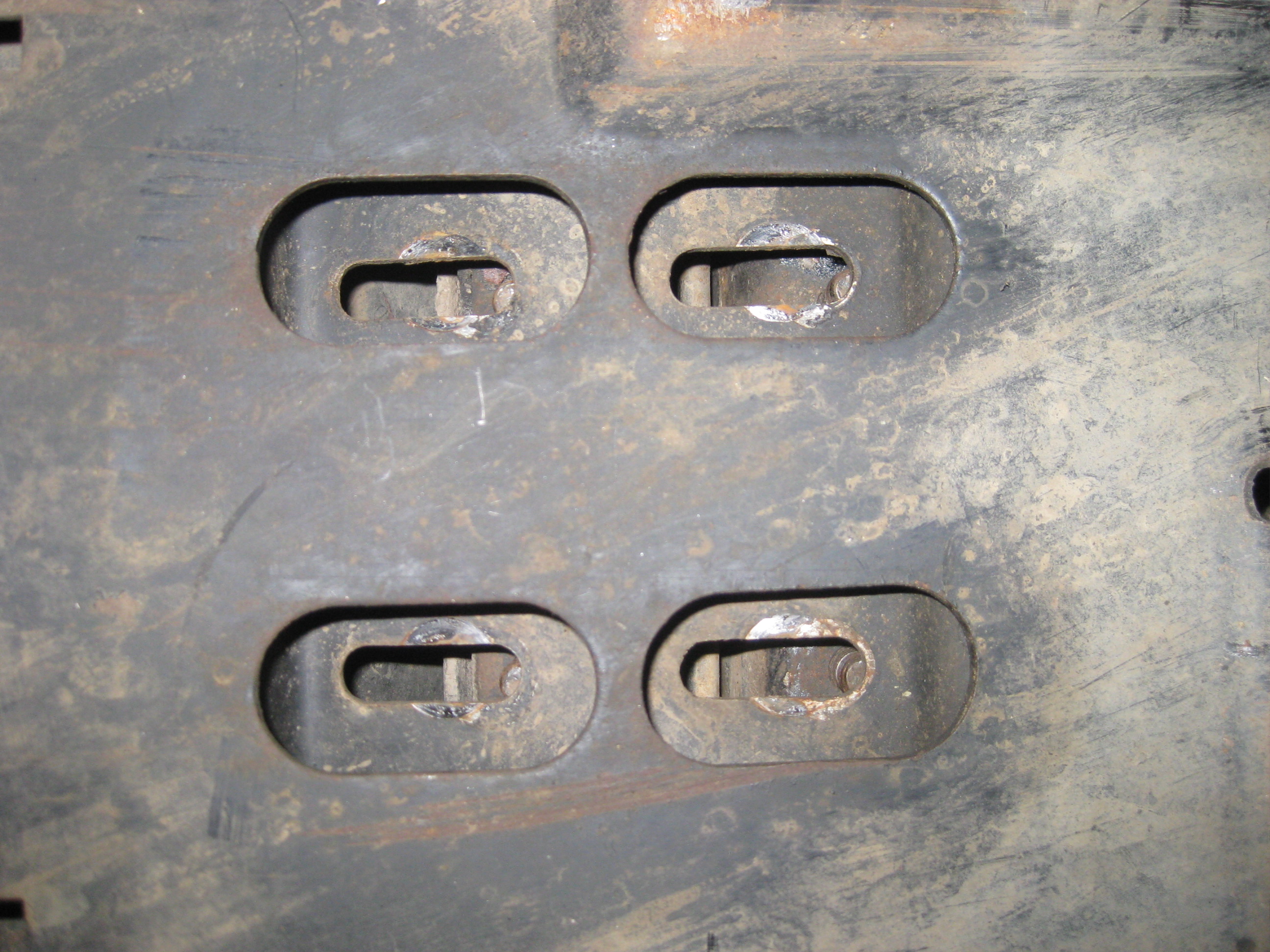

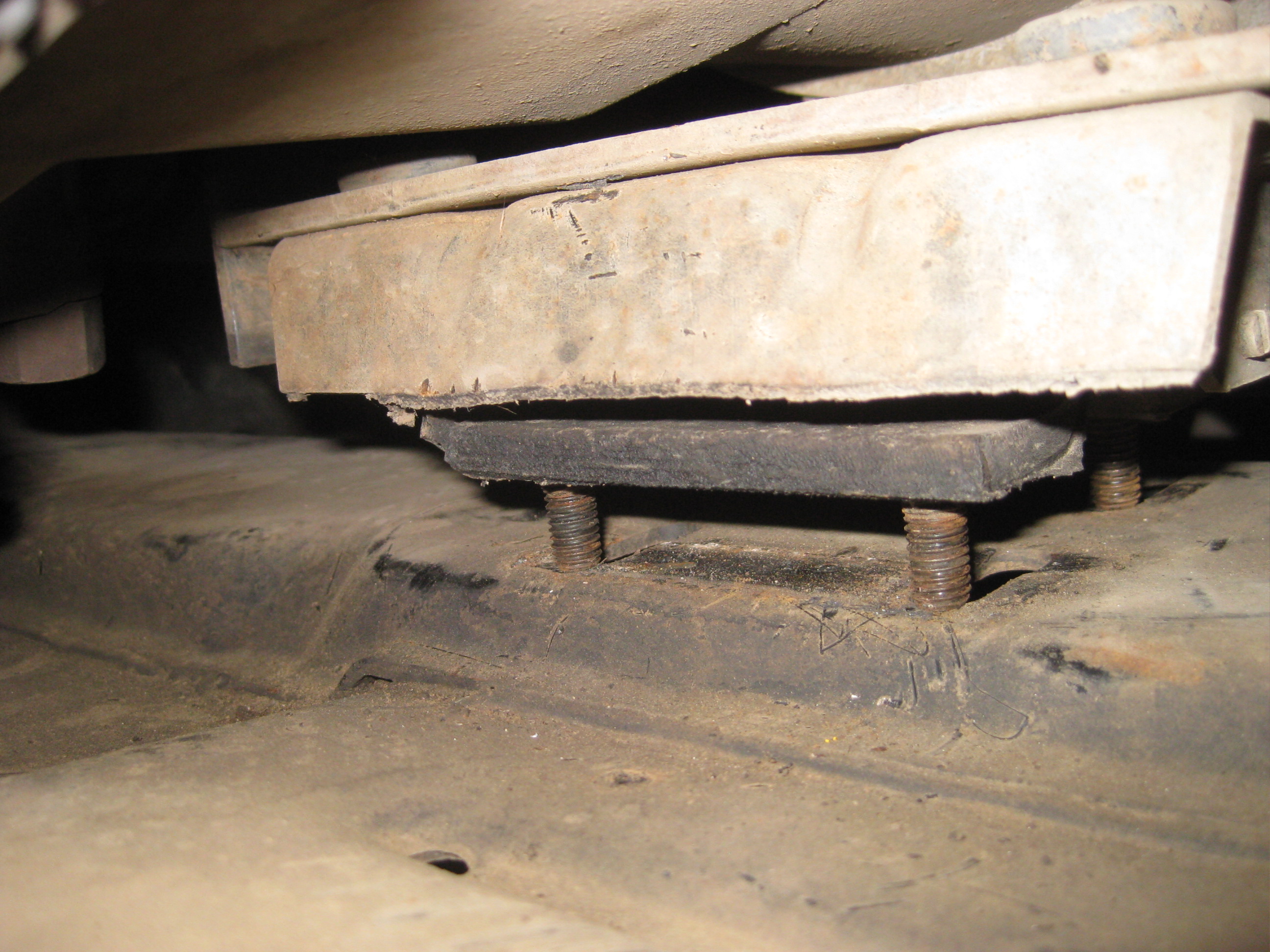

So here is a bit of background. I took my my skid plate to take off the 1inch transfer case drop, when I went to put the skid plate back on, the bolts on the bottom of the TC are not lining up. Any advice on how to get them to line out would be appreciated. Anyone had this problem before?

I started the Trans bolts first then started the skid to frame.
Leave the skid plate a little loose so it would shift side to side, forward and back. Use a prybar to shift it till the bolts line up and fall into place then tighten all the skid plate bolts.
I forgot to mention, the second picture was taken from the back of the transfer case skid plate.
