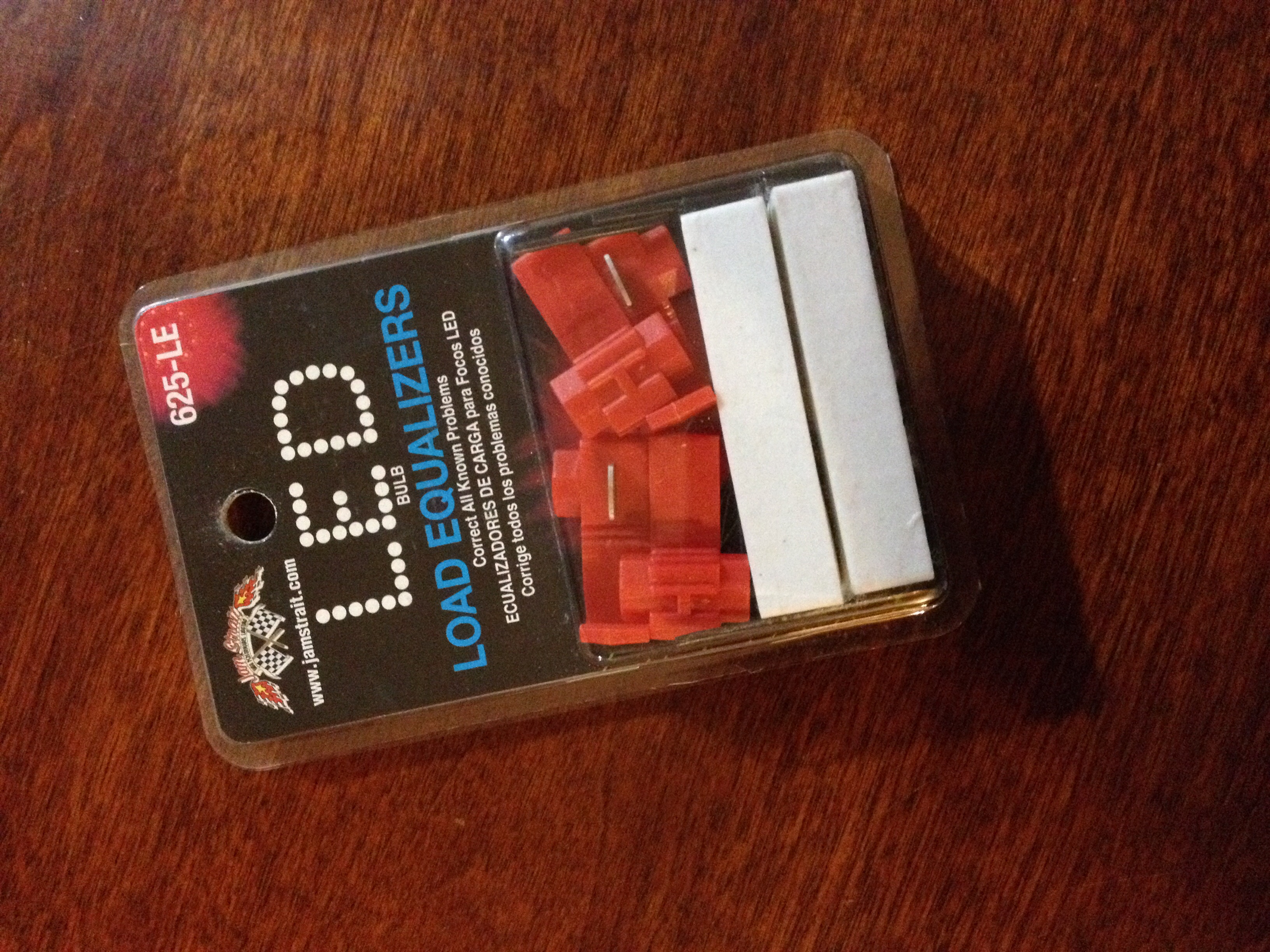

image.jpgWell, I finally gave up. I got a resistor from O'Reilly's (an actual LED resistor kit - pictured) and my blinker worked. No brake lights though. Then when I was snapping the quick splice together I broke the flimsy wire from the resistor. Which was my breaking point. I then went to Walmart with my tail between my legs, and bought 2 round, flush mount lights (identical but not LED) and installed them.
