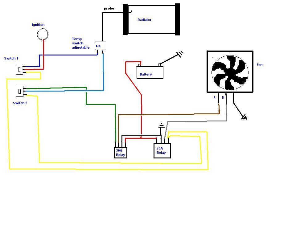

Thankya very much my gun totin buddy, yes it will pull more than it will push, i have a wiring digram on my other computer if you need it i can send it tomorrow, im at the firestation today pulling a 48.

Use it as a puller. And if you have it, you can adjust the shroud of the Taurus to the YJ radiator for even better cooling (if you use the fan without a shroud, it will not cool evenly so it will be less efficient). As for the radiator itself, no, you cannot use a CJ one on a YJ, but there are some cheap ones out there that should work fine. I got an all alluminum one for about $130 shipped, and it cools MUCH better than the stock one (even though it is only 1 row).
Thanks for the diagram. On the adjustable temp. switch, Is that one that you can get from Jegs or Summit? And I am putting a single speed fan on my CJ, do I just eliminate one of the relays and if so what amperage relay do I use?
Depends on the fan and the speed you choose. For high speed on the Taurus, think BIG (70A). For low speed, 40A should work fine...
The fan on my cj is just a generic single speed fan that was given to me, so I was wondering if I need to stay smart and go with a big relay or a small 40A? Also what amperage fuse would be the best for the application(20A-30A)?
