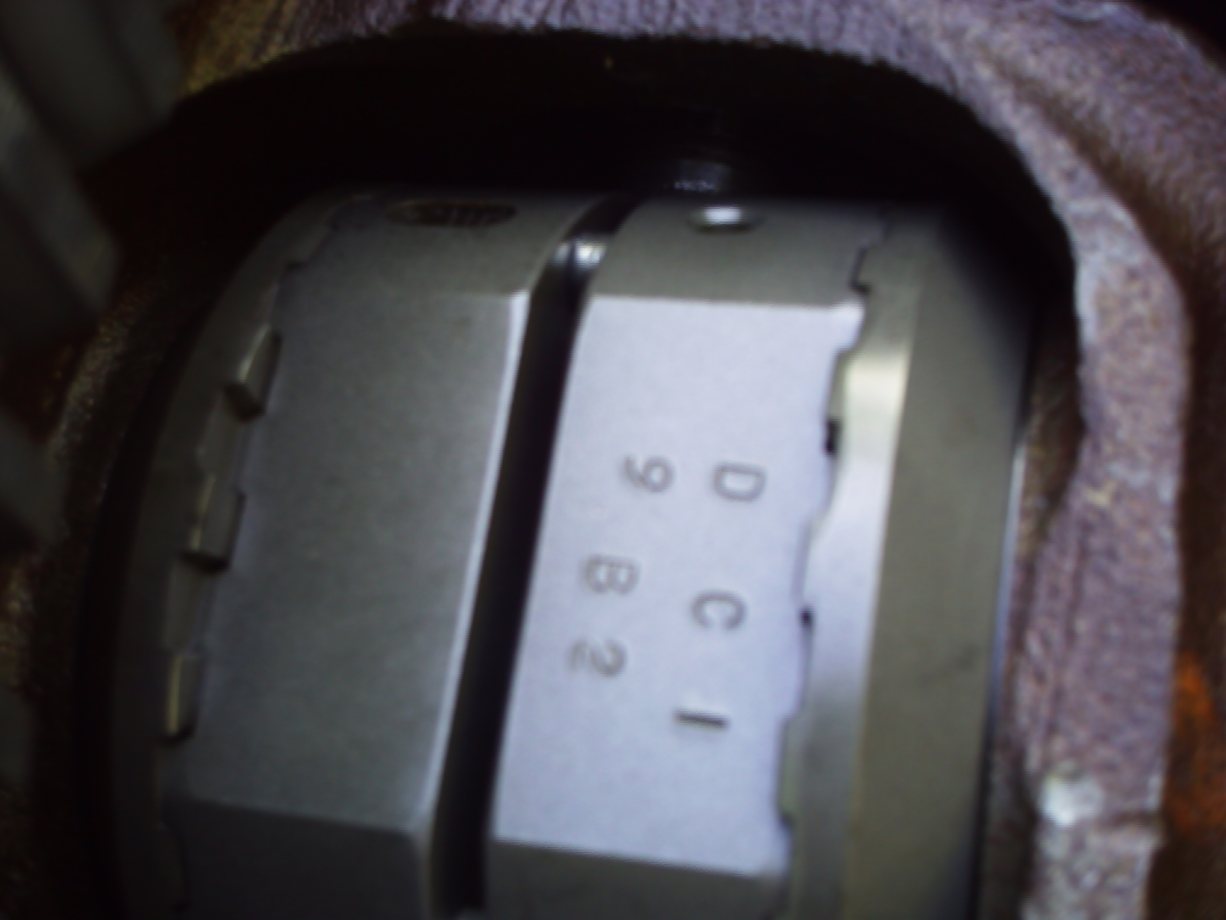

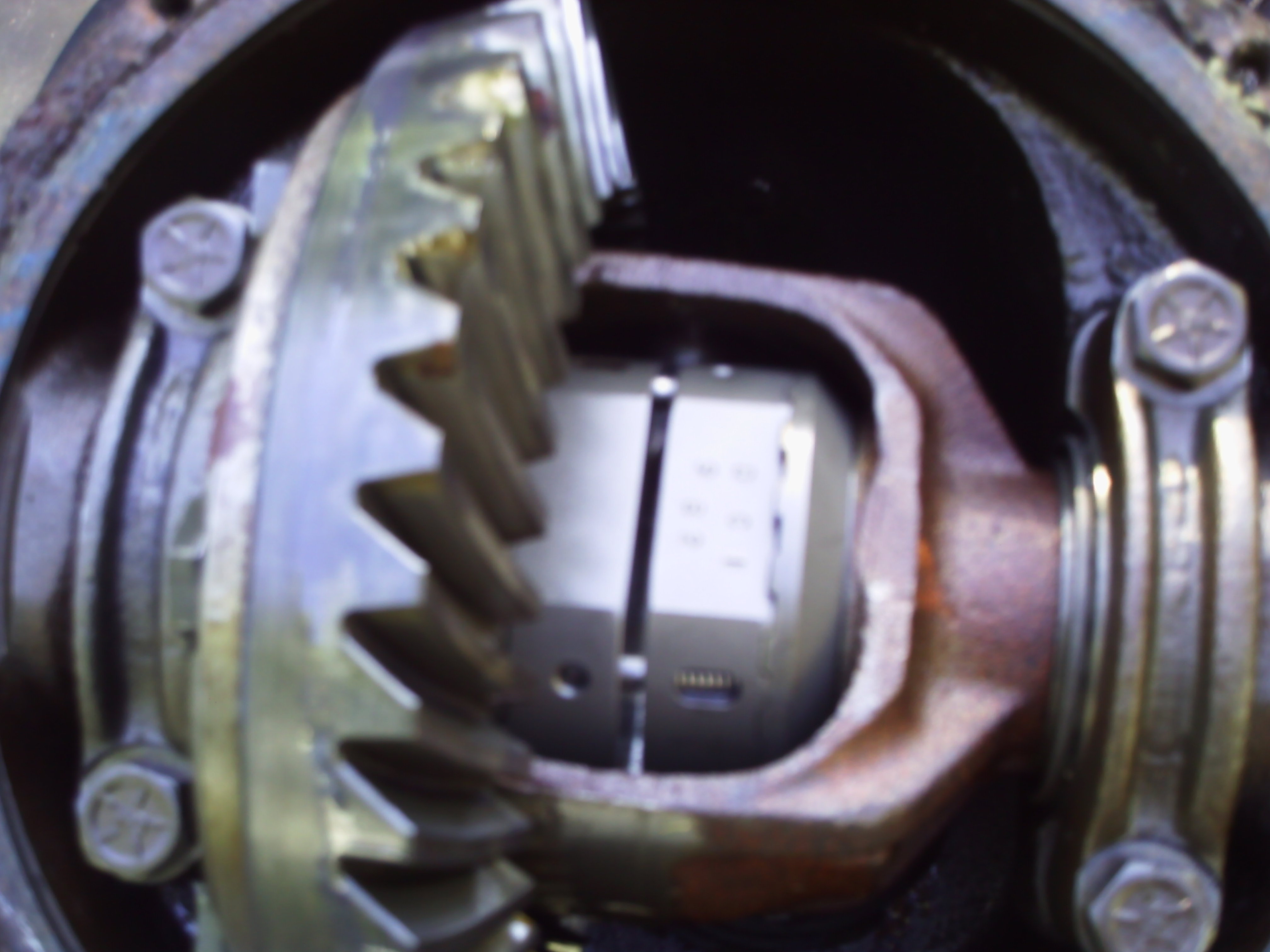

just bought it a yard sale. I am wondering if the internal unit will work in my 78 AMC 20 rear end. It is suppose to be some type of a locker unit.

That looks like one of those lunch time lockers: Lock right etc.
Is the Diff cover round? AMC used model 20's so did Jeep. What gears?

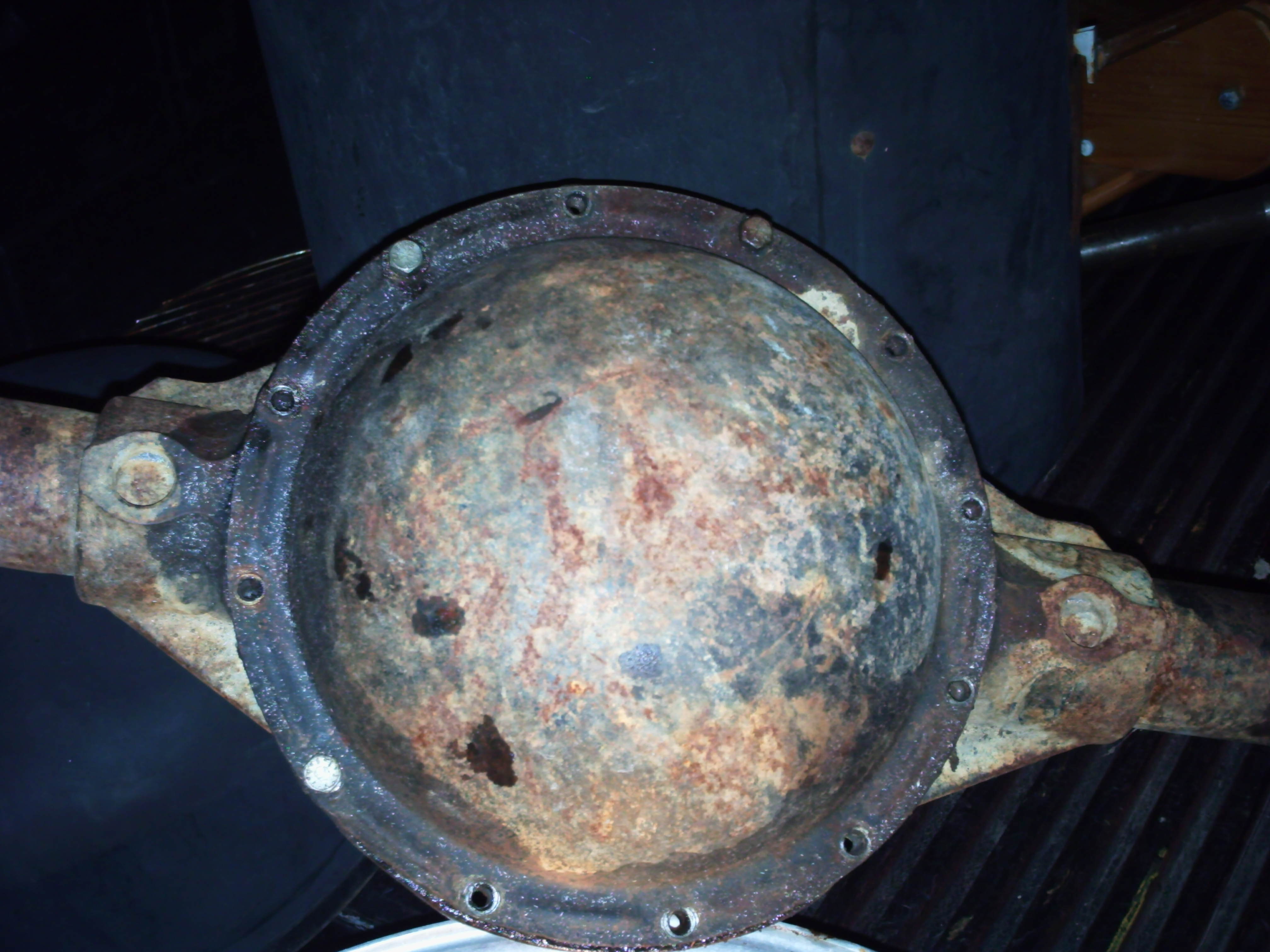

It is a 'lunch box' locker similar to the Lockright, Aussie, EZlocker, etc. Post a pic of the rear diff cover.
Do you know what vehicle the axle came out of? If it's a D20, should work inside your stock carrier as long as it's an open carrier and not a limited slip.
Here is a pic of the rear end cover. The gears were SUPPOSE to be 4.11 not, added it up they come out to a 3.54 Oh well, and nope, do not know what it came out of. All he said was a jeep.

What Kriss said. As sure as Elton John is gay, so is that piece a wonderful AMC20.
You can pull that locker out of that M20 and just install it in your Jeep's axle.. doesn't matter what gear ratio you have as the locker just replaces the spider/side gears inside the ring gear carrier.
