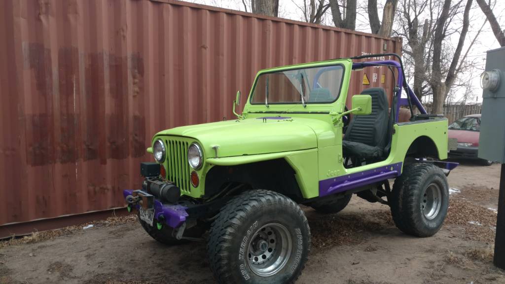

IMG_20161214_120626901.jpeg. Howdy fellow CJ owner. This is my 1981 CJ7 I agree with the other comments you have gotten. The frame can be a major rust issue. And the tub . Going on 3 summers ago I pulled mine apart. It had aluminum deck plate bolted down on rear fender wells. The previous owners idea of a fix. The entire fender well was rotted out above the tire where the rocks , gravel ,salt dirt and mud collect. Had to weld in replacement metal panels. I also turned tub upside-down and wired brushed the heck out of it then brushed and rolled on Hurculiner on entire tub, the fire wall and the did the entire inside of the tub as well. Turned out great and should help protect it alot. Good luck ! Got any questions you think I may be able to help with feel free to ask . Safe Jeeping best of all have fun and don't get discouraged. When I first bought mine a guy at 4wheel parts told me Jeep stands for just empty every pocket. He was not far off but I have owned mine for 6+ years and love it.
Sent from my XT1585 using Jeepz.com mobile app

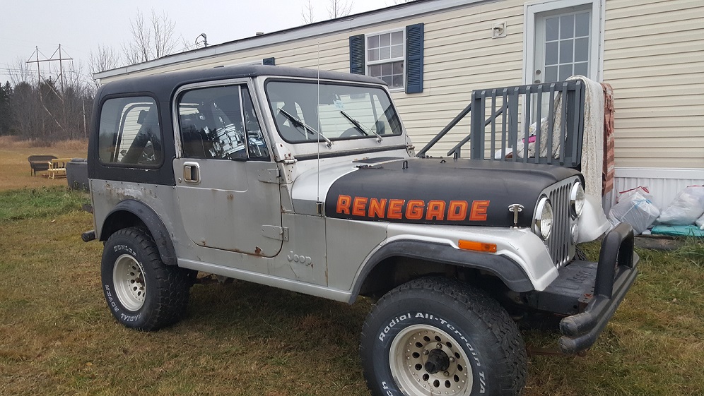

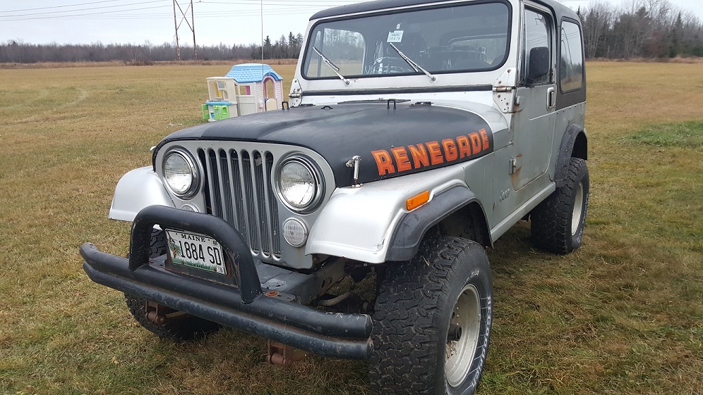

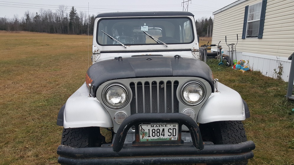

UPDATE:
The old girl took a new sticker!
Thank you all for your insight, I'll be doing some body mending when the weather gets a little better. I purchased a hard top which had the rear window in place (mine was missing) and am in the process of getting that all together. It was a harrowing ride bringing it home as I've never driven a Jeep with 32's and apparently I didn't have quite enough air in the tires.
I'll be doing some tuneup work and will be happy to post photos of the body work progress. Thanks again!
