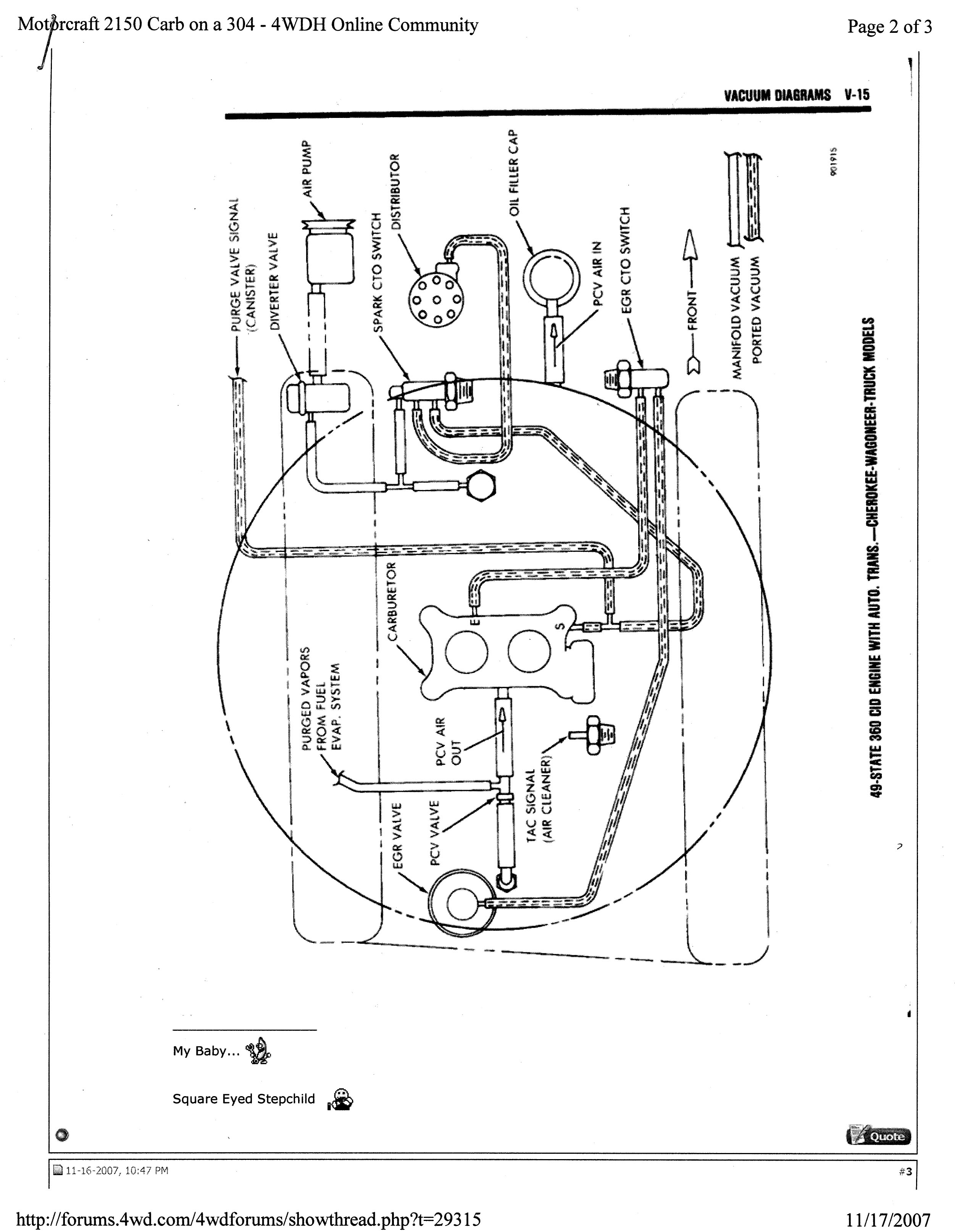

Smizar New member Jul 5, 2011 #1 Does anyone have a vacuum diagram for a 76 cj with a 304 they could post?
S Saddle Tramp New member Jul 6, 2011 #2 I've had this kicking around for a few years; may not be exact but should work. Attachments AMC V8 Vac Diagram.pdf AMC V8 Vac Diagram.pdf 326.1 KB · Views: 388

S Saddle Tramp New member Jul 8, 2011 #4 The last post was a PDF. Here is a JPEG Attachments AMC V8 Vac Diagram.jpg 857.8 KB · Views: 1,476 AMC V8 Vac Diagram.pdf AMC V8 Vac Diagram.pdf 326.1 KB · Views: 289
