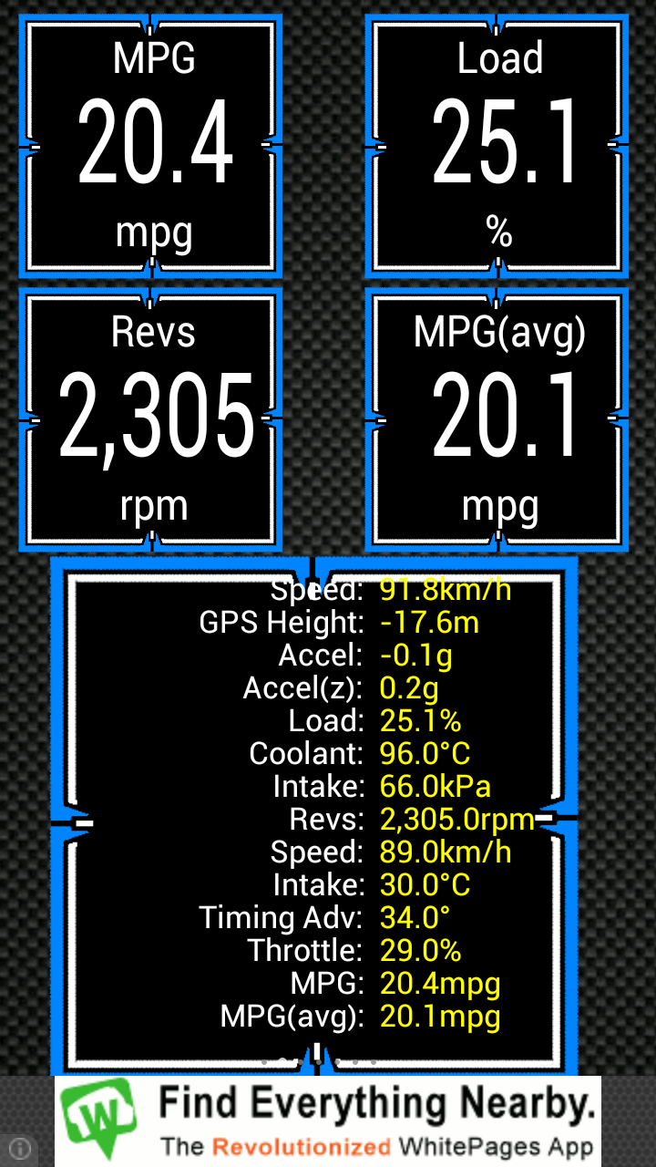

Played with the obd2 scan tool and the torque app on the drive to get my son from school probably 8miles total(still trying to figure it out)

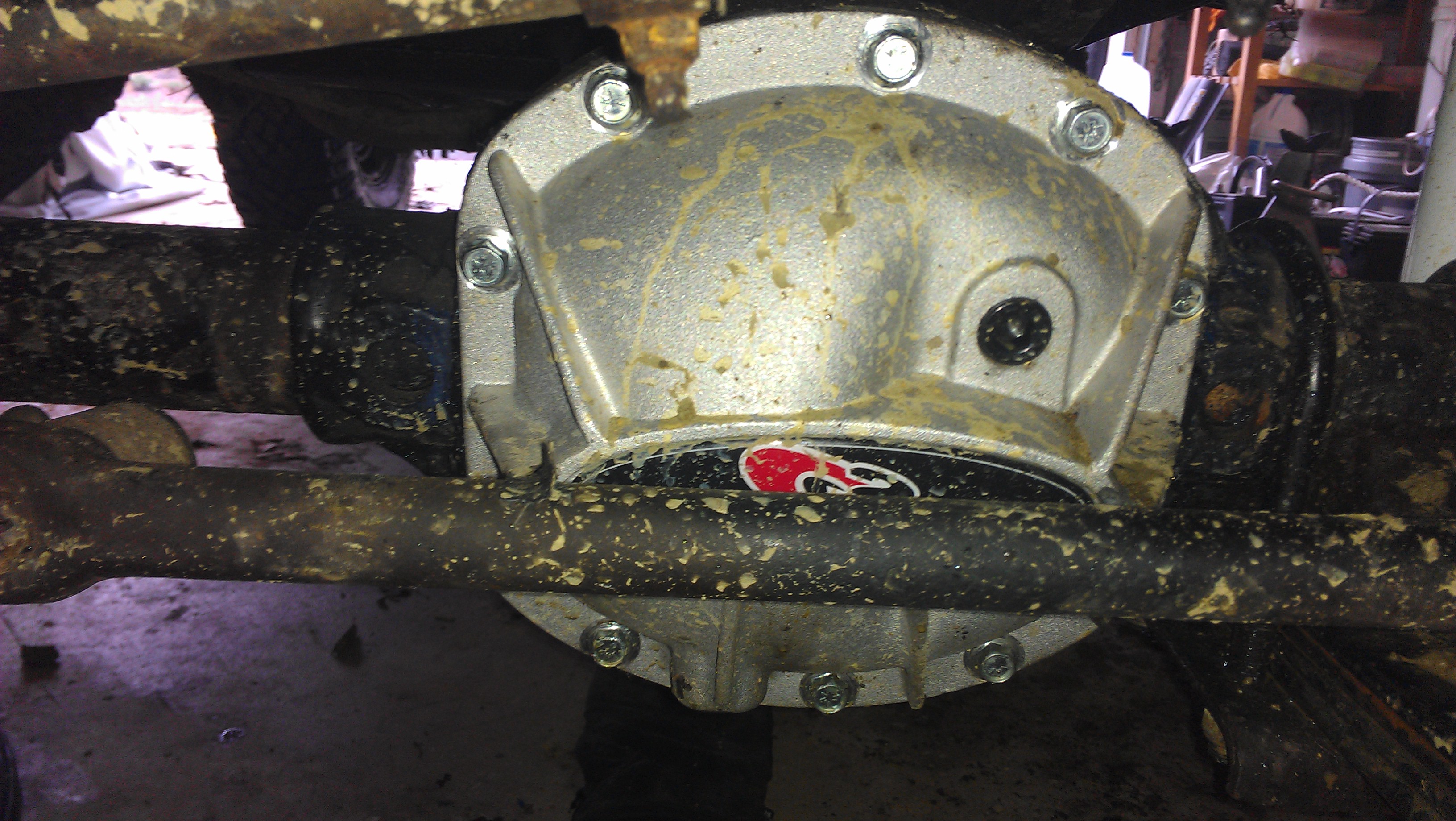

Installed Aussie front locker and G2 diff cover with drain plug

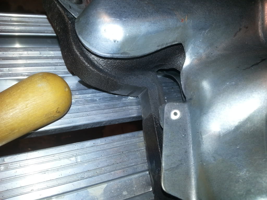

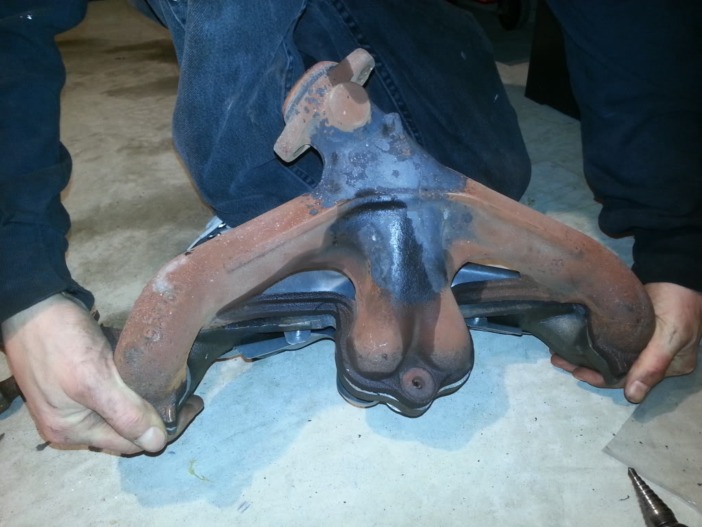

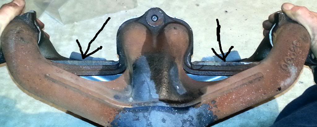

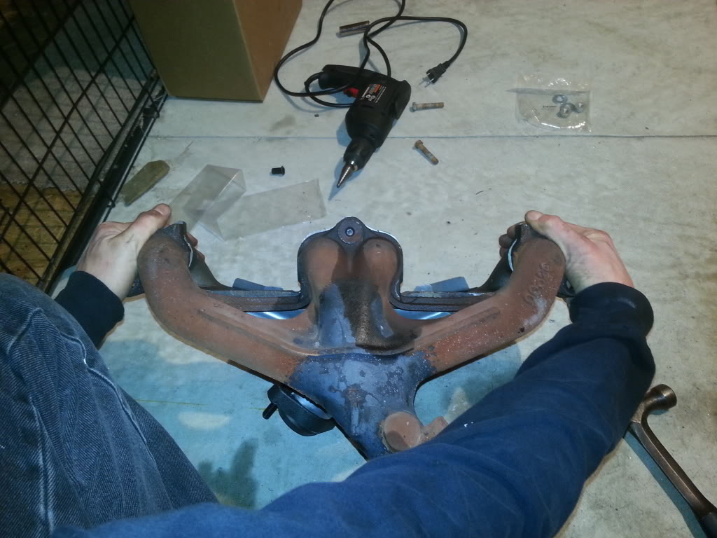

Started replacing the exhaust manifold and the dorman exhaust manifold doesn't fit for sh**
I had to file to get the bolts to thread in...
Then had to grind the flat bars between the tubes to make room for the intake to fit....
Look how much I needed to grind off to make it work...
