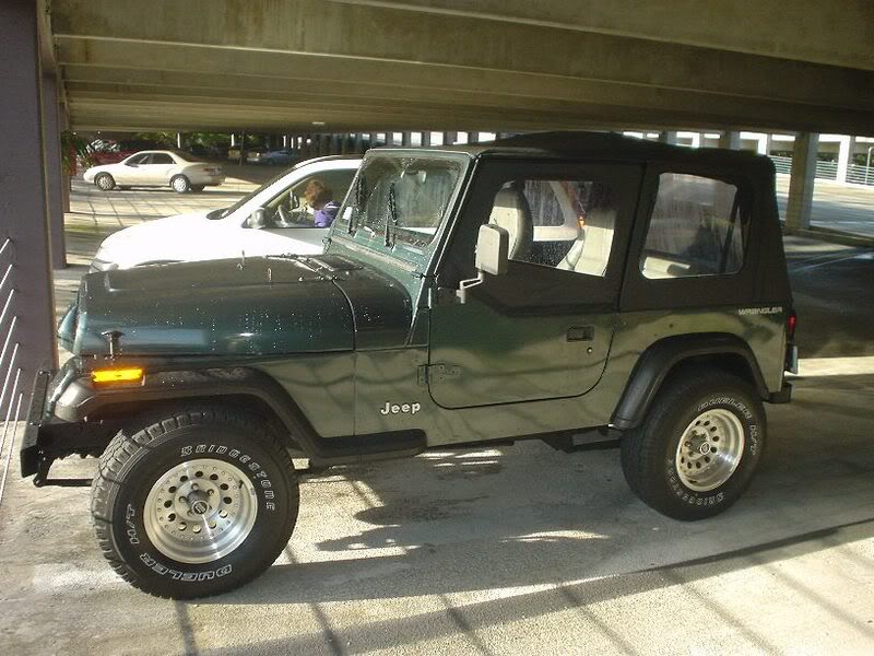

If you look on the inside part of the spokes on the rim, it will tell you the rim size (this is the first step before you purchase a new tire in my opinion); Now, I had my '94YJ with no lift on 15" wheels with 31" tires, and it did rub on the street (never took it offroad, but it would only have gotten worse). In fact, this is how much clearance you will have if you do go with 31" tires (and keep in mind, MT tires are acutally larger in diameter than the street tires you see here!):
See how little clearance there is? With MTR's you would have about 1/2 an inch less... Now, I should probably mention that my springs were sagging pretty bad (they were starting to show negative arch), but yours, being a '95, I would suspect are not in exactly the best shape either...
