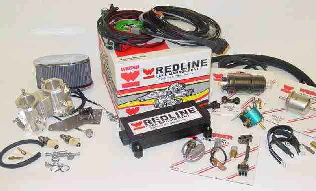

here is what you need:
A WEBER TBI set up. Its fully programmable through windows 98. You can buy "programs" that will set your motor to how you want to drive it for the moment. Say you need to pass inspection, just load that program and go pass. then change it "hot rod" and haul ass home and onto the trails. If i could afford it it would definitly be what Id go with.
If heard bad things about the Howell kits, and the other one, i forget what its called... Weber has a solid name in perfomance, I have a weber carb on my YJ and I love it.
check out http://www.cliffordperformance.com/Site04/Home.htm
If you go with a 4.0 head swap... use the 4.0 fuel injection, forget going aftermarket
