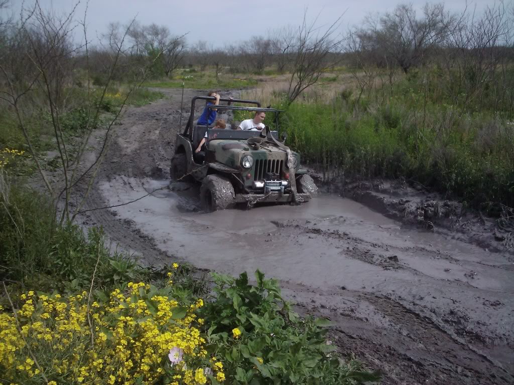

my buddy jared has a 53 jeep. i don;t know which one that is but his is a blast. his dad, him, and his uncle all have older 50s model jeeps because they own a restoration parts business. other then the cost of some parts, his is very cheap to own. his is totally an off road vehicle with tractor tires and bare nothing in it but it runs great and has never gotten stuck anywhere. he goes through mud that slops over the door sill and the jeep just keeps going. its got whatever that old school 4 cylinder is and transmission and is a great little jeep.
here is his
