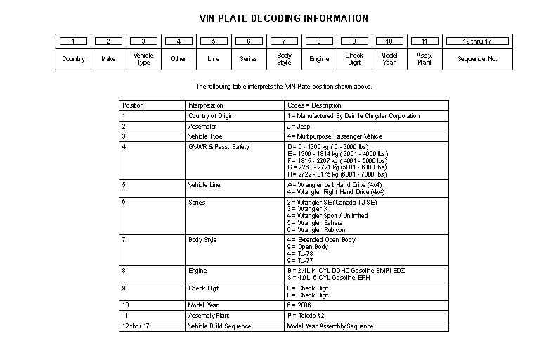

lookin to replace brake pads and rotors.rock auto does not list the unlimited 2 door model just unlimited rubicon and wrangler which i dont have. so i was curious if the same parts that fit wrangler would fit my jeep.
got me confused 06 unlimited is a 2door my mind set is 4door....
search for part number on line, or call rock and let them suggest part numbers so a mistake will not cost you...
I strongly suggest a local parts supplier to eliminate this wait and chance selection BS.
Your having to pick part numbers - you may own it fit or not ......
Attached OEM info

The 04-06 unlimited is more like the 04-06 unlimited rubicon. The big difference is front axel and springs for the most part.
The 04-06 unlimited and unlimited rubicon are disc brakes all the way around. The parking brake is inside the rear disk brakes.
