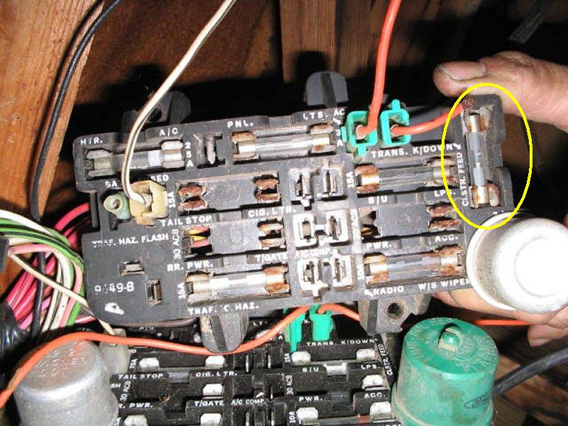

My question, where IS the fuse on this '78? The wiring diagram makes no clear reference to it.

If I remember right(and that is never a sure thing) there is a fuse marked turn signal in the fuse block on the drivers side firewall.
By the TSM this photo represents what my fuse panel looks like (note the labels)

This one has a stubby GM tilt column that I've yet to go through. The LED indicator bulbs are in the Speedometer shell, the lights themselves are incandescent. It turned out despite functioning for a couple of months the standard relay failed, so got an EL-12 HD relay and they started working again. Now it's on to the port side rocker bridges.
