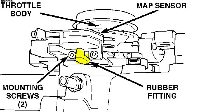

Lets try KOEO the map plugged in - probe the DK/RD (center) wire - what is voltage?
thn engine at idle what is voltage?
Chec the rubber vacuum connector.
FYI a skewed MAP reading will affect ign timing.
oops wrong picture above the tests are the same

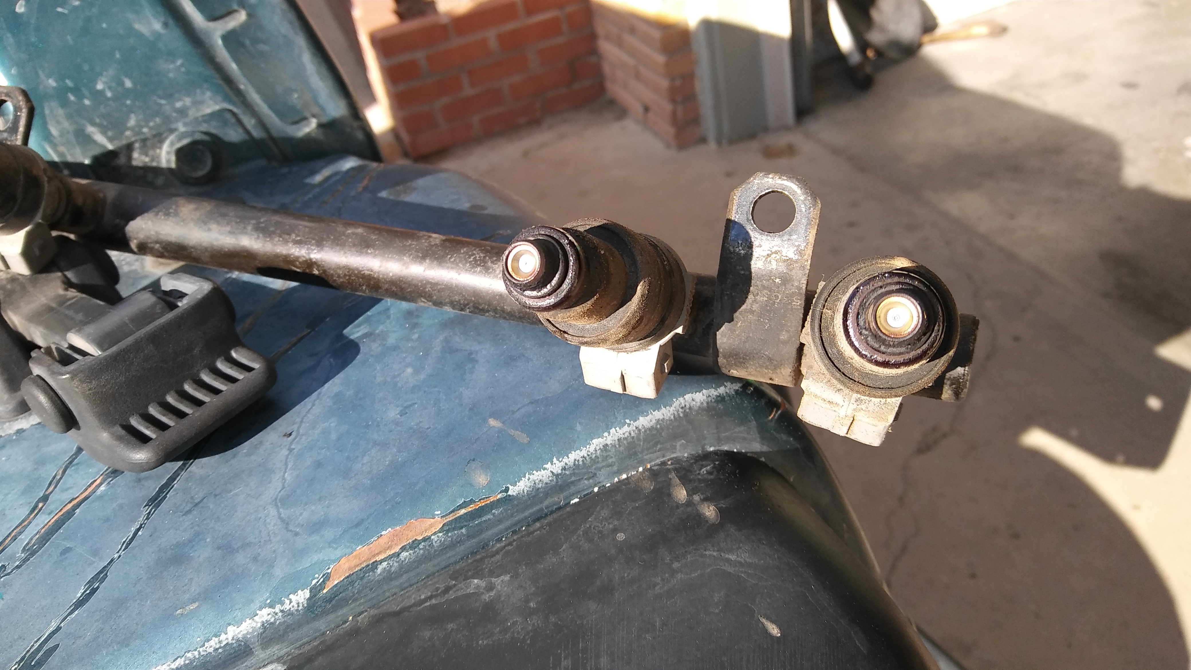

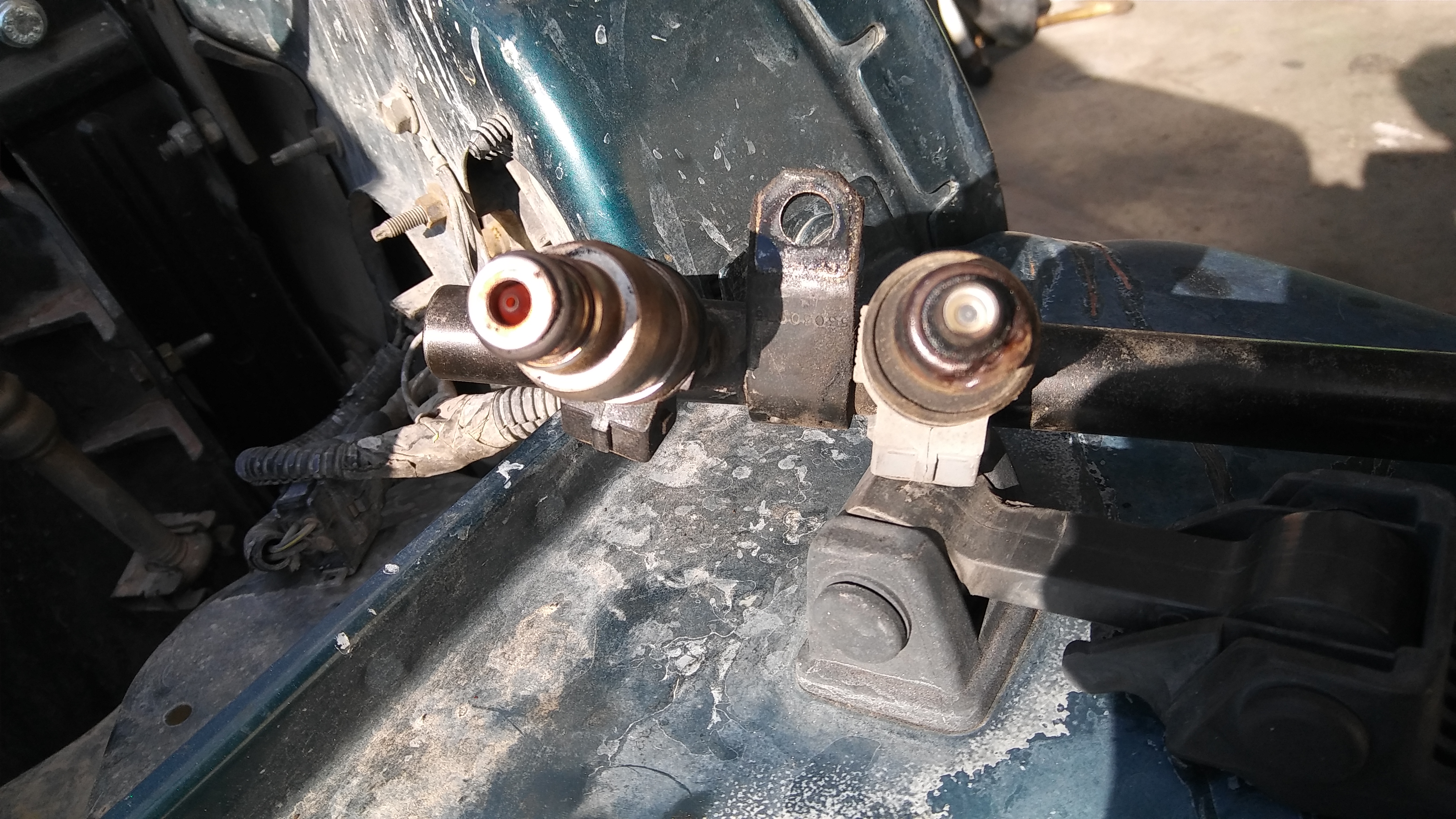

So I pulled off the fuel rail (I'm right there anyway, what harm can it do?)
This is what I saw. The one on the left of the first image is #1, and the other 3 look the same. They're also different on the outside.
Something seems off about that #1 injector.
Edit: But it's totally not causing the lack of compression. I'm talking like 40psi in cyl #1 and 110 everywhere else. I don't have air to do a leakdown. But I swapped that injector over to #2, and #1 still had crappy compression, and #2 still had great compression.
Are there o-ring gaskets on injector 1?
It can be a stuck open or struck closed injector. Swap injectors in the rail and see if the problem follows the injector. If it does clean or replace the injector. I had one stuck on a Honda and it would load the cylinder making it impossible to start. Hold the pedal to the floor when starting and it would shut off the fuel pump allowing the fuel to clear the cylinder. Then run lots of injector cleaner.
Do a wet compression test. That is run it dry and record the number. Then pour in some transmission fluid into the cylinder with low compression. Retest. If the compression comes up near normal the rings are leaking. If not it may be the gasket or a valve. But be sure the injector has the or both o-rings.
PS From the factory good compression is 120-150 in each. Delta of 30 is bad. I've seen readings as high as 190 after 8 good revolutions.
PPS the leak under the water pump is the water pump. With it leaking you must be adding water. If
