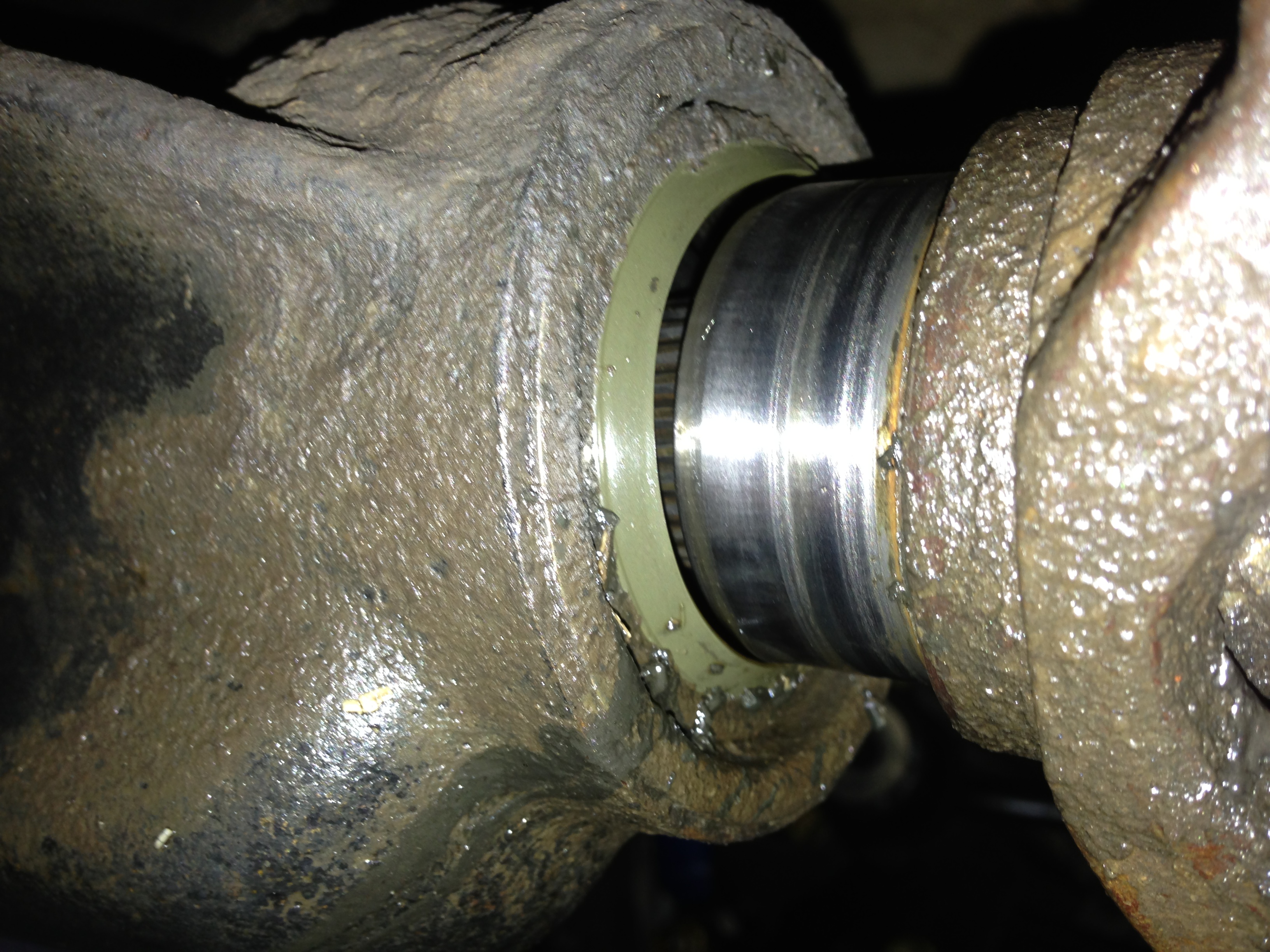

When you pull the drive shaft off , feel for excessive play and any harsh movement in the t-case . We still don't know if the t-case has a problem that may have developed from the sloppy movement of the ring and pinion. You certainly must remove the rear inspection cover from the rear axle . I don't want to say what to expect as I don't like the sound of things now. Please post your findings , pics and lets hope for the best but for now , gather prices for replacement parts to be prepared . Best of luck . Greg
Brother in law here. Thanks for your replies. I drove 2 miles one way with no previous oil leak or noise. I almost didn't make it the 2 miles back home. Every time I would stop I would hear a loud knocking noise and the Jeep would stop and sometimes kick back in reverse a hair. Only a couple of drops of oil since I got back Mon. This looks like way more than the "play" I have seen in youtube videos.
So in the photo you posted, did you remove the locknut/retainer from the yoke and pull the yoke off a bit to take the photo or is that how much play you had by just moving the driveshaft out of the way? Regardless, your going to need to remove the diff cover and take a look inside. If my orginial suspisions are correct and you damaged one (likely both) pinion bearings, it's not a easy fix. Not sure of your ablities (nor doubting them), but you're going to need some specialty tools and a fair amount of labor to replace the bearings and anything else that was damaged or will become damaged during the rebuild process. If this is something you're not geared up for or have the mechinical bearings (yes those are puns!!!), you may want to have a shop do the work.
No ability here at all. I removed nothing. That's all the play that was there. The guy I bought it from said he has a Jeep that was in a fire but the tires are still in good shape and he could get the axle for me. He is a small used car dealer. I just hate to replace the axle and have it happen again. What makes a front bearing fail? I am not a mud guy and the Jeep is used to run around town in. It does have a 4 inch lift and 35's on it. No warning at all. I have only owned it for a month. Is this a $500 fix? $1000? $2000? Thanks again for your reply!
Bearing failure in a differential can occur for as many reason as the day is long. Mositure, debris (both from water crossings), lack of gear oil (leak), extreme heat or cold (not likely), defect in material, slight misalignment during build up and list goes on.
If you can find a desent used axle, that is probably the most cost effiective opition. But again you'd going on what someone else is telling you. I would at least inspect it by opening the cover and having a look. The carrier and ring, the pinion and thier related bearings will have no play that you can detect by hand (they have preloads and endplay but you should not see any play by hand other than rotational). The oil inside can be in any conidition without the presumpion of being bad, you just don't want a milky mix, particules of metal or foam in the gear oil.
Having a competant shop do the work will be costly (sometimes finding a shop that will do it is tough). The cost could be anywhere from $500 on up depending on what all is needed. Just keep in mind that at some point it can replace the axle with an aftermarket upgrade when the repair cost start to get pricey.
I am in complete agreeance with policemonkey161's post . I just could not believe the way the front bearing failed to this magnitude ! It took the rear bearing with it and Lord only knows what misalignment of the pinion to ring caused in the way of damage ! Well , we're looking at a disassembly for sure to find out what got trashed besides the two bearings. Quite honestly . I have never seen a failure to this degree . This may be common in extreme off-road and seen occasionally , but I have not been around jeeps or trucks that goes EXTREME off-road for sometime and have never seen this kind of failure in a auto or light truck either. Have heard the noise or felt the binding or clunking of a bad rear or results of failure , but I believe that someone had recently changed an oil seal on this rear axle and went overboard on the torque with a HEAVY setting on the impact used to install the pinion nut and did NOT preload the nut AFTER initial torque is applied and reached upon reinstalling companion flange , washer and pinion nut .
To sum it up , someone done messed up royally ! From the picture , even with all that oil and dirt , you can see that the seal is fairly new as the seal surface is even all around and has pretty much all its original integrity on the sealing surface. Shame , its got to come out with all the othe parts and a new one tapped in. No matter how good it looks , I wouldn't try to keep costs down if a rebuild will be performed. That seal is the cheapest part of that rebuild. But I got to agree with policemonkey161 again , if you can get that rear from the salvage jeep you mentioned , and its good ( you really should inspect it too ! ) , I'd say go for it . Double check all items for reinstalation like brake lines for example . Shame another jeep caught fire , hate to see jeeps die, but your jeep will live on through donated parts . Even jeeps can be a donor , look at that !

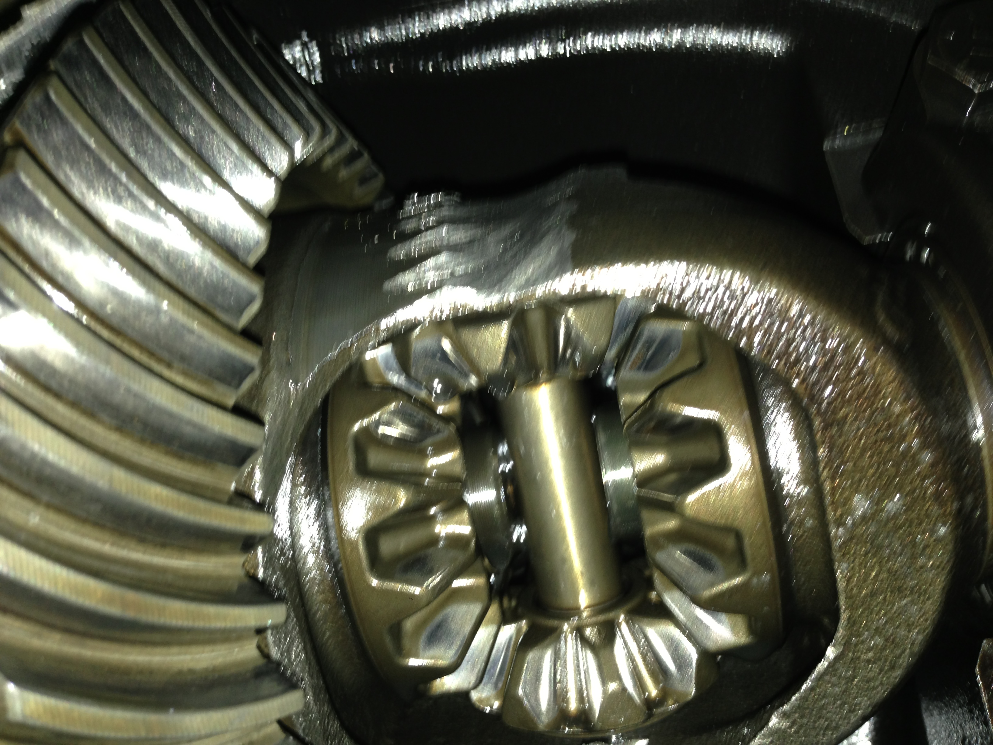

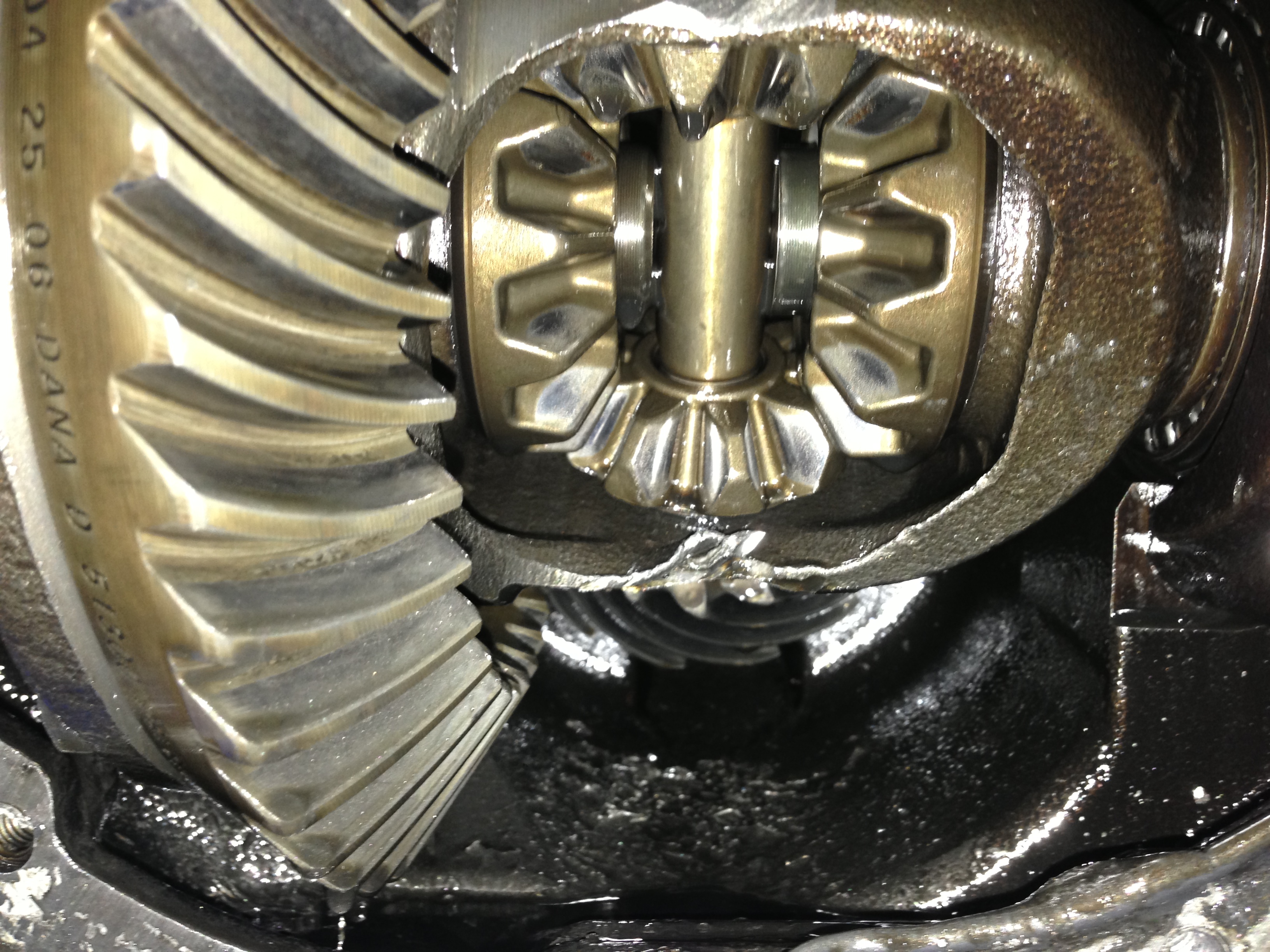

Opened her up and his is what I found... Dana 35 gear ratio is 3.07 tires are actually LT285/70R17 121/1180 so I think they are 32's? 33's? The lift seems to be 4 inches unsure how to confirm. I just want to keep this from happening in the future. Thoughts? The seal on the diff cover seemed freshly sealed. Keep in mind I don't know what I am talking about. Thanks again for everyone's help.
This is classic , someone either did not know or did not care what they were doing. Regardless , the easiest fix is a rear end swap . Hoping the next axle will work out better . And you'll get to bleed out the rear brakes in the process . That's a good thing . Best of luck , Greg
