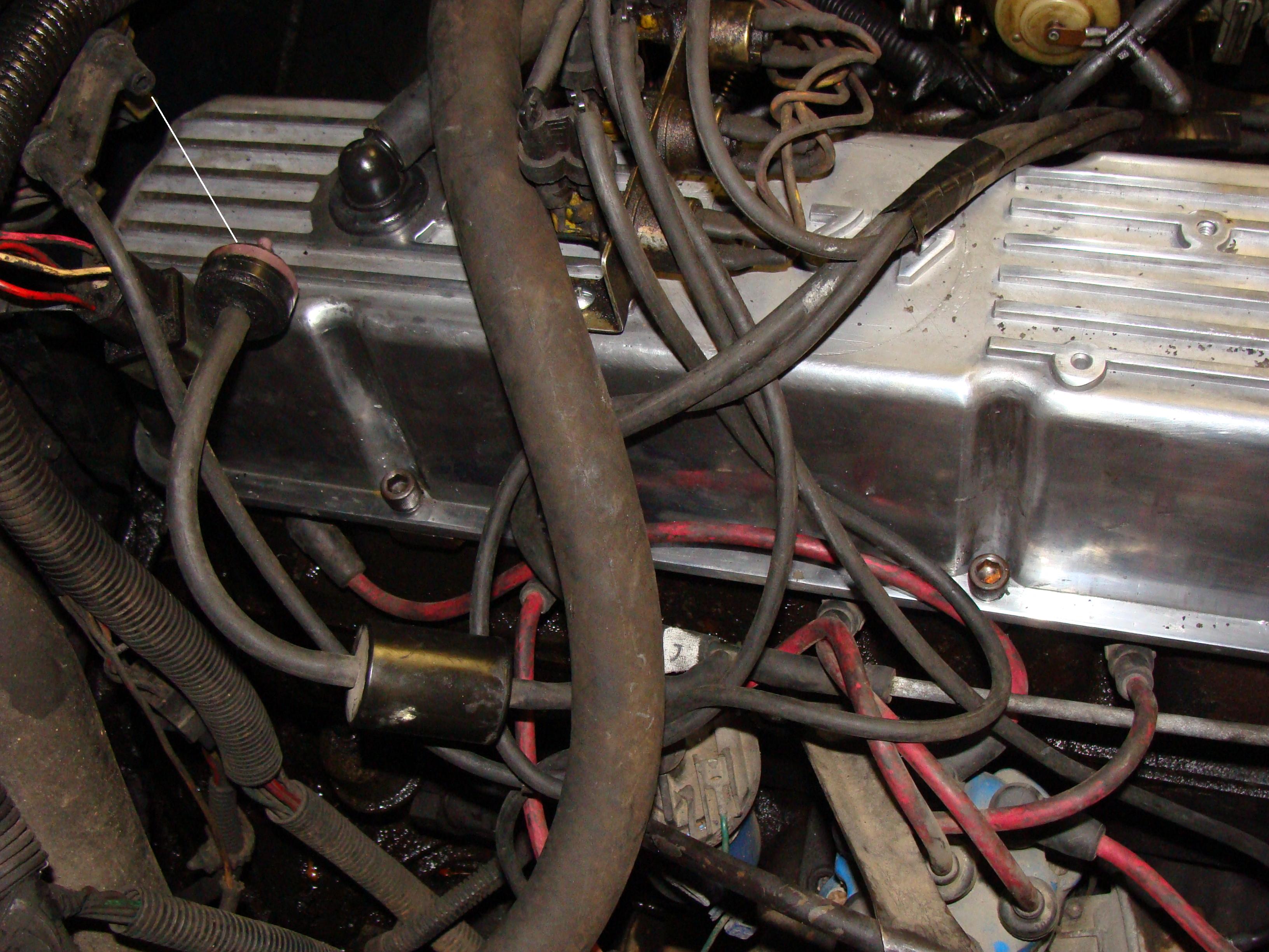

Well, I found the problem. If you look at the photo, in the upper left part of the picture there is a hose that was connected to the port coming out of the firewall. I have drawn a white line to where it was connected. As soon as I disconnected this hose, the engine immediately smoothed out. Now the question is...where does this hose go?
Any suggestions?

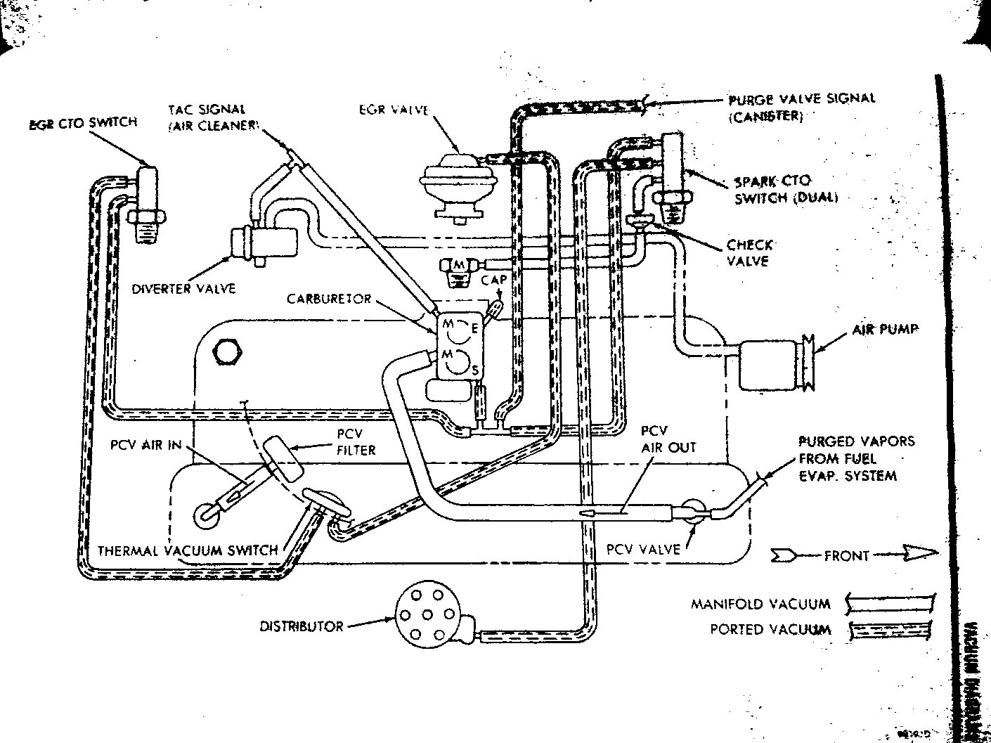

Would this help?

Now this makes sense to me! Thanks for sending this...you guys are awesome.
