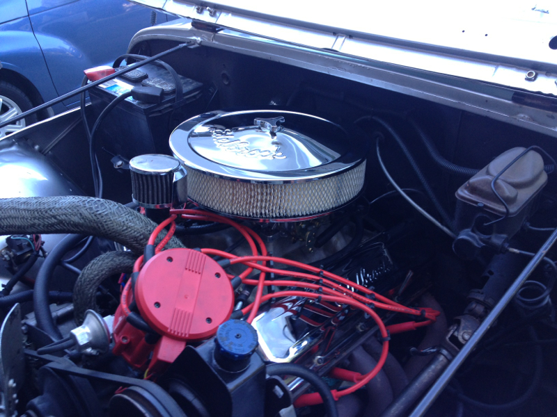

Here she is all prettied up!
Nice picture! Looks like mine :)
I know right, but to get to that point, I had gotten a new carb, timing set, and HEI. Things I wanted to do eventually, cuz I did get performance part, just didn't think I would be making that many purchases this soon. But it is a CJ
Your engine looks great. I need to switch to HEI, I keep saying that and never do.
