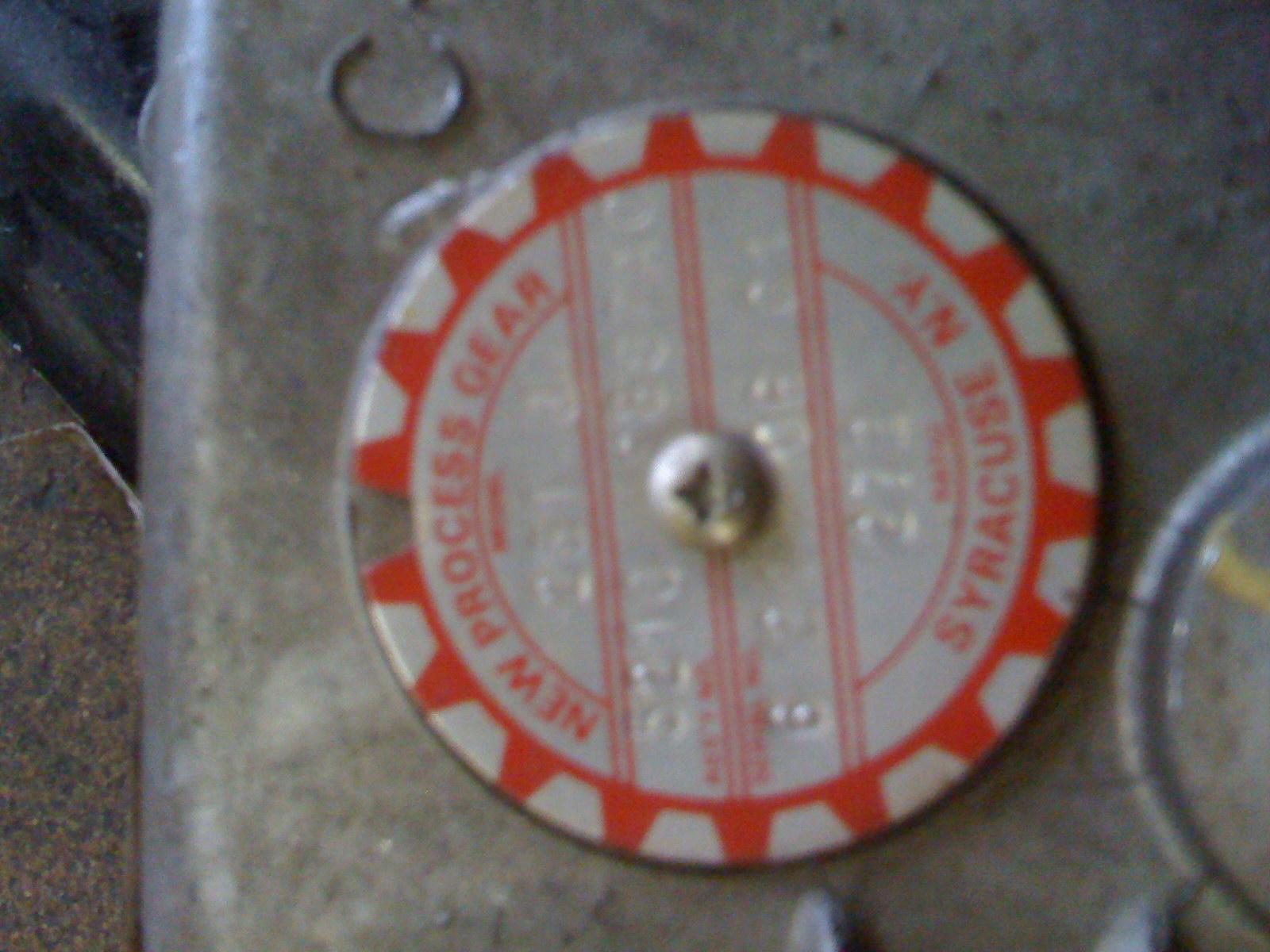

I have not looked at the tag, but I'm assuming it is a 231. It is a 1993 yj, I6, 5sp. Thanks

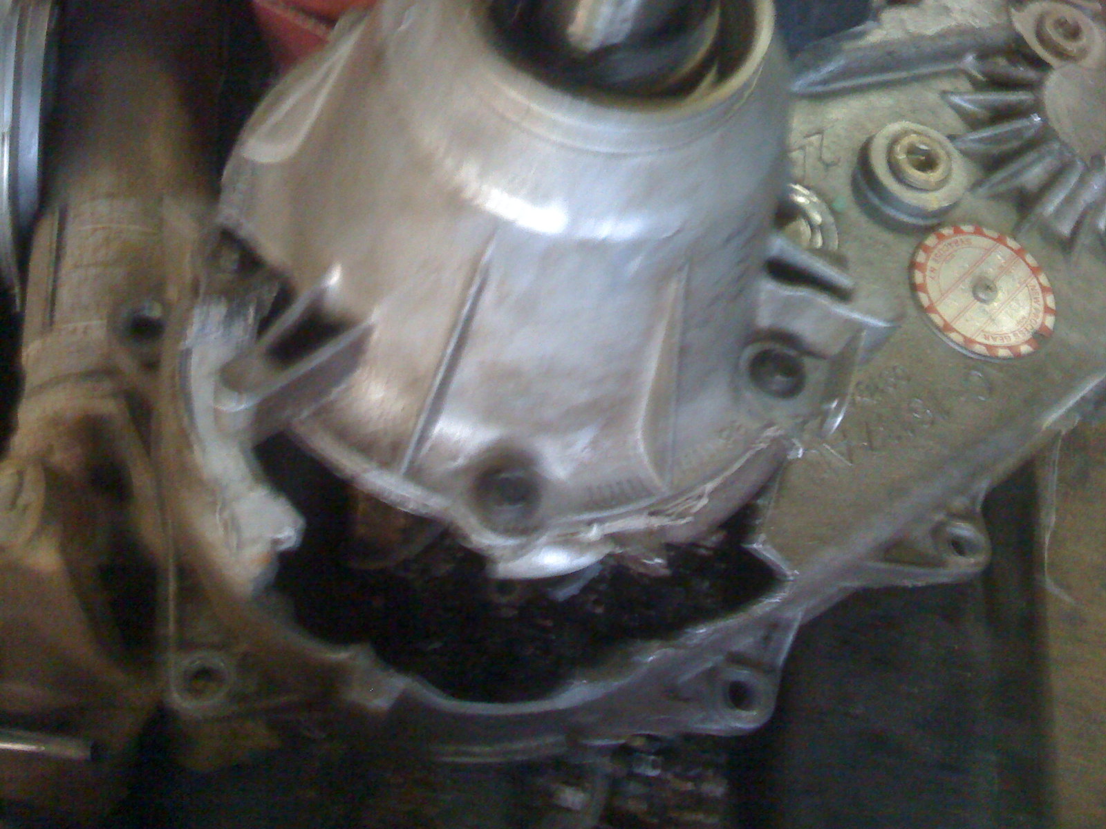

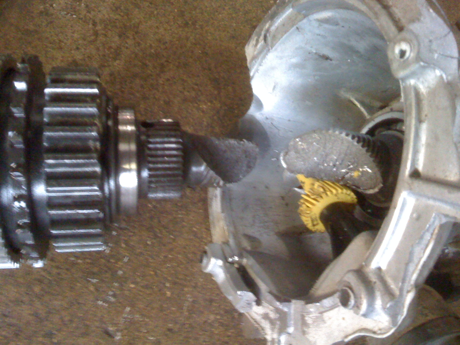

This is a 272 with a broken output shaft. place all 4 tires off the ground, engage the T.Case on 4WD. Engine not running. If the Trans. is a Manual, place it in First Gear. Turn the rear driveshaft by hand and see if the rear tires turns. if it does and the front isn't turning, then i would look inside the T.Case for the problem. it's likely that the out put shaft is broken in 2 pieces. if the front drive shaft turns while turning the rear driveshaft by hand and the rear wheels are not moving, then check the rear axle..

It's a 231 and rebuilding is relatively easy. I have all the parts you may need. Where are you located?
