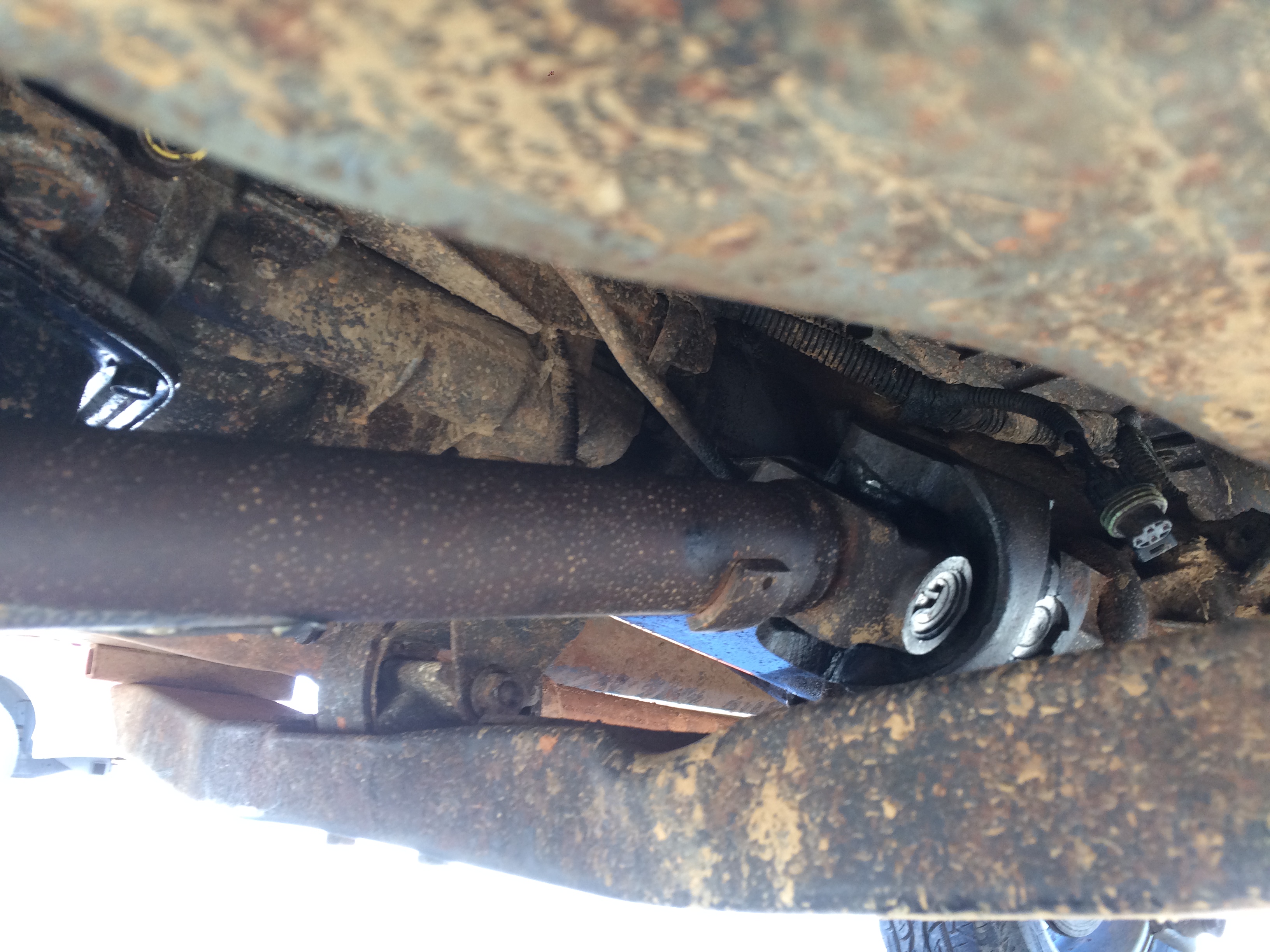

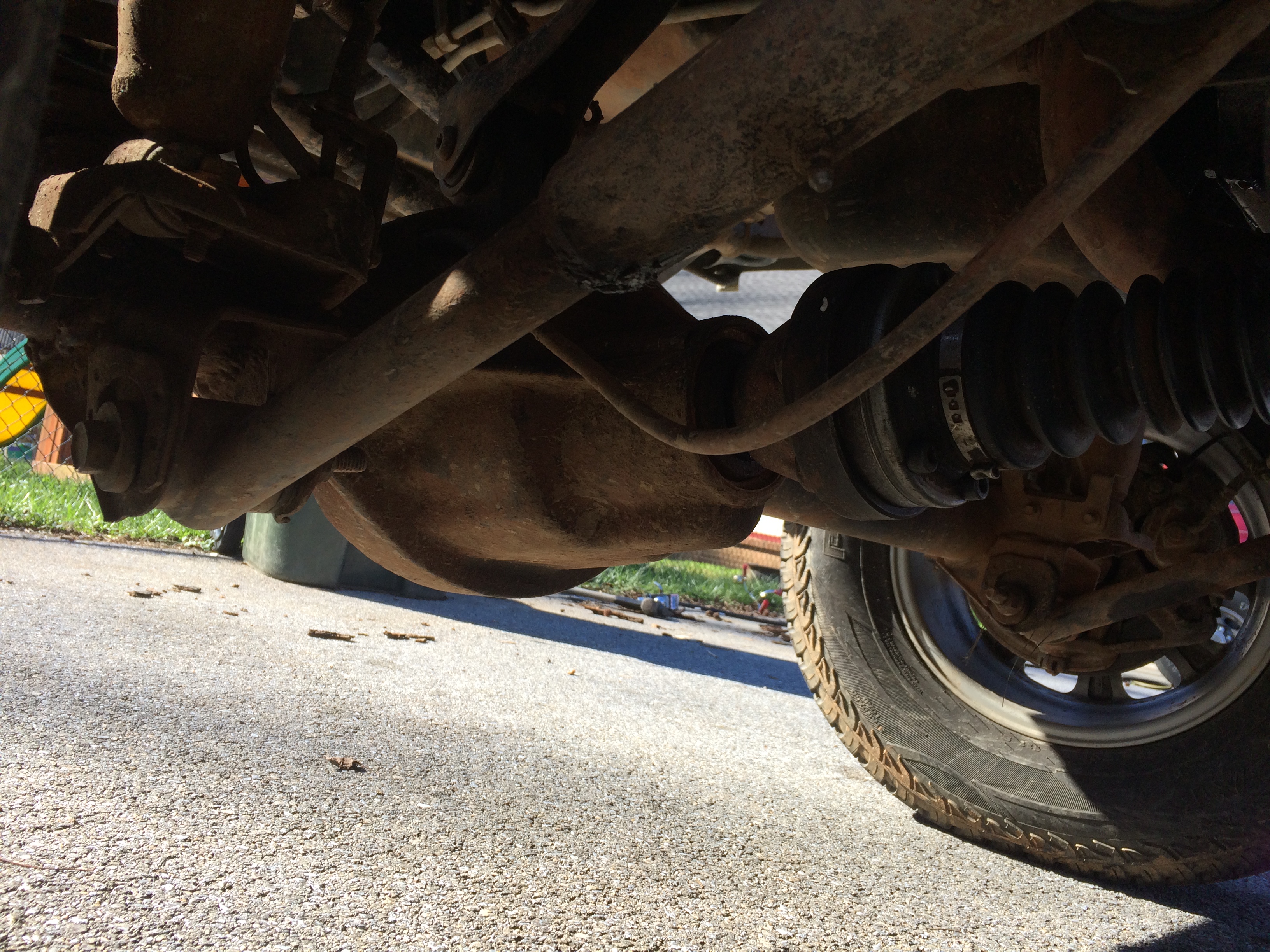

Welcome to Jeepz.com. Post some photos of your front driveshaft, and it's angles.
I should've posted those pics earlier. But I don't think the angle to the front chunk is a problem. I plan on draining the chunk and inspecting it this week to see the bearings.
Photo is at a poor angle but looks like front pinion is a little too low. Might consider replacing the CV joint at the pinion with a standard ujoint.
