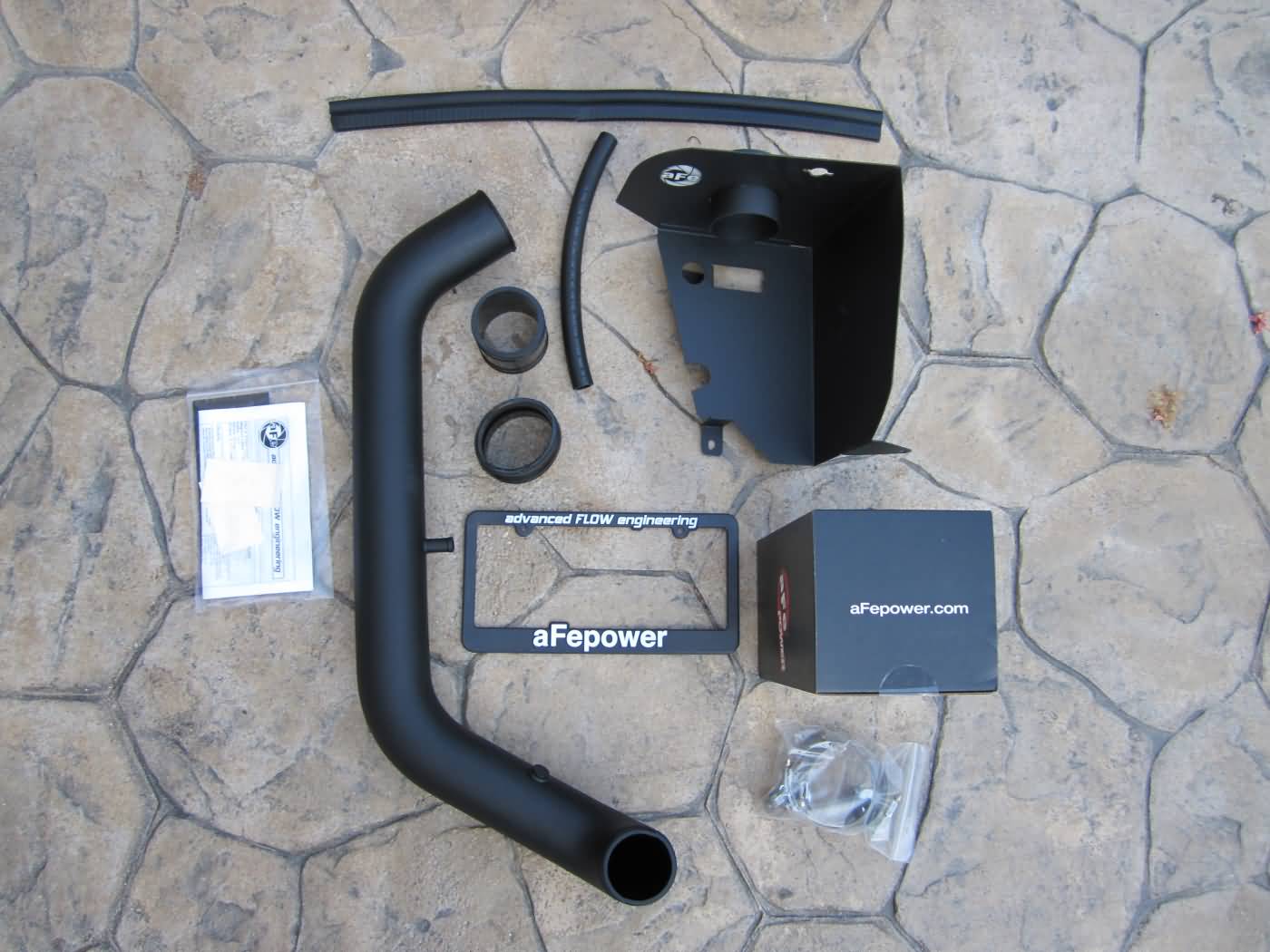

Once I pulled everything out of the box and laid it out I was fairly pleased. The kit is complete, and even included three window stickers and a license plate frame - so other drivers would know how fast I was ;-)

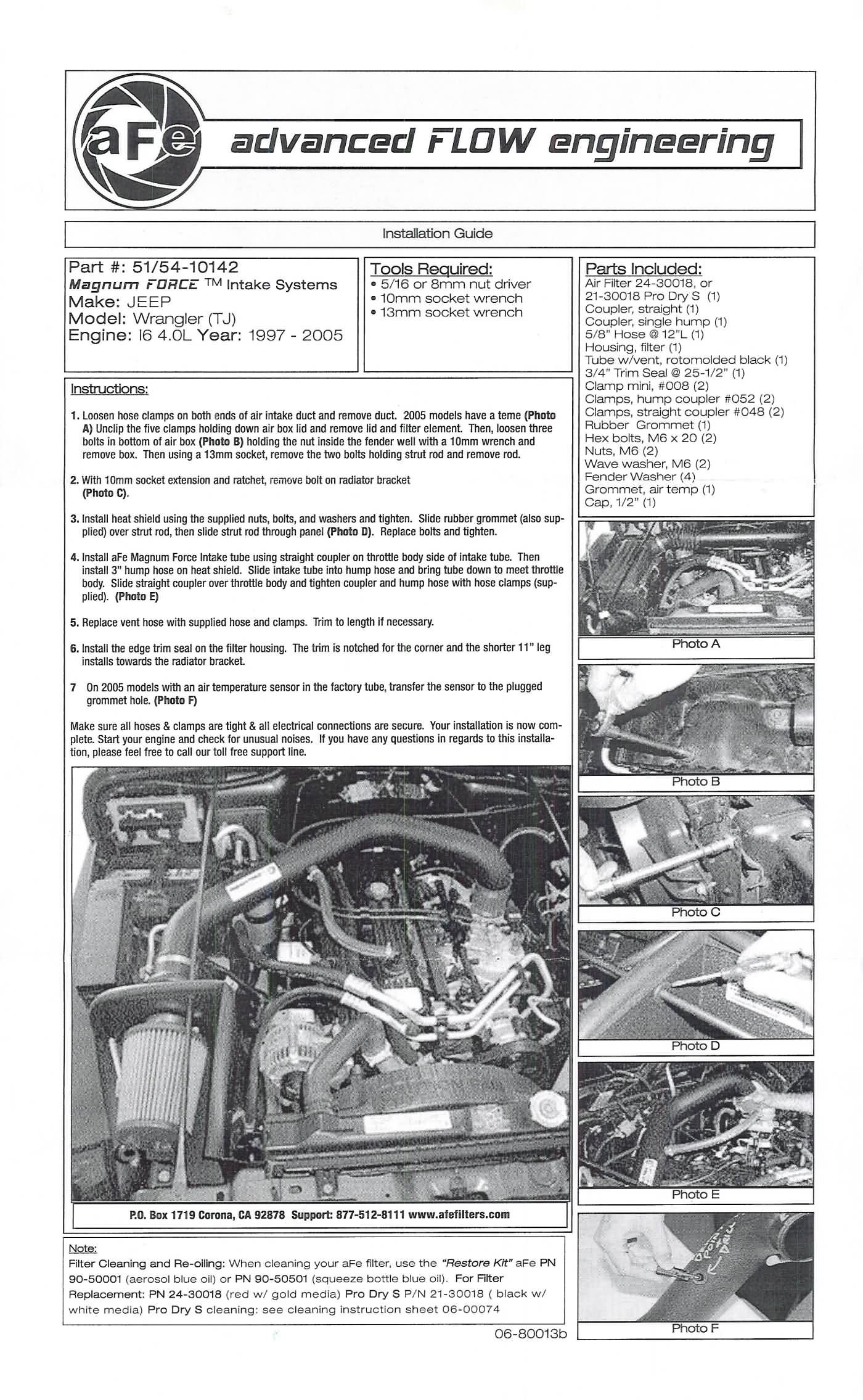

The instructions were well thought out and made installing the kit a breeze. You can see my full install here.

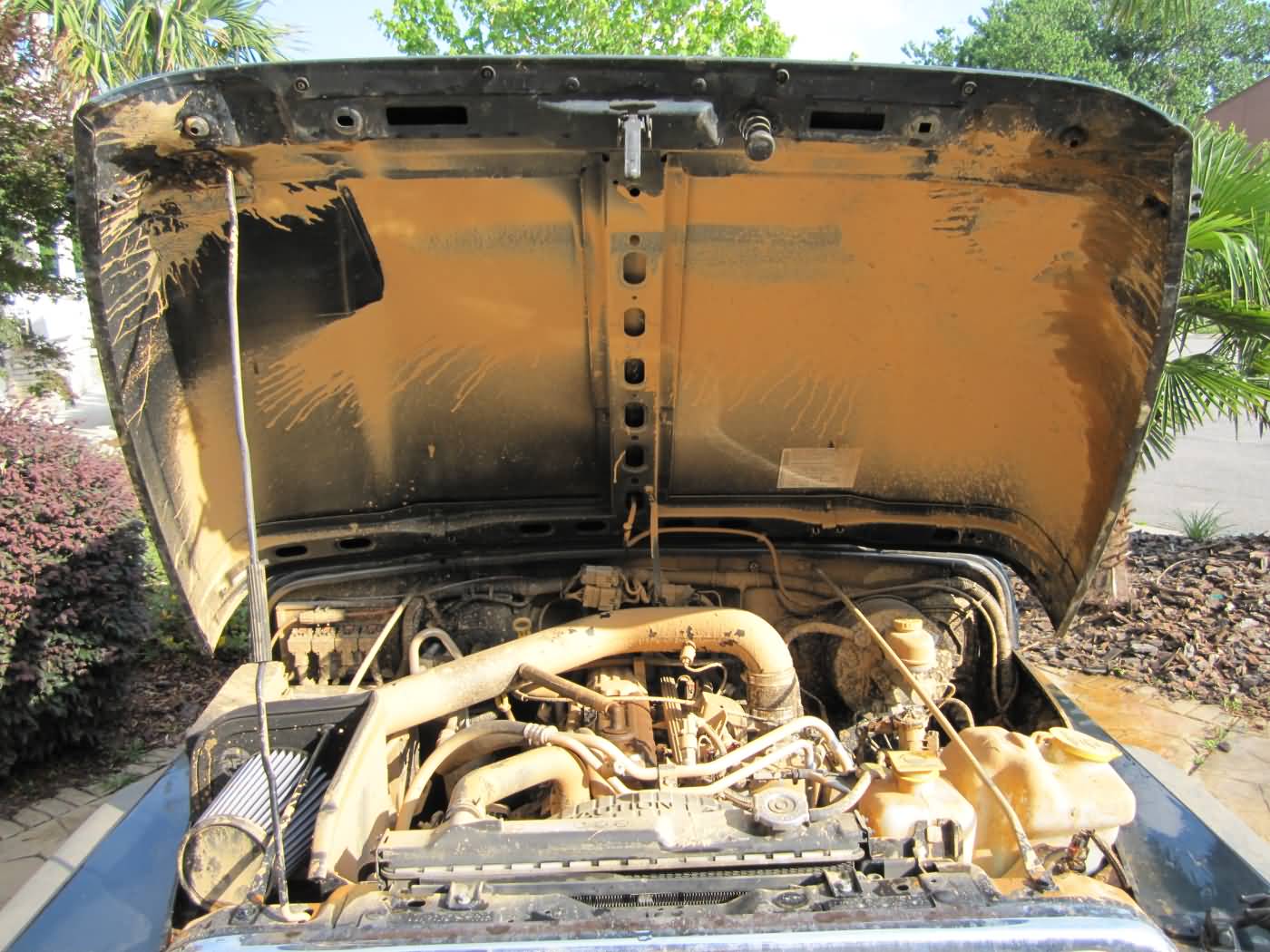

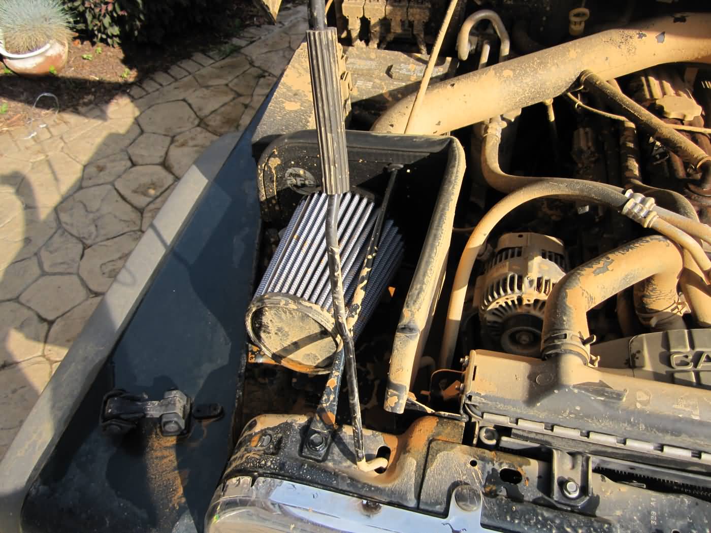

aFe intake after a mudding trip
Here are shots of my intake after a trip out on the trails. As you can see it did a fairly good job of keeping mud off of the filter and out of the engine.
