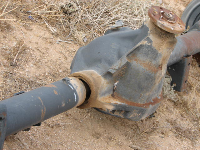

I'll be drilling out the plugs and welding the tubes in. (last time broke on the opposite side) so maybe ONE can be had of the two.

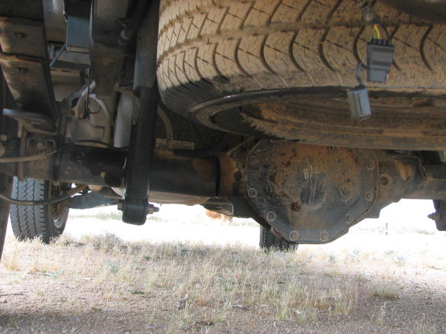

Check out the broken axles

Yeah, Mikey, trusses and gussets is what we're thinking here too. We were thinking of removing the tube from busted housing #1 driver side and installing it on busted housing #2 as they busted on different sides. Theres two plugs holding them in. If it don't work I'll have to buy another housing like before.

after you re-tube, weld the tube to the cast housing with some nickle rod and maybe a simple truss will help with the axle deflection. did it also eat the shaft?
It's back together now, it should be OK until I can get a housing. Out of the three trucks I own, the Nissan busted one at about 65K and this Dodge busted two. They seem to last on the Dodge about 100K. The problem is that this Dodge has 240K+ on the motor and I'm wondering when is it time to say OK I think I MAY of gotten my money's worth out of this one. Or is it time to get the axle housing gusset and truss the dog do out of it, put another 4.7L on it and drive it another couple hundred K. I am at this crossroad now.
