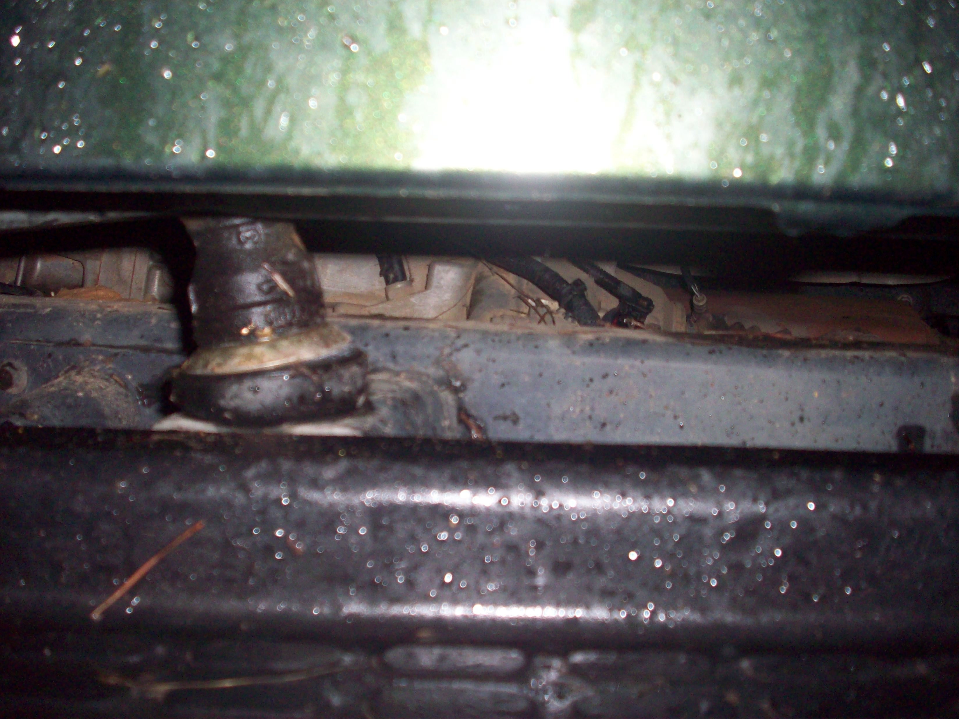

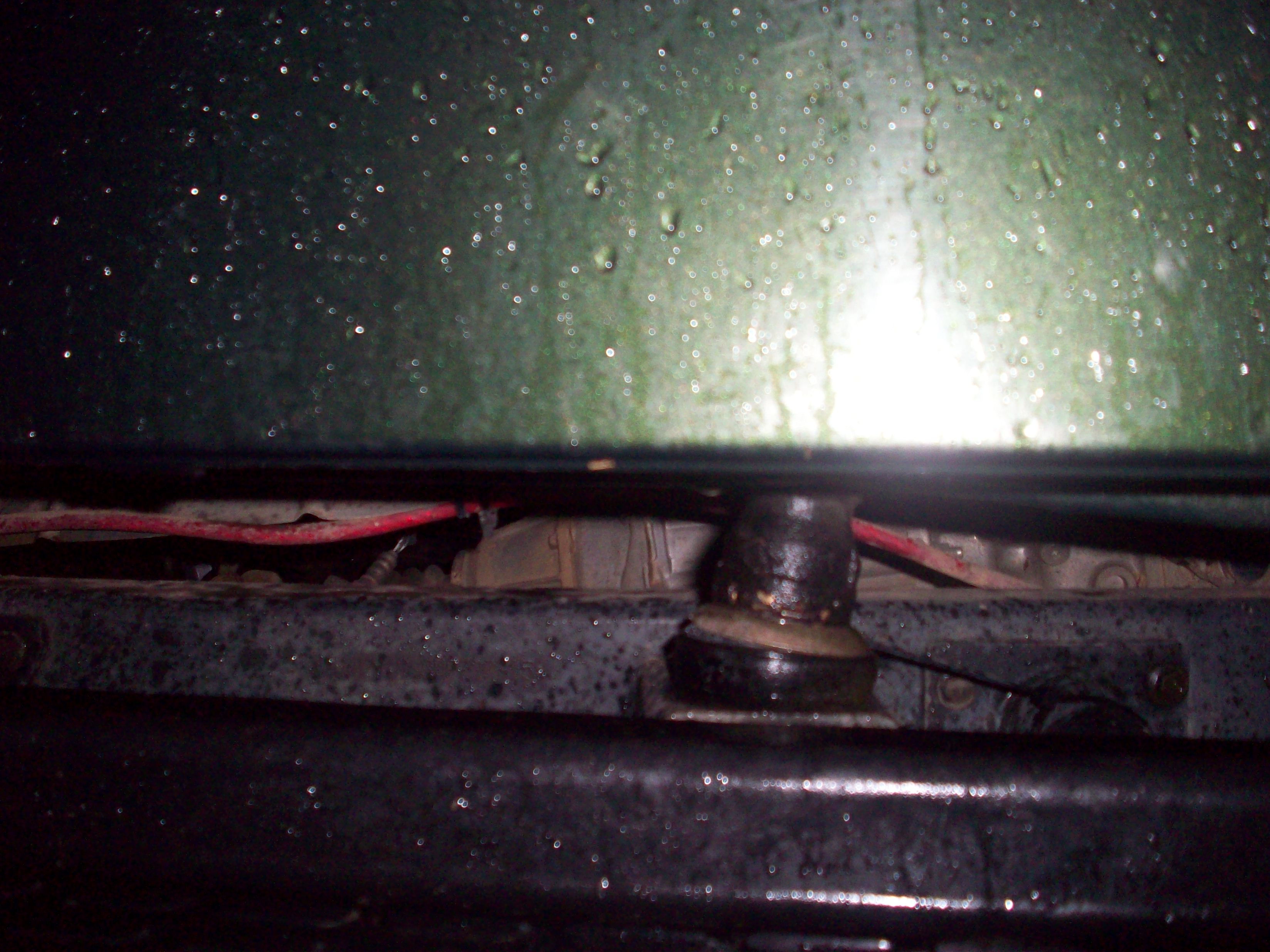

A body lift just jacks the tub up off of the frame using spacers with a long bolt through the center. The downside of a body lift is that the taller you go, the more stress is placed on the bolts connecting the frame to the body. It may seem fine when you install it, but a 3" lift can sheer off these bolts if you ever get rear ended, hit a curb, or even slam on the brakes.

This is what happens when you have a body lift and have a minor wreck.....
Yeah well all I got say about body lifts is that they're a piece of crap! My jeep has a 2" body lift on it right now from the previous owner being a cheapass. But anyways long story short my jeep leans to one side now because i took a somewhat sharp curve one morning and heard the passenger side start to give way. The bolts through the body lifts were breaking under the stress of going around a curve and now 2 on the passenger side are missing must've fell out going down the road. So yeah definitely go with suspension lift, its both stronger and safer in the long run
