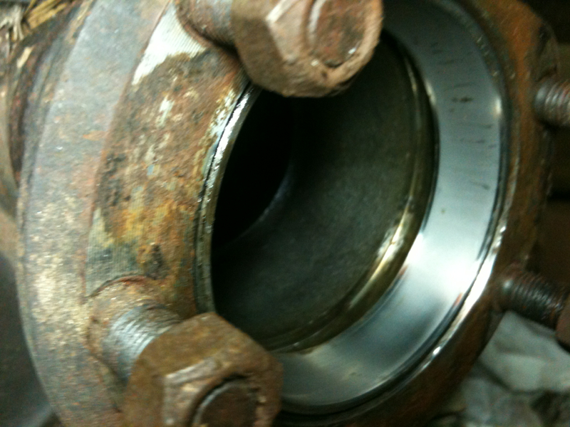

Dana 44 bearing split and stuck in housing.
joejeepny
Hi everyone at Jeepz. Has anyone ever seen this before. The bearing split and is stuck in the 44 housing. How do you get it out. Any ideas appreciated.

A slide hammer with a claw on the end should do the trick. The race doesn't take a lot of force to put in so it shouldn't be to hard to pull out. Not sure what you meant by the bearing split. Is the race cracked or did the bearing come apart?

How does the claw work. Does it spread some how or do you work it along around the edge?
Oh , I see one online. You could attach three claws.
I take it the bearing is on the axle shaft where it should be and the race is in the housing as it should be so where's the split? There supposed to come apart right?
Yes they come apart. The bearing is pressed onto the axle shaft and the race goes into the axle housing. If you look at your axle shaft there should be a seal there between the bearing and the retaining plate. The seal keeps the oil in your axle, the oil is what lubricates the bearing.

For what is worth, check to see if your old bearing race is square (seated evenly in axle housing flange) before you attempt to use a slide hammer to remove it. It may just be the angle of the picture you took, but it looks cocked (I said "Cocked" :rofl:.....) on the left of the photo. Removing it will be hard and may score the inside on the race seat without re-seating it squarely first. Just something to consider?????

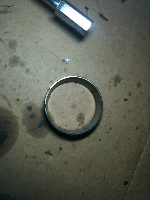

Yup it was cocked. Took some time to get it out carefully. It must have took a hard shot to get like that and start leaking. Shafts don't look bent but I am starting to think I should have spent the money for moly shafts .

Yup it was cocked alright. It must have taken a tough shot to get like that. May e thats why it started leaking. The shafts don't seem bent but I am starting to think I should have sprung for new moly axles.
