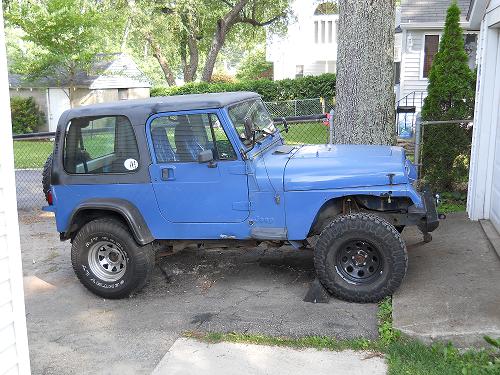

Saw my Buddy today with the YJ (Scout Dana 44 rear) He loves it went from a Dana 35 rear with 3:07's to a Scout Dana 44 with 4:10's. Right now he is running CJ/Ford rims in the back 5 on 5 1/2 and a 10" rim. We have to match the front end should swap in soon.
Here is the project YJ.He told me they had it out on the highway no vibs. So I guess I did a good job.
Note: I'm a welder ,I have a Stick welder and a small mig To handle the big and small jobs.
