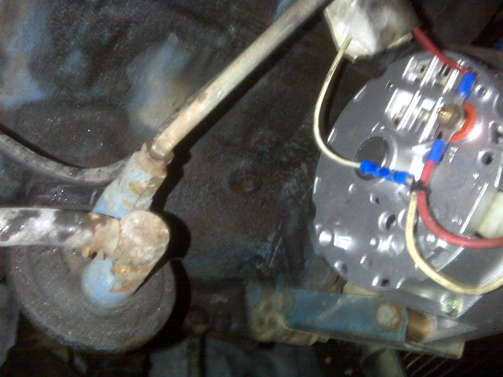

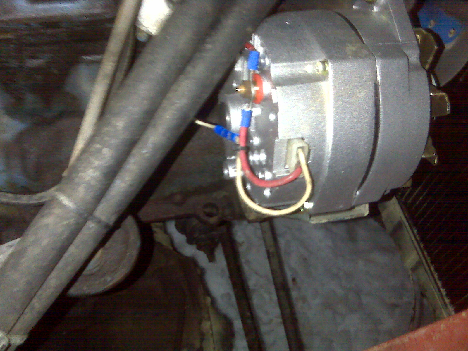

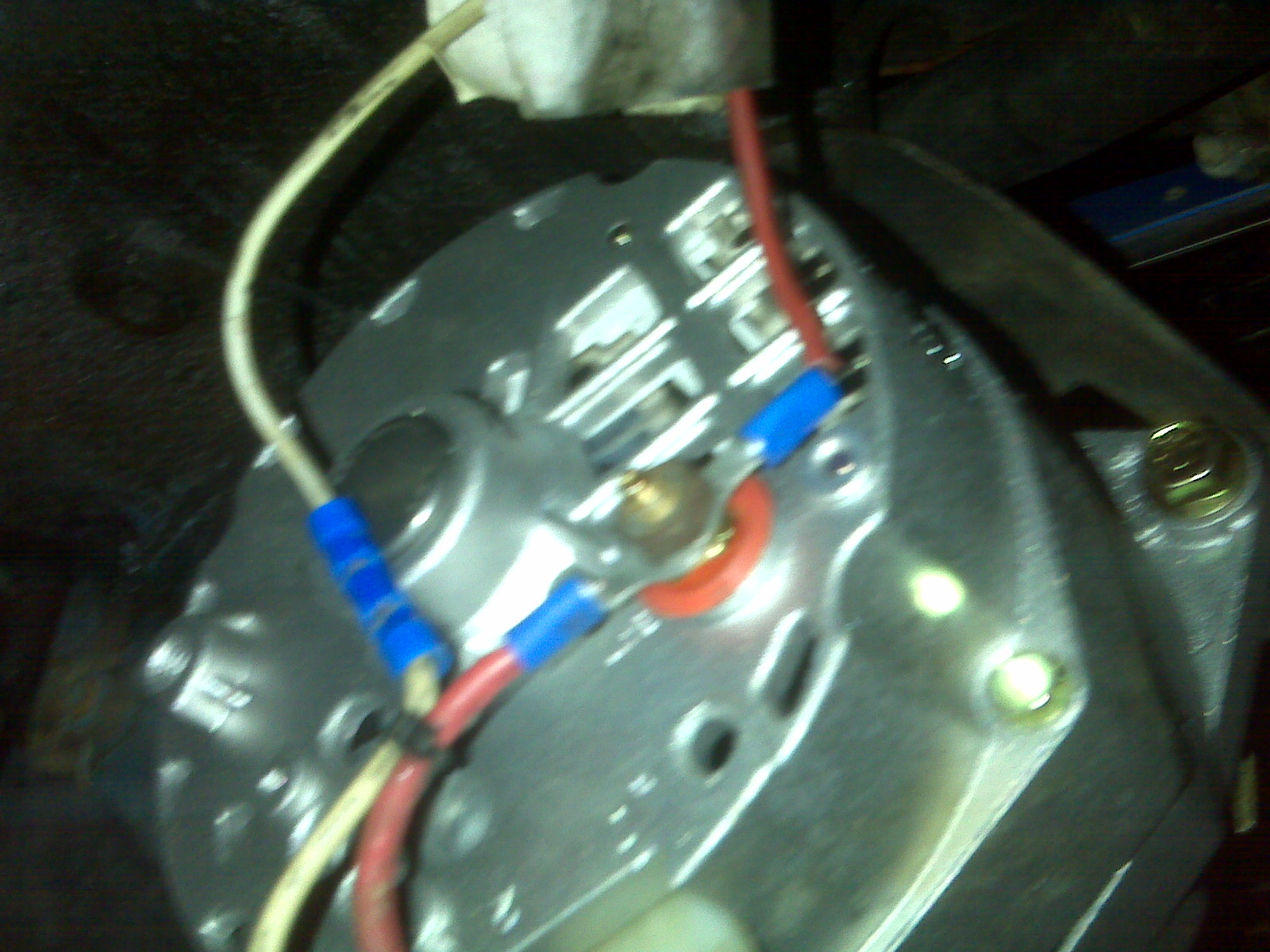

Okay! Here we go. From the model information I got, this IS a one wire alternator... Here's the setup-

And I looked EVERYWHERE for a voltage regulator... Nada. That's bad right? Unless it's not a box... I have have no idea though.

that's a delcotron allright with an internal regulator. the white wire needs to be hooked up to an alt light or a resistance wire, the wiring diagrams show a light bulb in parallel with a resistor. what i have done in the past is a dasshlight bulb and holder wired in series to the ignition switch "on" terminal. if you wire this directly to 12 volts, it will burn out the alternator. you must have a bulb or some kind of resistance in the circuit. this is what turns "on" the alternator. the red wire going from the no. 2 terminal(sensing voltage) directly to the main positive output (post) is unconventional but i think it should work. usually this wire is hooked up somewhere further from the alternator, such as the horn relay. good luck, john

it should work like a regular old generator or "idiot"light, pardon the expression, if you wire it up with the resistor and light in parallel like the wiring diagram shows. on when the key is on motor off, and goes out when the motor starts. when i've hooked it up with just the bulb before, the bulb stayed lit all the time but got dimmer when the motor started depending on how big the light bulb was. the delcotron is a real depenable alt, best one in the world imho, should work fine. john
