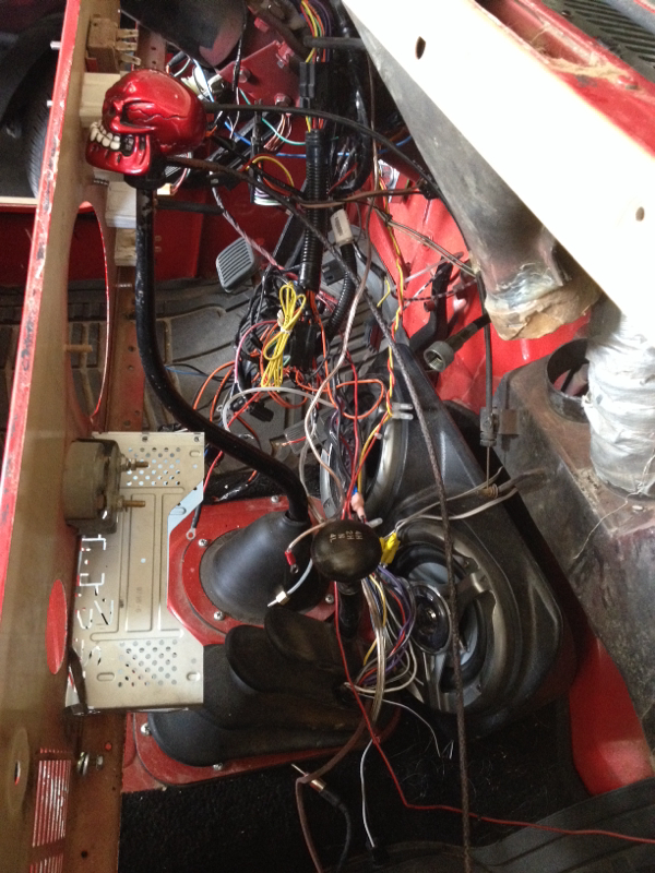

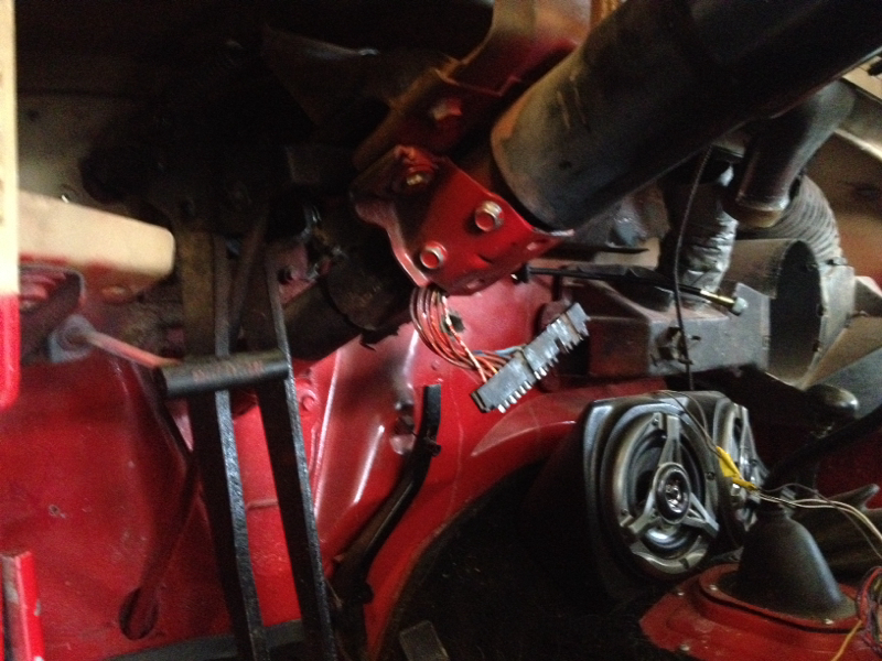

So I went from a rats nest, to no wires. I'm at the point of no return, hope i can put it back together and get it running. #nervous.

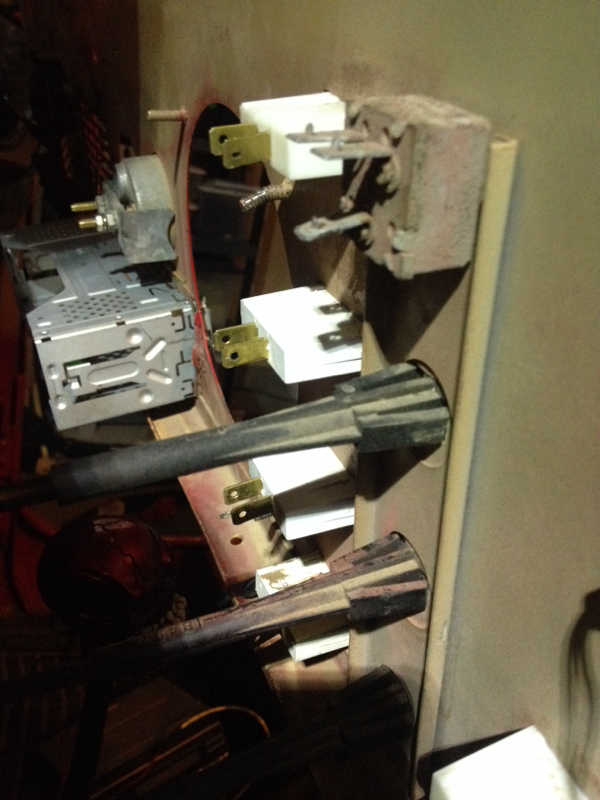

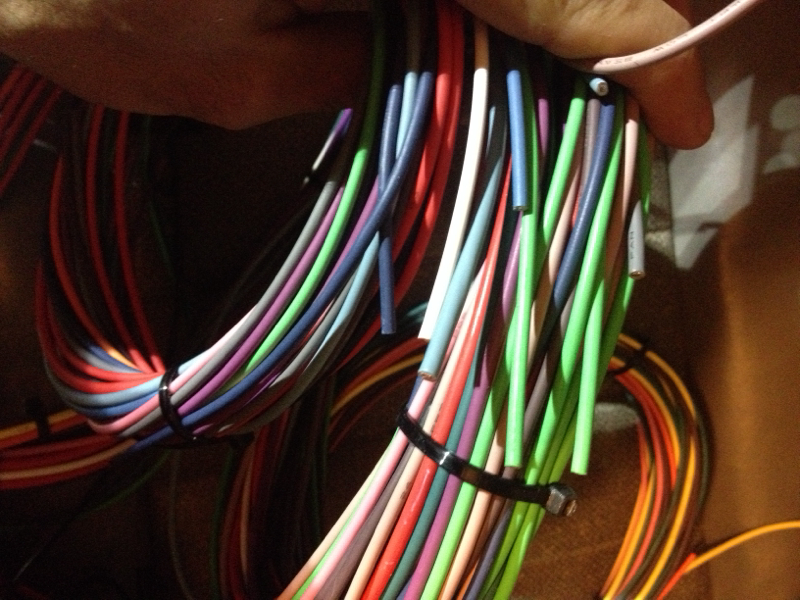

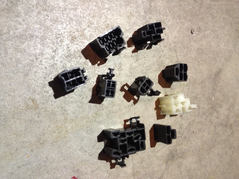

So one thing I have found is that all the nice plastic wire connectors don't come with the EZ kit. EZ simply has bare wire ends. I've taken all the ones off the old wires that I could salvage. The big deal about this is 1. Connecting all the dash indicators would be a pain without them 2. Connecting the light dimmer switch would leave too much stress on the connection. 3. In my case, the head lights and tail lights are nicely connected and wrapped in plastic tubing. I don't want to rerun all that wire, so I need a solid way to connect those wires to my be harness. The plastic connectors allow for less stress where the old and new come together.

I'm failing to understand why this is called an e-z kit. It seems they are making you do all thee work by terminating it yourself. Apparently , they are making you decide what connections are correct and will have you make the connections for your particular application. I'm now wondering , is this kit supposed to be sold at a savings significant to a painless wiring kit ?
I was under the impression it would be complete , plug and play. Or , did we get played ?
So , do I understand this correctly , are there metallic terminals at the wire ends , but no plastic connectors to make the connections ? Or , as you've stated , bare copper , no terminals ? Is this correct ? If so , do you feel the kit is complete otherwise ? Do you think all the wire you need to complete this job that you personally removed is in the kit ? This seems like sort of a test , but is it fair ?
If it will be necessary to you yourself terminate the wire ends with terminals to bare copper ends , it seems you will have to clip them from the old harness , one by one , carefully to avoid confusion , and slip shrink wrap over each wire first , then manually join them together and finally solder them to finish and heat the shrink wrap to complete . This of course is tedious and labor intensive , but will make a complete harness , correct and you can make to the correct length of the original harness to make it like the original OEM install . Yes , please save EVERY part of the original harness until the job is complete , as you have undoubtedly surmised .

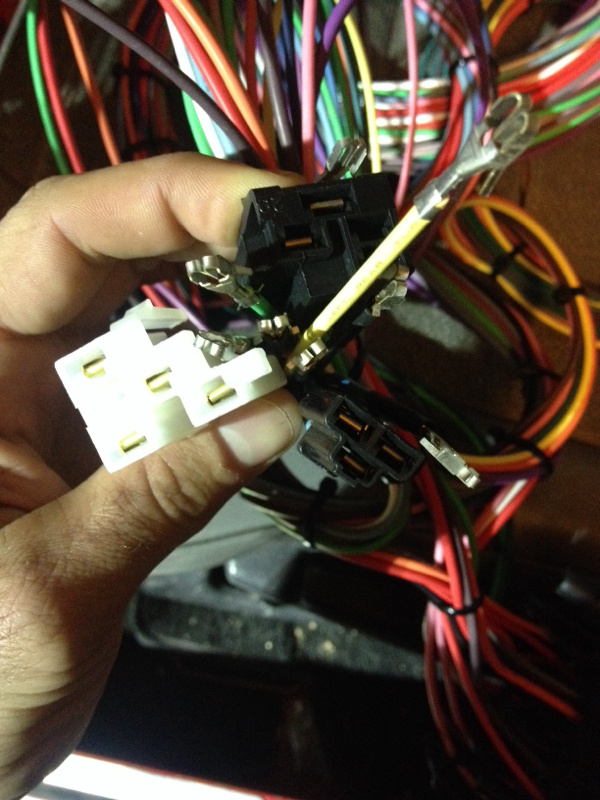

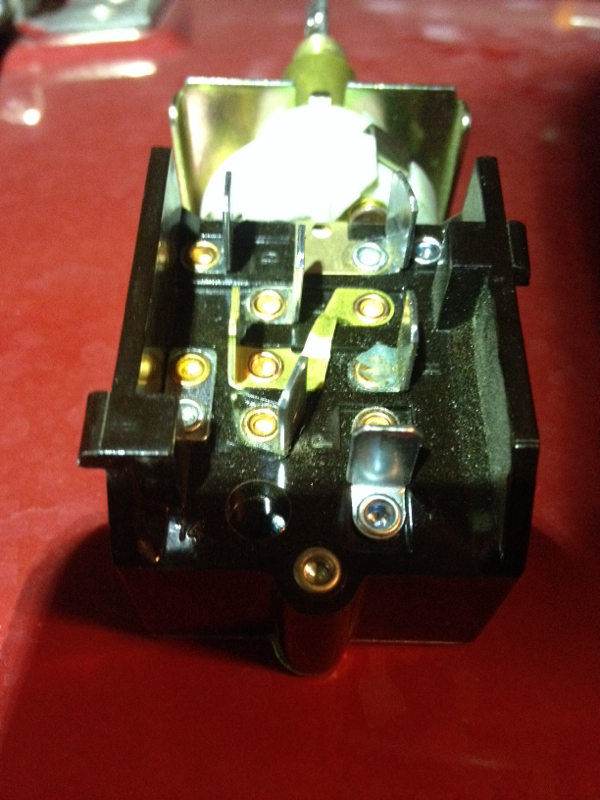

So to answer some of the questions. 1. Yes the EZ harness wires are mostly bare copper. With a few exceptions but there is a huge need for the male / female metal connectors along with the plastic connections to keep everything grouped. I don't think it's worth an extra $200 if the painless come with the caps. 2. The dimmer light is a weird set up on the 77. Pictures are attached. The only connector I could find for sale was a four prong, so I was happy to be able to salvage the old connector (7 pin). 3. I have the plastic adapters for the tail lights, but bare wires for the headlights (connected). So after getting the metal ends, I will be able to attach the tail lights with ease, but will have to also cap the headlight wires.

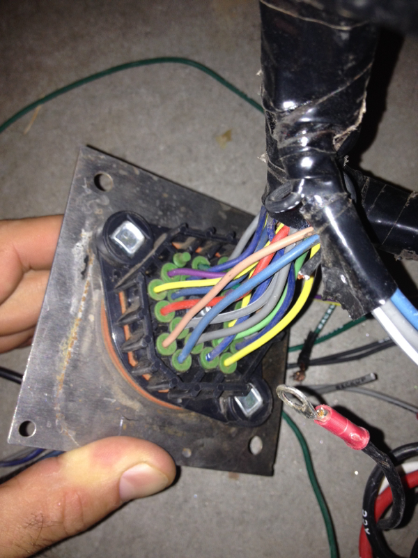

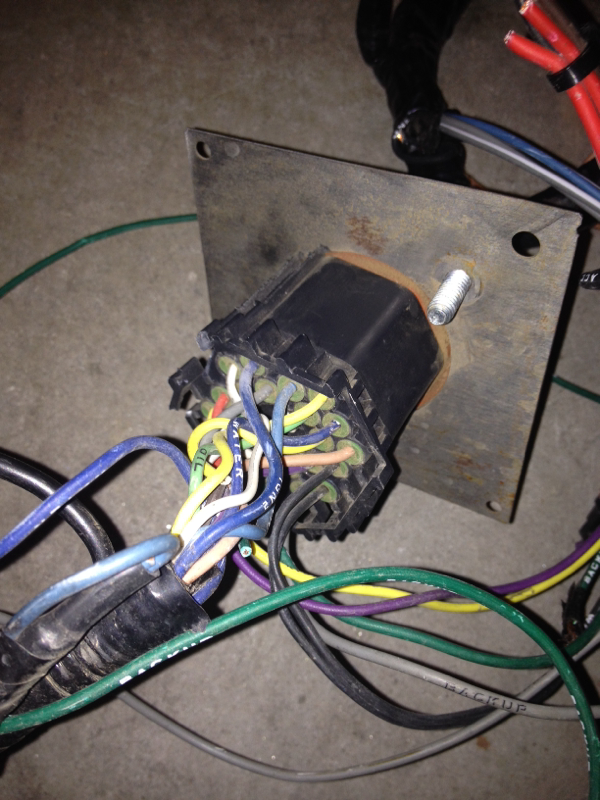

Question for y'all, the old set up had this nice "through fire wall" connector. Anyone know the nomenclature and if I could find another one? I now have a big hole in my firewall and need to close it off or reinstall this type of connector.
Through wall connector
Light Dimmer switch
EZ harness ends

Salvaged connectors
Dash indicator lights that need connectors.

I'm not certain how the EZ kit runs through the firewall? Does it have some kind of bulkhead connector for the wiring that passes into the engine bay? The OEM setup would have had a fuse block that screwed in over the hole in the firewall and two plug connections routing from the back of it, one for head lights and the other for the engine. Regardless, you may have to make a cover for the existing hole whether it be made of steel metal (DIY fabing) or check with an electrical supply shop for a rubber gromit.
The dash indicator lights in your photo are simply connected with female press on connectors, soldier or crimp on are available pretty much everywhere ( i.e. STA-CON).

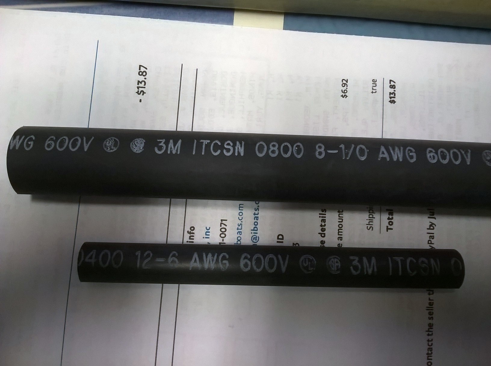

3M makes some of the very best heat shrink wrap available~at a price. This stuff is not only thick walled when shrunk it also has internal adhesive so absoltuely the connectors get sealed.WP_20170320_09_55_16_Pro.jpg
