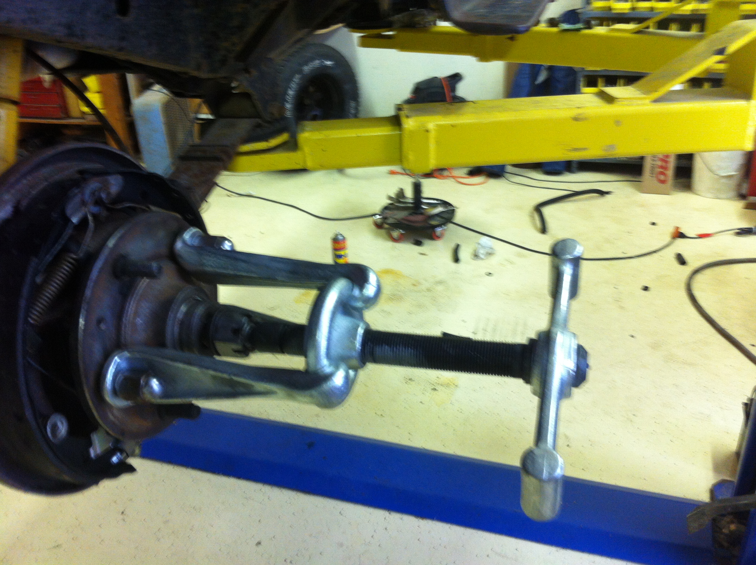

I hope you got the correct puller. If you got a three arm claw type puller, you will very likely bend you hub before it ever comes off. You need a HD hub puller with at least 3 arms that bolt to your lug nuts and has a striker on it that you hit with a hammer. I just went through this about a week ago, I got my puller from CalVan Tools $82.00 + shipping. Like you I went to every place looking for a puller, know one had it. once I got my puller it literally took it off in about 5 minutes.

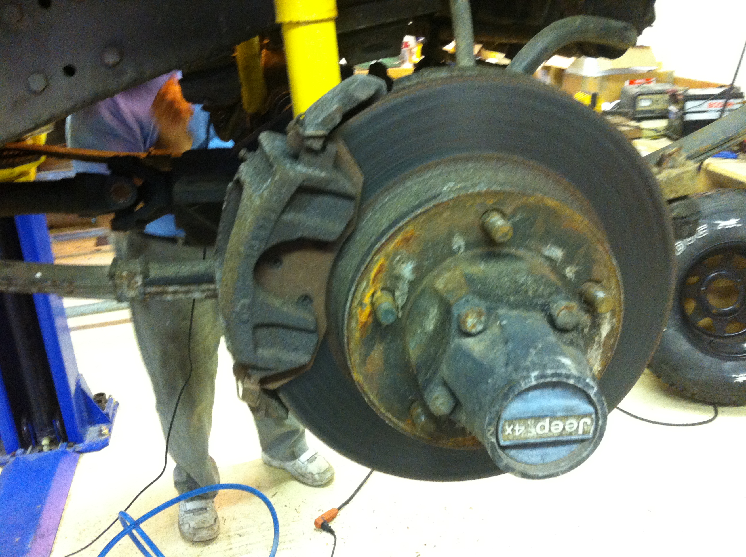

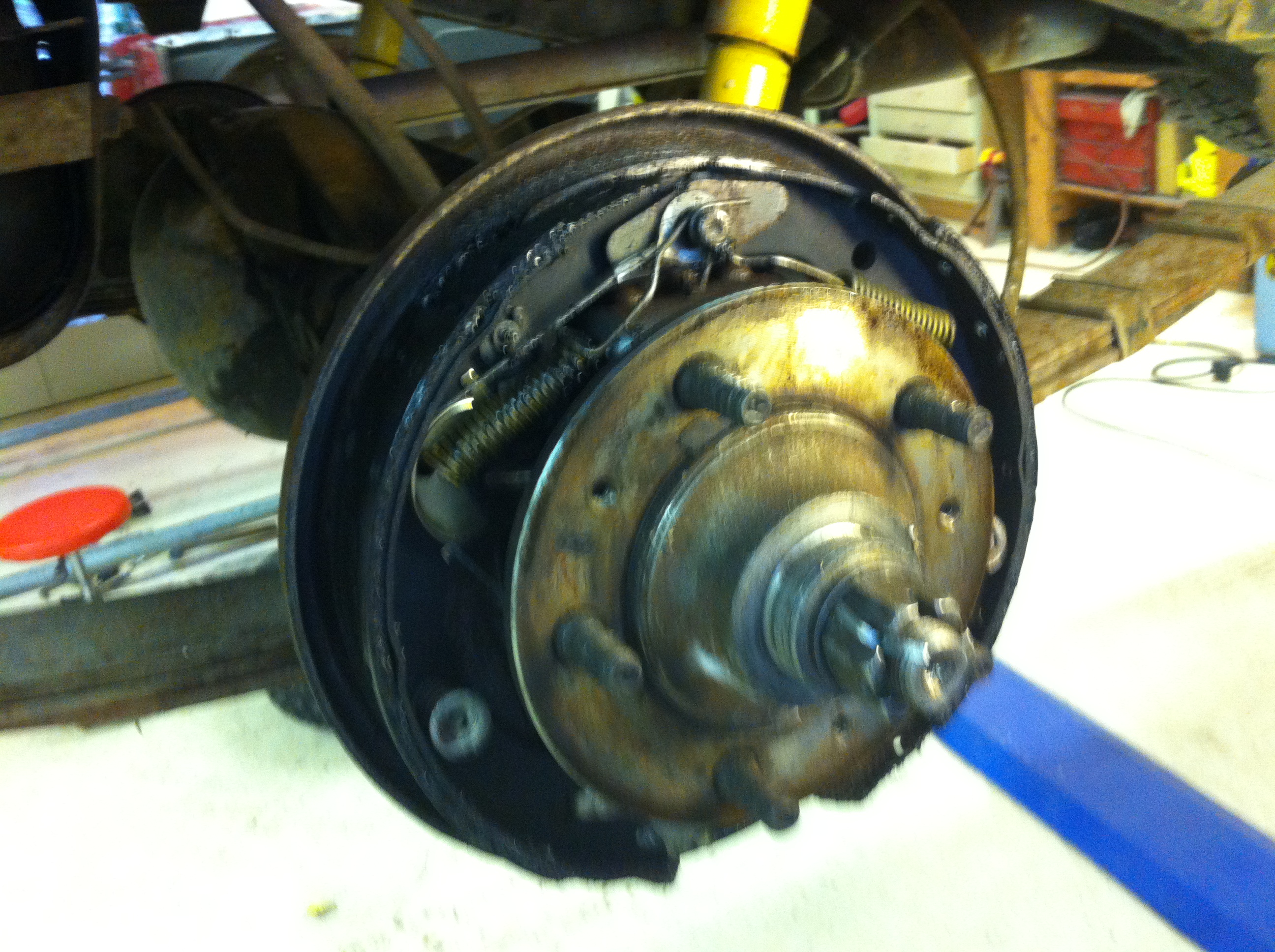

tool is on the way, this is the bugger we have to pull. please ignore the picture of the front .i am learning to post pictures

tool is here and we are in buisness
