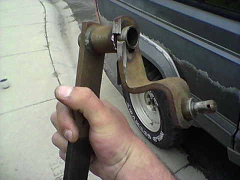

Well Hercules, although i can push 450lbs. on a leg press machine, i don't think i'm strong enough to snap a clutch pedal off. John has good pointers on repairing your rig.:D

And here is an image of my pedal lol! I thought it was pretty awesome.
