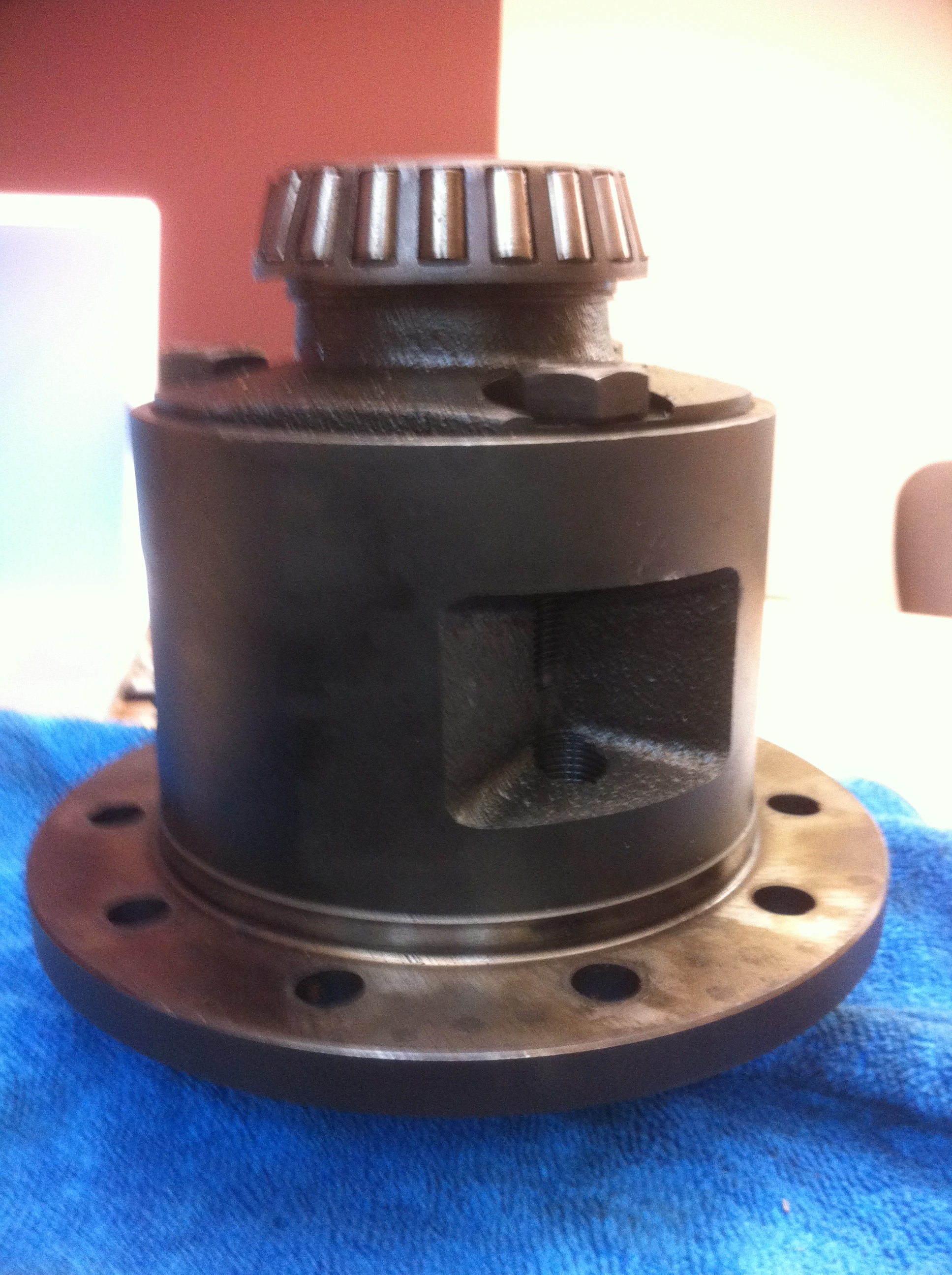

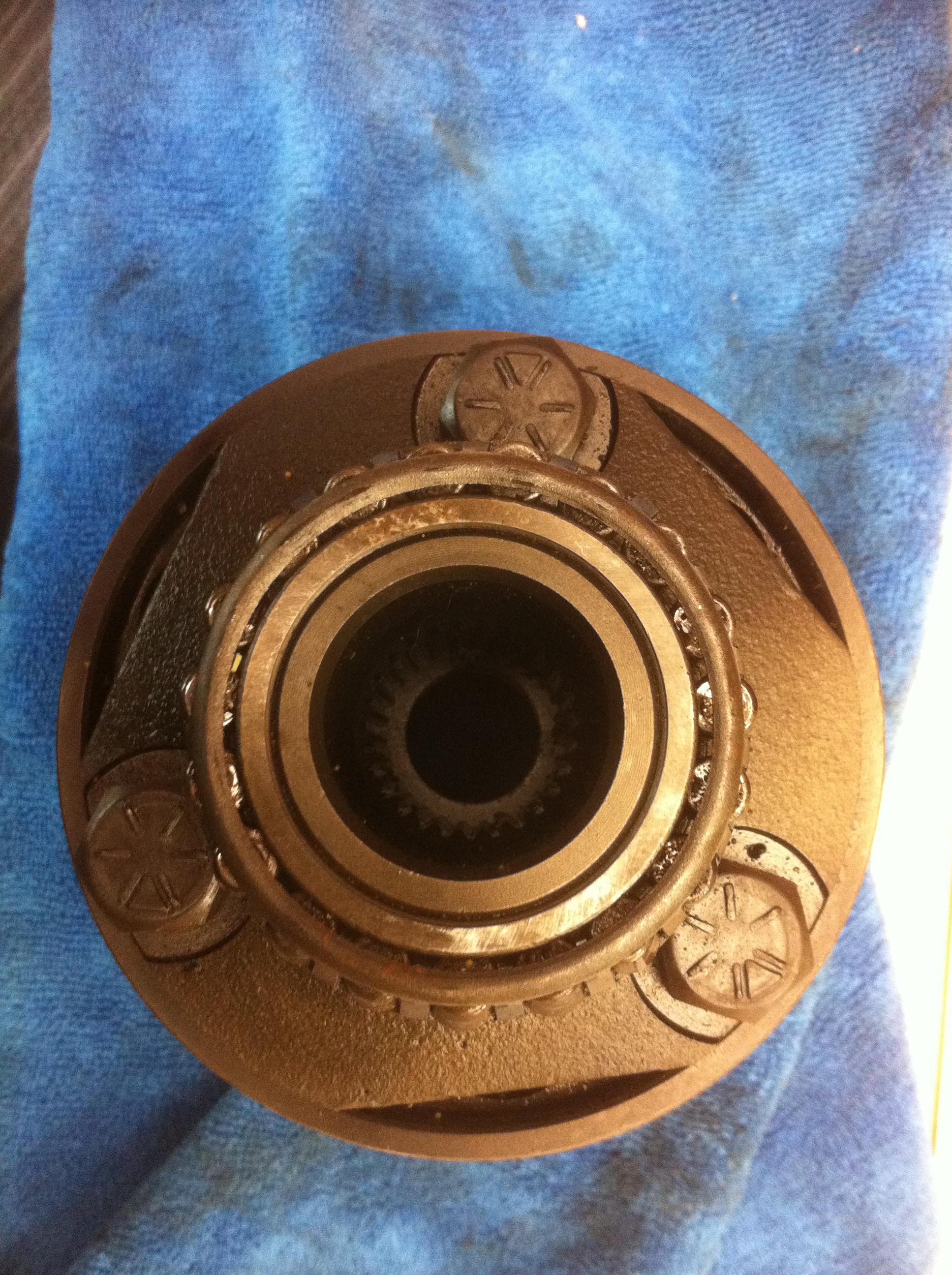

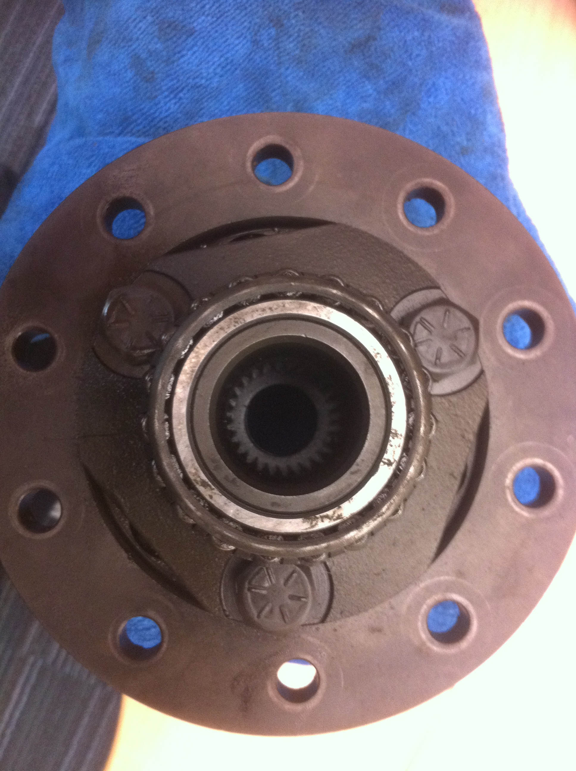

I picked this locker/limited slip up the other day. I would like to know exactly what it is...It came from an XJ with 3.73s. Thanks in advance for any info.

looks like a detroit truetrac, but it would have 5 bolts on the top and not 3. Might be a different brand LSD
