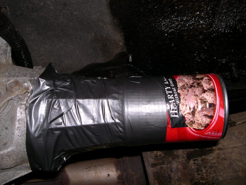

in a pinch, I used a dog food can and taper it to the out put. zero leaking.

Found a pic of the dog can.
hell of a job to get home!! use what you have available.
