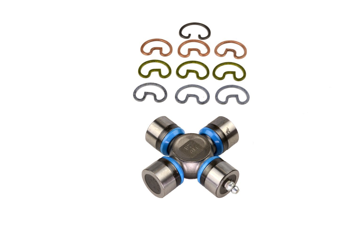

I've never seen a ujoint like this, but it looks exactly like what I need (with the grease fitting on the cup):
http://www.amazon.com/Spicer-5-1310-1X-U-Joint-Kit/dp/B00DOI8CV4
Have you ever used one like this?

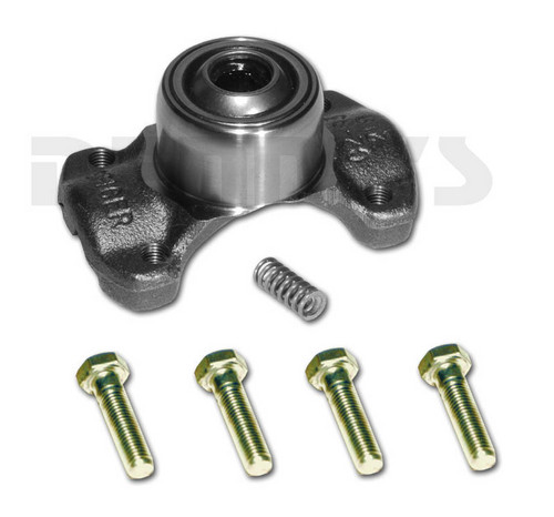

A squeak is likely the centering ball in the double cardan joint. The ujoints are fine if you just replaced them.
It will require dis-assembly to properly grease the centering ball. Left unserviced the double cardan joint will grenade and take out the transfer case.

In general the ball should be replaced when rebuilding a double cardan joint.

This is your culprit. They make a rebuild kit that includes a new ball, spring, and seal. Most parts counter jockeys can't find them in the system, but auto parts outlets carry them.

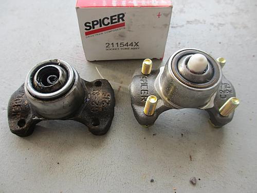

I used a new centering kit when I swapped out the joints - everything has about 8k miles.
Having said that, I didn't do any additional lubrication on the centering pin. Is there a lubrication process that I missed out on (there was some factory grease that held the spring in).

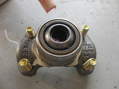

20670d1433116236t-jeep-front-driveshaft-cv-dual-cardan-rebuild-33-ball-centering-unit.jpg
20671d1433116236t-jeep-front-driveshaft-cv-dual-cardan-rebuild-34-socket-yoke-assembly.jpg

I only know of three types of U joints: the one that has the zert fitting for a std. grease gun, the one without (you can disassemble it and put grease into the cups, but its designed to be replaced} and one I recently found on a Bronco 11 - it has a very small hole to pump in grease with a needle gun ( I used a chain saw tip roller grease gun). good luck - vin
Amazon.com: Spicer 5-1310-1X U-Joint Kit: Automotive
The double Cardan joint on my front shaft has a flush fitting on each cap . If such a fitting can be obtained for the caps on that joint , that will be perfect . Can be greased with a proper fitting grease needle. The threaded side of the fitting is small on my caps and these appear to be the larger size.
also , I have C - clips which snap to the cap inside the yokes . Truly don't know if they are still are available . This is the first four wheel drive I haven't had to rebuild them on , yet.
Many times , u-joints , ball joints and tie rod ends are shipped with threaded plugs installed where the grease fittings go . The grease fittings can be installed when time to grease and the plugs re-installed afterwards. This will eliminate the worry of a fitting being broken off off-road and such. No worries of balance issues in either case. There doesn't seem to be the concern of clearance to reach fittings from the video such as on my model year. That's good.
I called Spicer technical support yesterday and talked to a guy who seemed pretty knowledgeable. I gave him my part numbers, and he confirmed that the ujoints and centering ball were all non-greasable (they have no zerk fittings). I told him that when I put everything together I didn't add any grease. He said that all spicer non-greasable components come from the factory with grease, and that none "should" need to be added - essentially that I've done everything right, and most likely just hit some bad luck.
His opinion is that the centering ball needs to be lubricated. He said just open it up and push some grease in with my finger and put everything back together.
He went on to say that he believes they sell more non-greasable ujoints than ujoints with zerk fittings, and for the vast majority of applications they do great.
So, last night in the cold I pulled my front driveshaft. I'll lube it up and install it before my April wheeling trip - hopefully it will get above freezing sometime before then.
