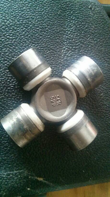

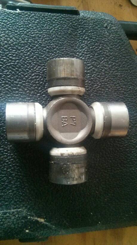

Can you see what failed
Any pics of the offending u-joint? Glad you got it fixed.
Can't tell anything is wrong with it when you rotate the caps, but when installed it made a high pitched squeak.
