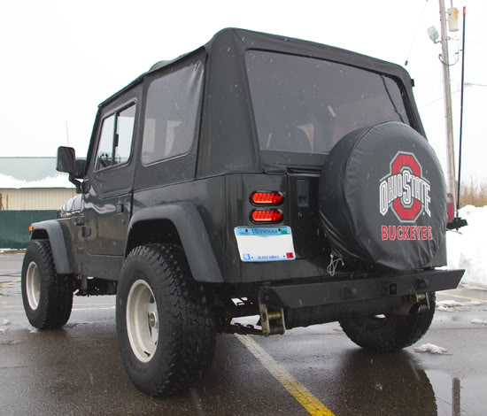

Here is how I did mine, although I used custom 1"x4" L.E.D.s. (the same type street rodders use) Wiring is pretty straight forward. I reused the plugs from the original lights to connect back to the circuit feeds. The only difference is the backup lights need to be rerouted. If you are using any light that draws more than 10 amps for backup you need to use a relay circuit to control them. To make one of the red L.E.D.s into brake only use the third brake light circuit to operate it instead of the one from the normal connector. Keep in mind this circuit is not related to any flasher circuit(ie turn or 4 way) and will not flash with either operated. Don't forget to solder and heat shrink connections.;)

do you have a picture of what you're going for in the end? i'm having kind of a hard time visualizing it. what's wrong with the classic 4" round LEDs? its clean and classy lookin.
Here is what I would like it end up like. Proportions might be a little of but i think you'll get the idea

By looking at that picture above, the top LED is probably cut into the top of the fender on the inside of the jeep. He either screwed up or planned it that way and had a fix for the inside of the jeep.
