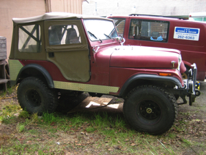

This is what i started with. Really bad shape. motor jacked up, steering jacked up, axles made it un-driveable, power steering jacked up, etc..

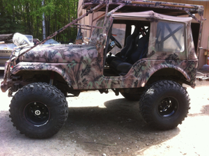

took me 5 years to get it to here

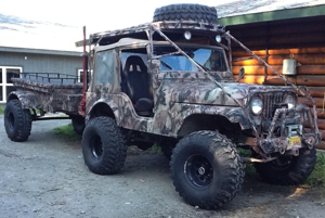

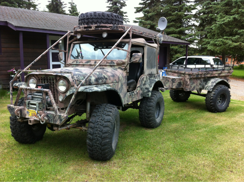

Then i added the trailer
what a fun rig!

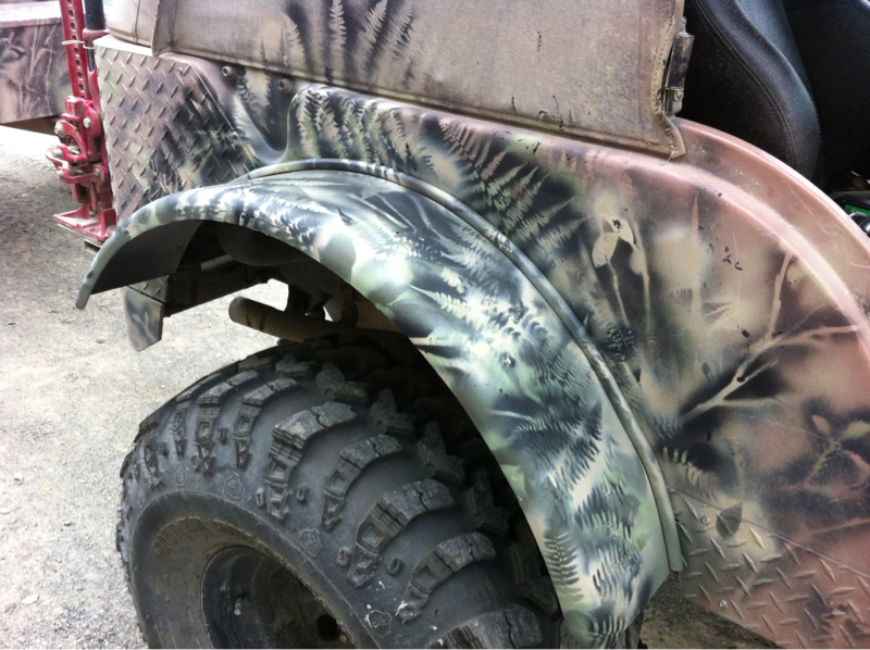

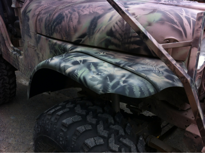

Updated fender flares. The rear were made from a single axle trailer fender, and the fronts were made out of a tandem axle trailer fender cut in half. Then I used a planishing hammer to fit and contour them. I sure like the way they turned out and how they work.
