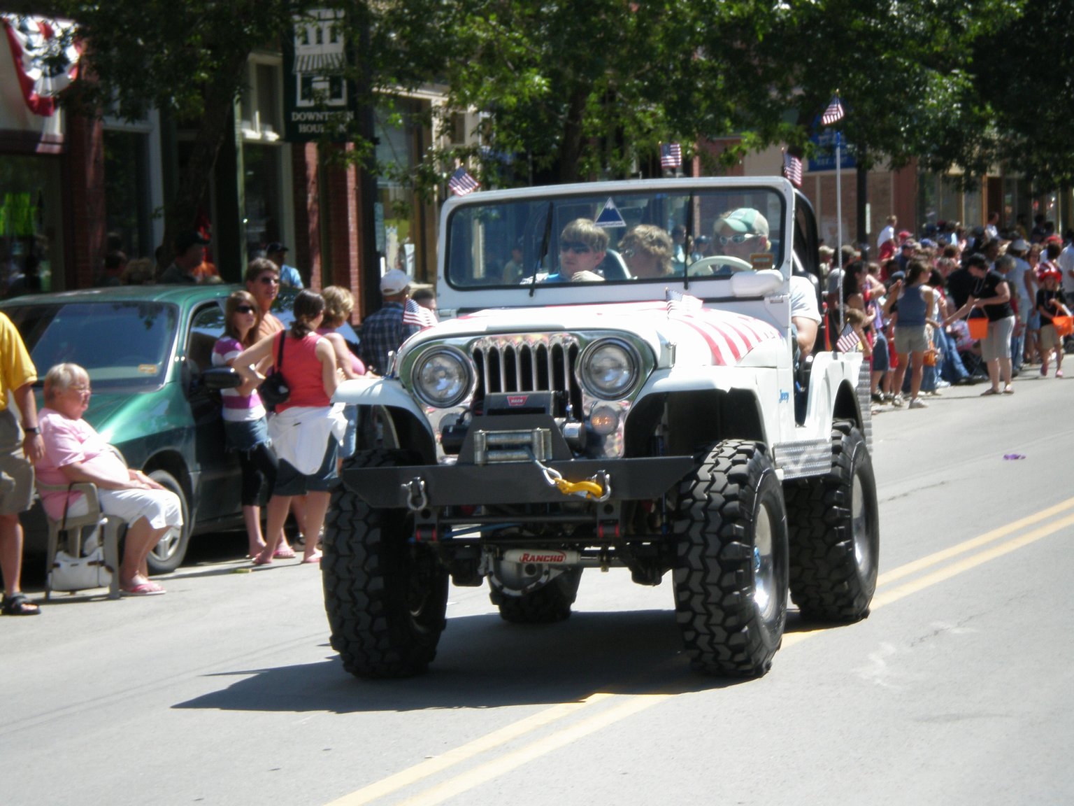

I also have a 73cj5, They are great classic jeeps and only had that particular body 2 years. 72 and 73. Body lifts do create problems with clutch shifting when using manual clutch linkage. Specially while there is flex when off roading. I would recommend installing a hydraulic clutch and loosing the body lift. Hydraulic clutches are a pretty easy to install and a great upgrade. Check and see if you have a mount for the slave cylinder, if not you can have one welded on. A suspension lift would be a great choice. I like skyjacker. If you have any questions feel free to ask. Here is my 73

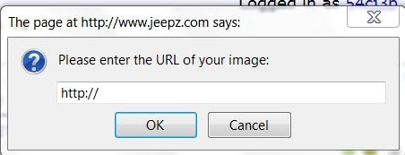

ya its telling me to put the http address in and ya
Right underneath the spot where its telling you to put in the http/: address there shout be an option for choosing/browsing from your computer/phone system gallery. Click on that button. You should be able to figure it out from there.

That is a really nice lookin' jeep man...of course, im sure you already knew that. Its still fun to hear though right? =D

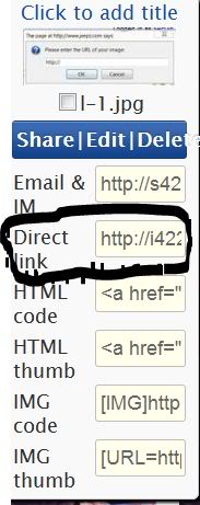

do you have a web host like photo bucket if so click the direct link and copy
than paste it in this window to add it to your post
this window is found on top of your text box click the envelope paste link than click ok
