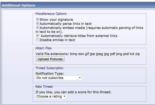

or you can go to the advanced setting thats on your bottom right click it , than scroll down till you come to this box

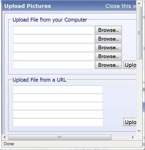

click upload pictures you will see this click brows and add your picts this way

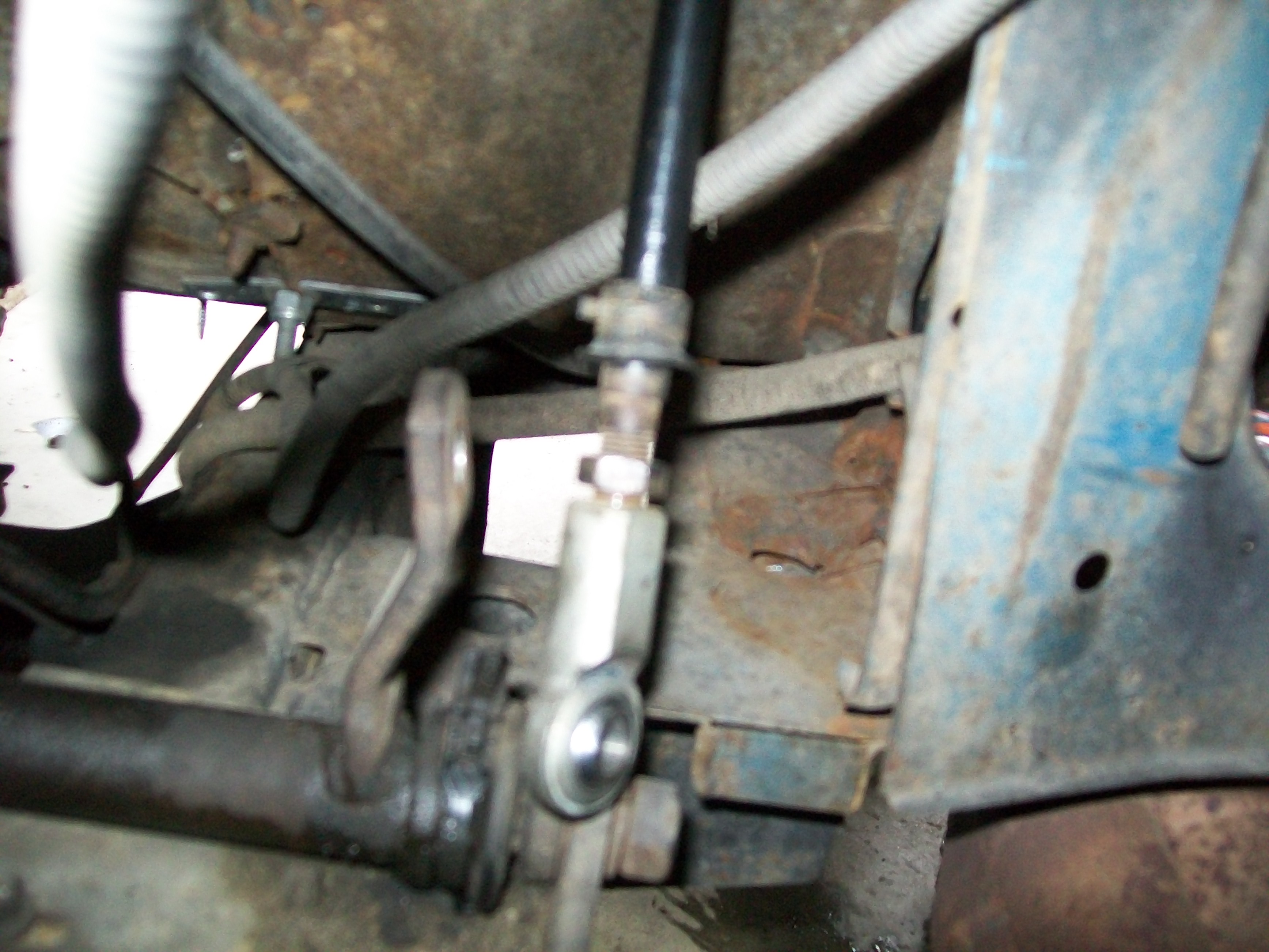

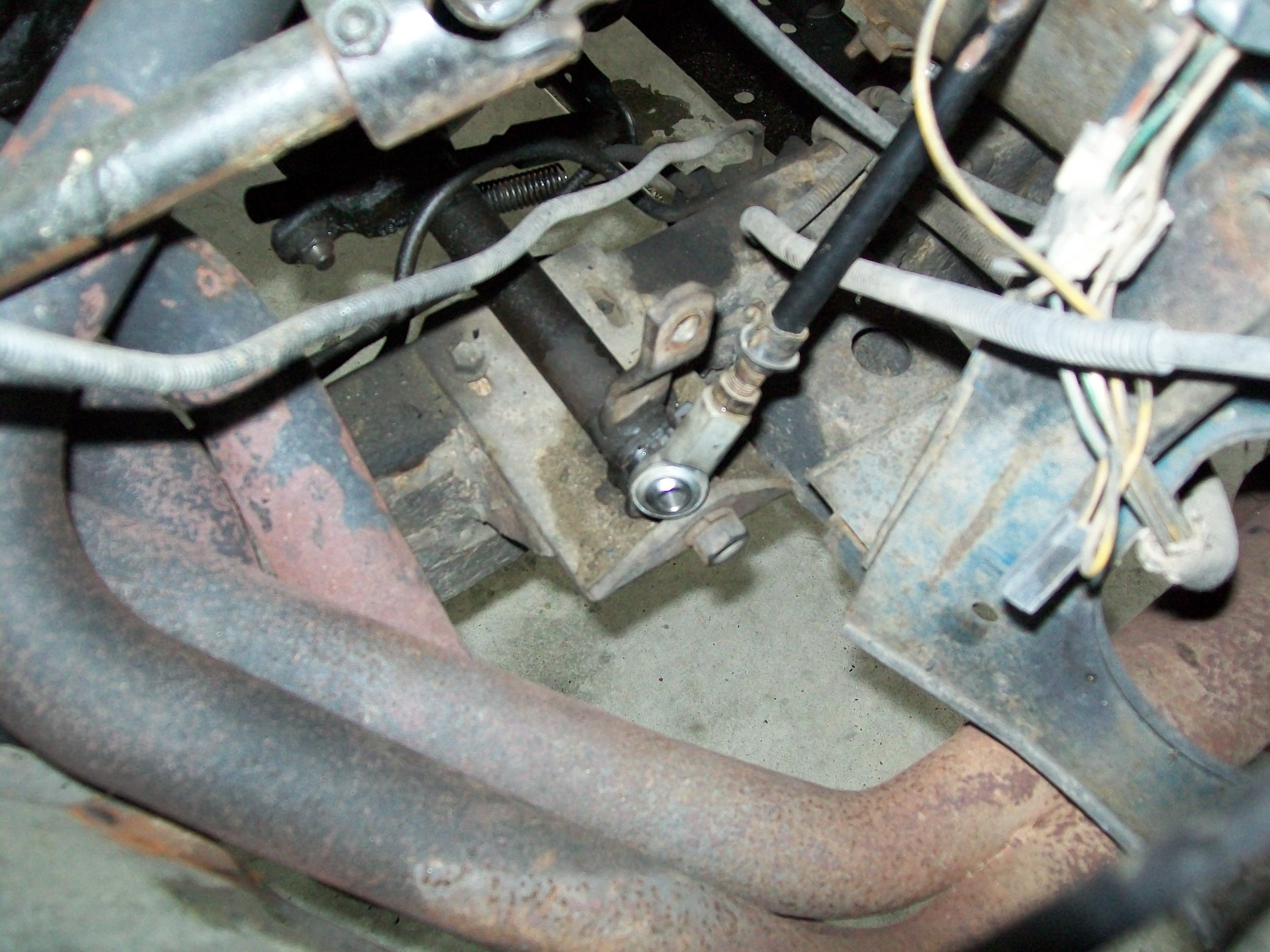

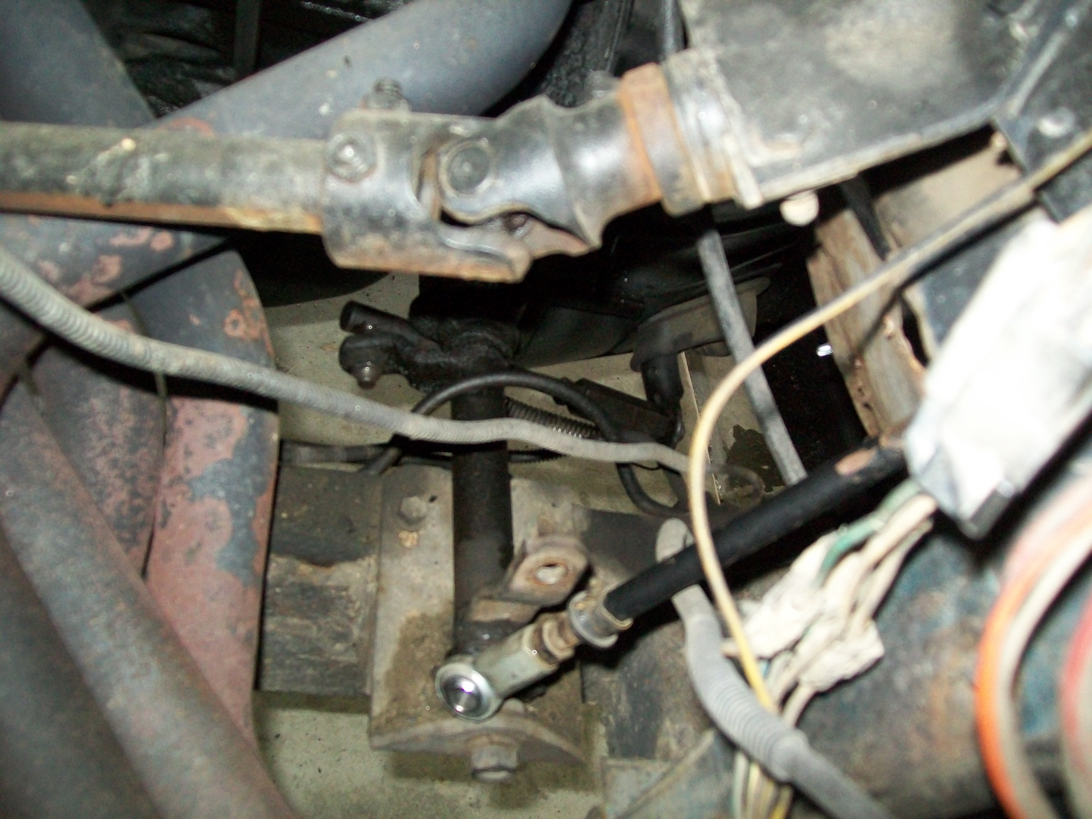

or modify the clutch bell crank arms (this is the arm that comes off eng and mounts to frame)and extend linkage to transmission
well im pulling the body lift off tomorrow and then going to see how it is and when i get money again i will get a hydraulic clutch set up
pulled the body lift off only took 2 hours haha but now i think my clutch arm is to long from the pedal to the linkage. there r 2 holes on the pedal and the hole it should be in i have about 4 to 5 in to long and move it to the other hole and 3in to long but thinking it may be the other linkage adjusted to far also but ya

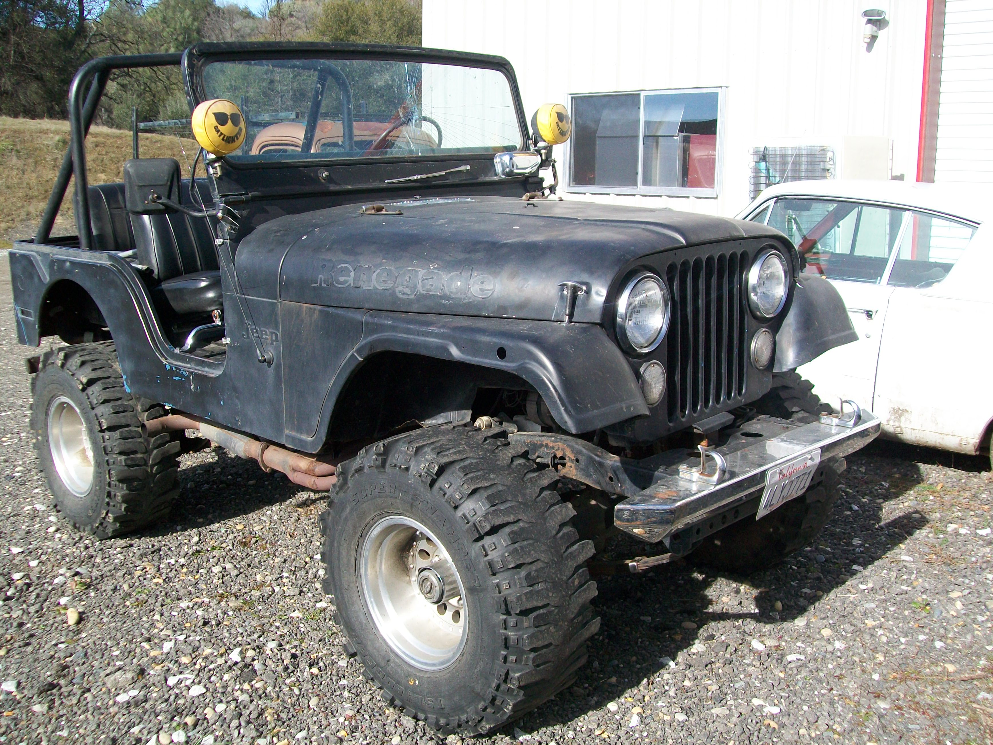

First of all! your jeep stylr was made for more than two years... 1972-1975 are called intermediate! the nose was lengthened to fit the I6 and 304 V8.. I have had one of these and it was a really good rig..
You have a T15 3 speed, Dana 20 transfer, Dana 30 front and a D44 rear with 3:73 gears factory..
These engines are bullet proof and do very well offroad. Hopefully you still have the MC2100 carb on it.. if not! you should find one for it.. mine would run upside down....
33's are about as big as you are going to want on those axles and brakes.. or convert to disc fronts and power brakes!
ENgine wise I put a HEI on mine and it made a huge difference in its attitude. Best 100 bucks you can spend!

but i think i figured out my hole clutch deal. the tabs r off on the linkage so i have to try and fix it or buy a new one
how much movement should be at the fork with everything adjusted right cause i only have 1in and it stops and wont move anymore
