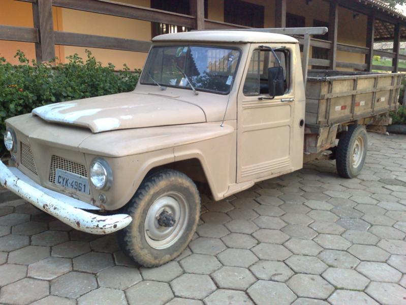

Follow the original picture

Cool looking truck, I'd be interested in seeing pics as it is built.
Bounty__Hunter said:
He said it's a Ford, but the doors look Willys to me.
Hi Bounty, you are right, here in Brazil after 1974 Willys sold the factory to FORD but we still call it Pick up Willys or Ford Willys, the original 4cc engine is from the Maverick, the one I still have.
One question / help I need is : What kind of conection between engine and tires are you gaus using to make it strong and no break, of course there is a limit.
Engine 6cc and tires 38"
Thanks

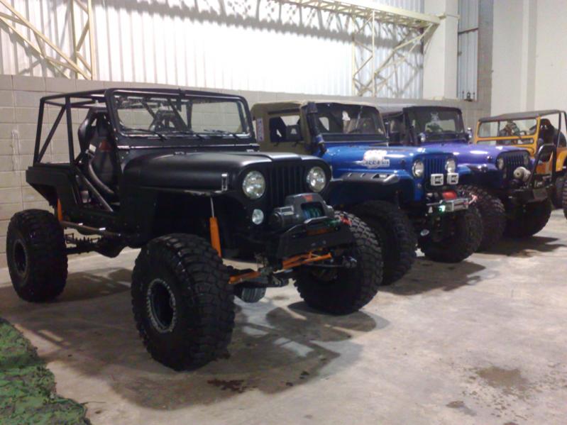

Follow attached pictures of my brother-in-law Jeep, it is the first Jeep, the black one. We will work on the same project.
