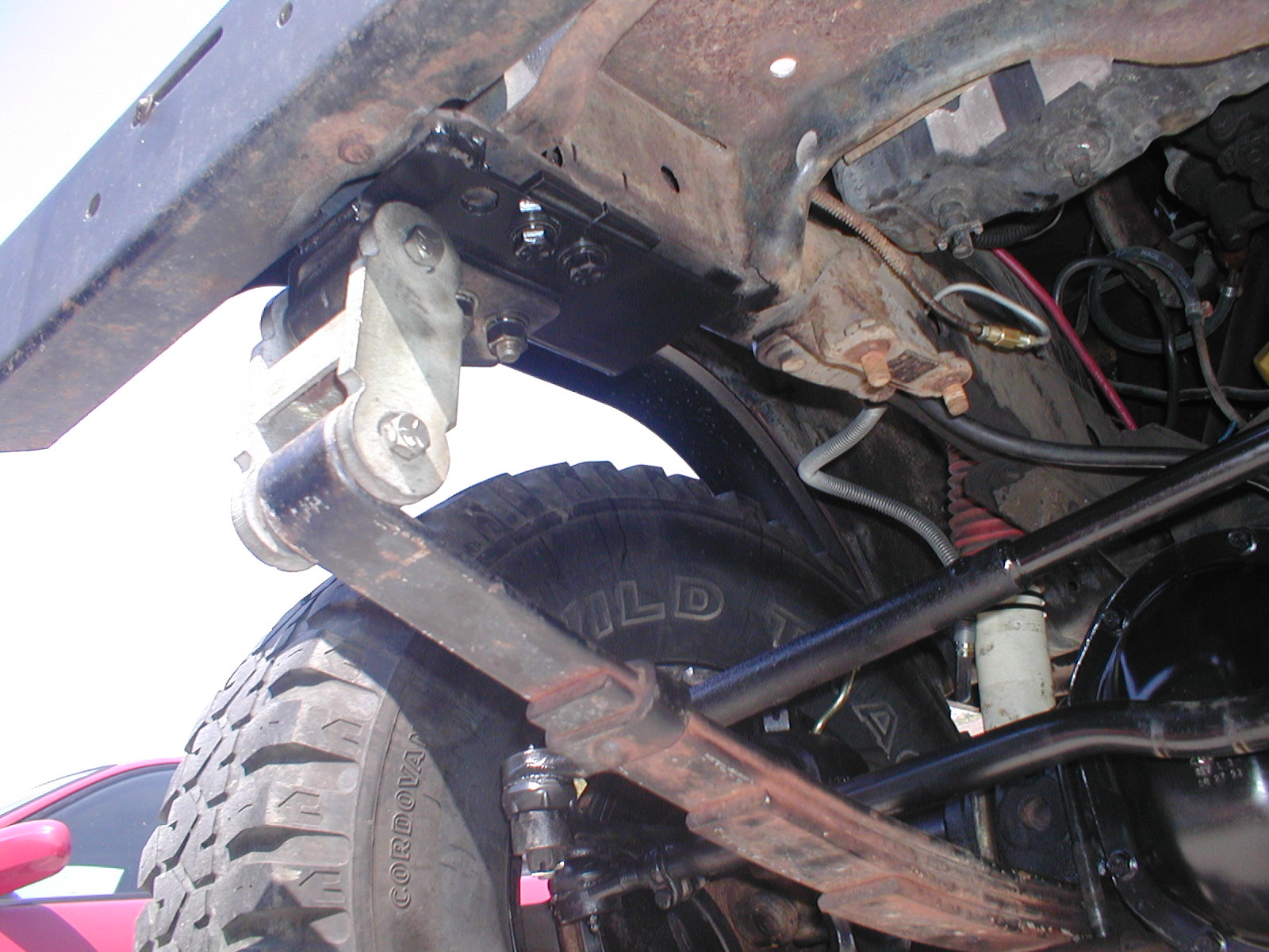

Reversed shackles aren't very road worthy, from what I gather. Basically an off road only mod. Kits aren't too pricey, as far as mods go. You'd probably have to get your driveshafts lengthened, too.
I don't see how I can reverse my shackles, I have a cast part that is kind of a tube welded on the frame,(look at the pics) I would have to totally change the mount on the front for that. The other thing is the driveshaft length, the dana diff has a longer pinion section, which pushes the driveshaft back closer to the transfer case. It isnt a problem now, because as the springs are compressed, the shackles rock forward effectively pulling the axle forward away from the transfer case. I only have about 1/2 inch of space for the shaft to shorten now.

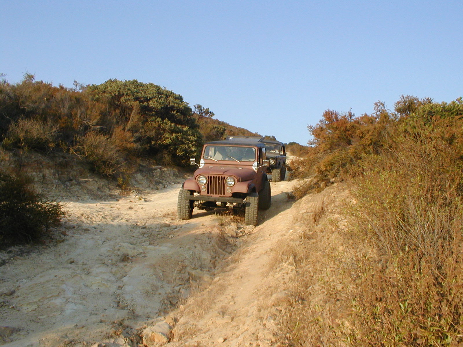

Well, I took it out today, finally got to put it into 4wd Low, it seems to climb very well, my buddy took his Bronco also, we had a lot of fun, just light trail stuff. It was a bit twitchy and hard to drive on the road, but very cool off road.

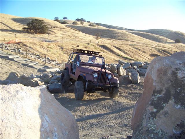

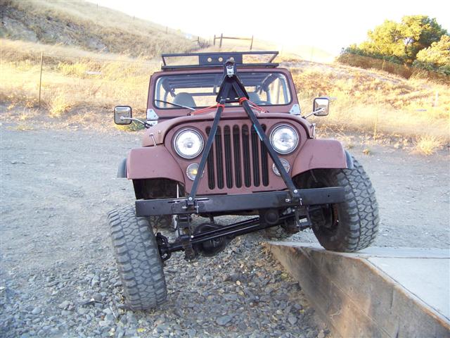

some pics, after all the work, including cage work
