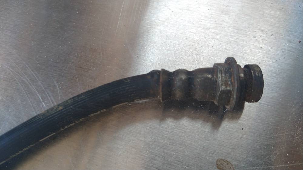

I recently had my Jeep inspected at the Firestone station and I came away pretty impressed with their inspector.
My Jeep failed inspection because they said there was a bubble in the passenger rear brake line. For the life of me I couldn't see it but the part was cheap enough so I decided to swap it out anyway.
This is pretty much what I saw while it was on the vehicle
It wasn't until I got the hose off and inspected it up close that I could see sure enough, there's a bubble in it.
I'm really impressed that they caught it. I suspect things could have been pretty bad if it had burst.

I had one block internally like a check valve. Once you apply the brake it stuck. Until you bleed fluid off it was stuck. Swapped it out and no issues since.
