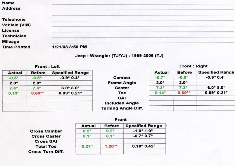

Here's my alignment sheet after adding a 2" spacer lift
880d1201142732-lift-your-tj-installing-rubicon-express-2-coil-spacer-kit-jeep_tj_alignment.jpg

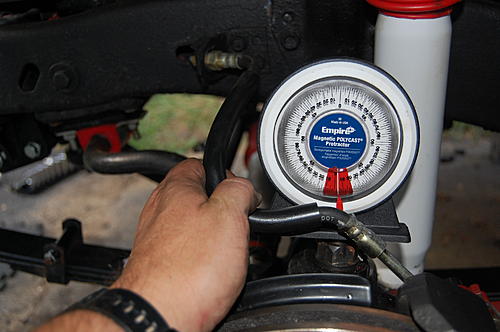

As pointed out by the other members, caster, toe and camber all play parts in the stability of your steering and toe also has a significant role in tire wear. Unlike the later model Jeeps, your YJ (along with CJ's)comes from the factory at a pre-set, non adjustable caster and camber angle. I would guess that caster angle is the real problem and you can measure it yourself with a simple tool (a magnetic protractor, see photo). You can also measure your toe angle at home as well, but it with be expressed in inches not degrees (obviously a shop can do this way more accurate). It's unlikely that your camber angle has changed to any real degree unless you have damaged the axle/differential or upgraded to a different type of frontend. Camber can be changed as well using shims.
Try checking your caster angle with the protractor. Simply find a level spot and place the protractor on the top ball joint stud. You do not have to take the tire off as long as you can read it, but if you take the tire off you'll need to load the axle with the weight of the vehicle. You'll want to see an angle greater than 5 degrees but not extreme either (between 5-8 should work). Regardless the shims come in 2 degree increments, generally 2, 4 and 6 degrees. You would simply do the math for your vehicle.

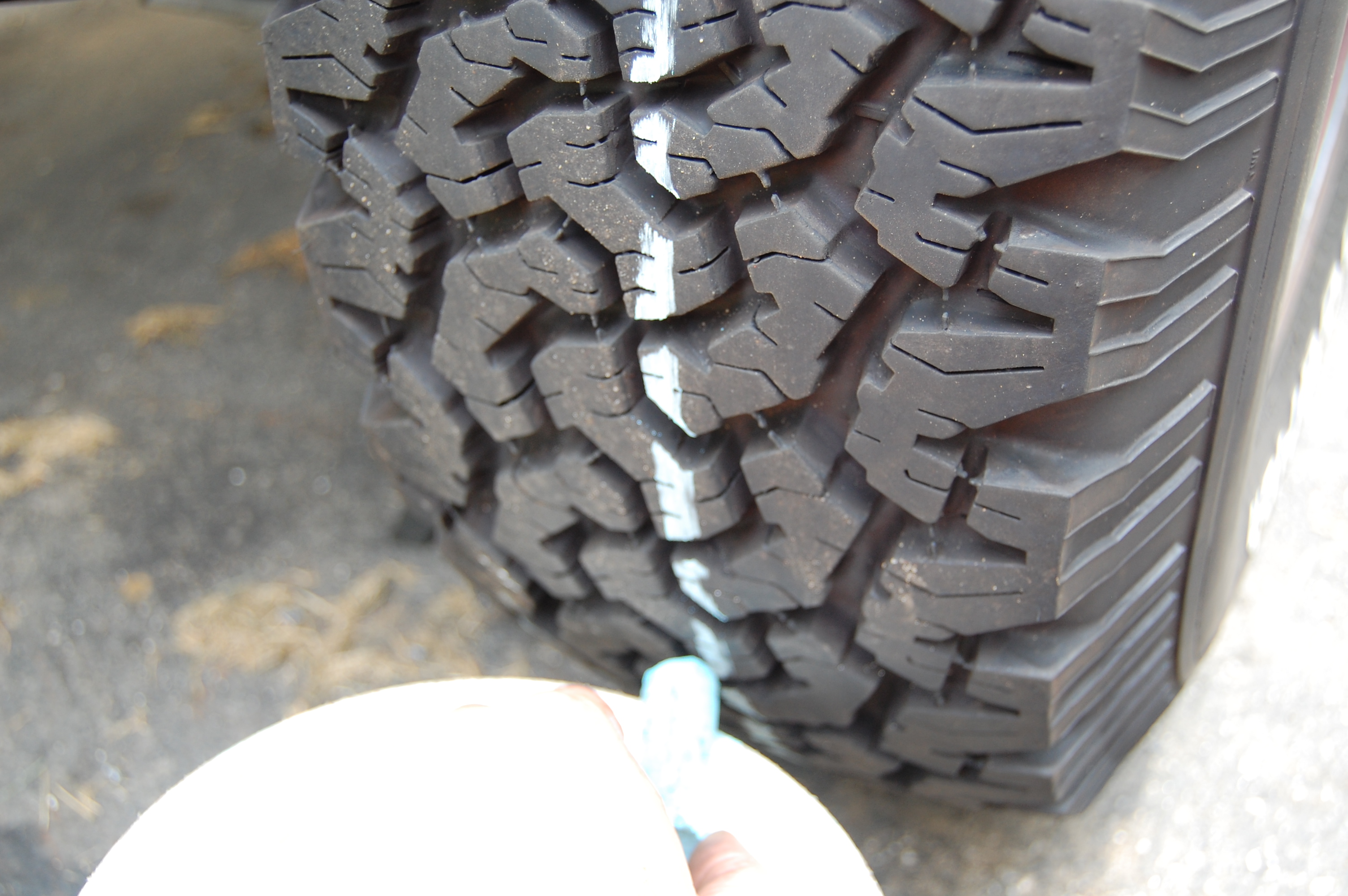

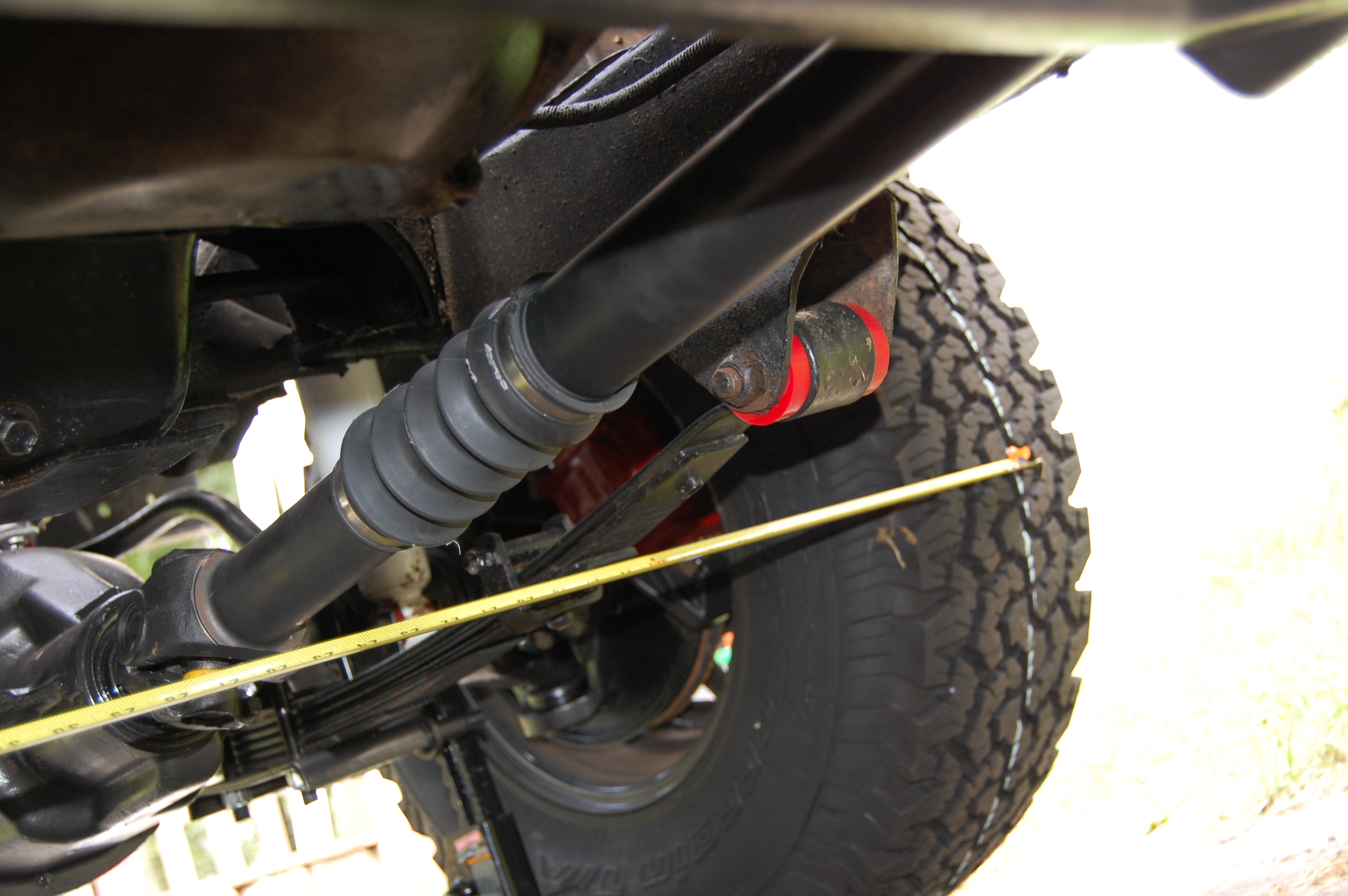

To check your toe angle, simple make an even chalk line round your tire by lifting the frontend off the ground, placing the chalk on a bucket or box and spin each tire slowly. Then lower the vehicle and measure thedistance between the lines in back and then the front. Try to use the same height front and back as close to the center of the hub as possible. The front or forward measurement should be less than the rear, "Toe-in".Somewhere in the area of 3/16th of an inch should work.
