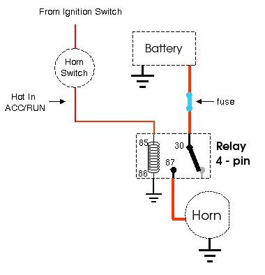

well, i cut the original horn cord, and its got a red/green wire, and a black one...
Green usually means ground, but im not positive which is which. So then i put the positive on the relay, run a wire with inline 20 amp fuse to the battery, run a wire from the relay to the pump. ground the pump, ground the relay, and done?

Anyways, they say a picture says a 1000 words, and I don't feel like typing that much, so here's a typical horn w/ relay schematic :p :mrgreen:

its not the relay thats the pain, its that it came with no wires at all, and i can never decide the best place to mount the relay. i understand the wiring now, thanks to xjnick
my relay is not actually mounted anywhere, none of my relays are... i just tape around them and the wires really good and tape them to a nearby something
