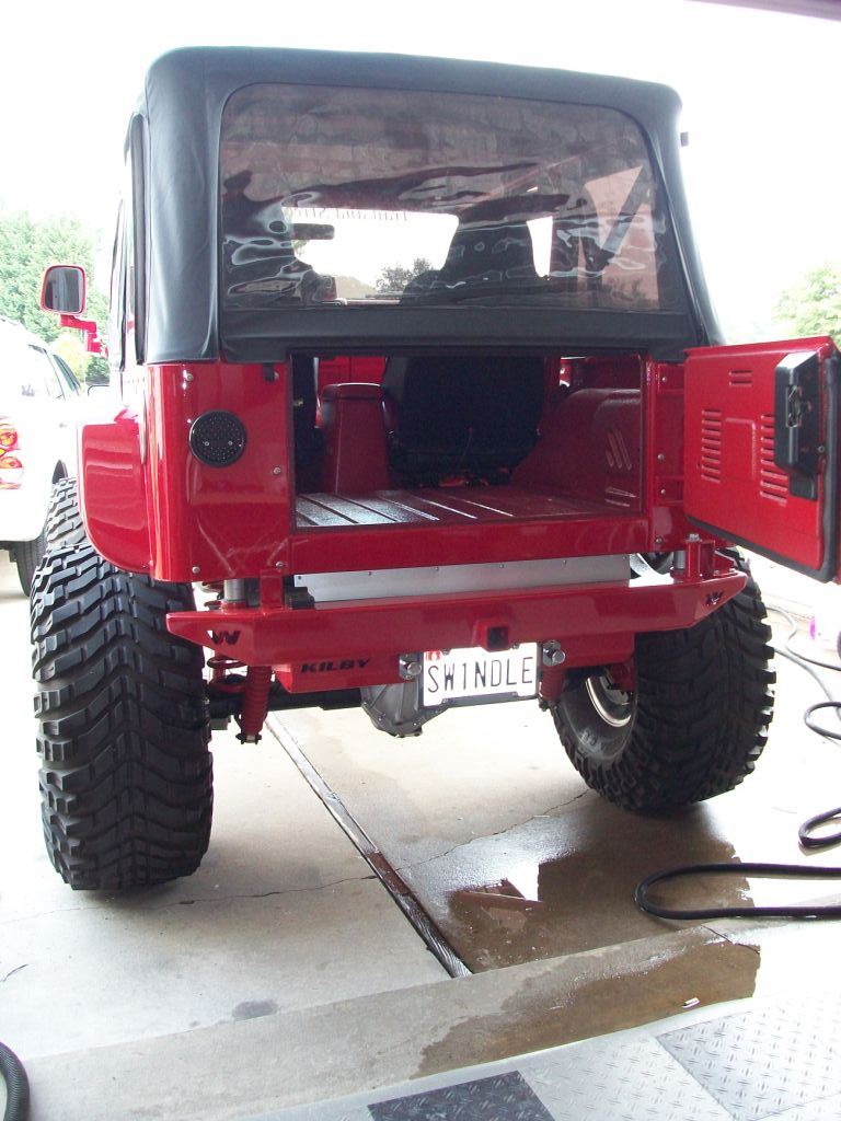

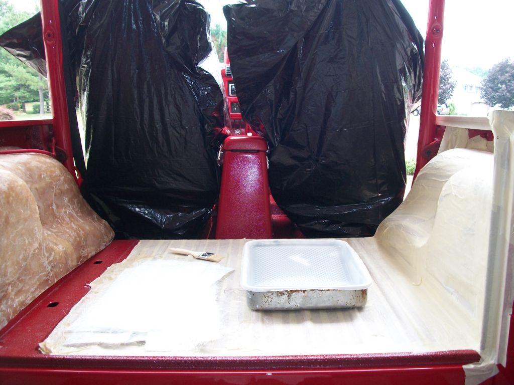

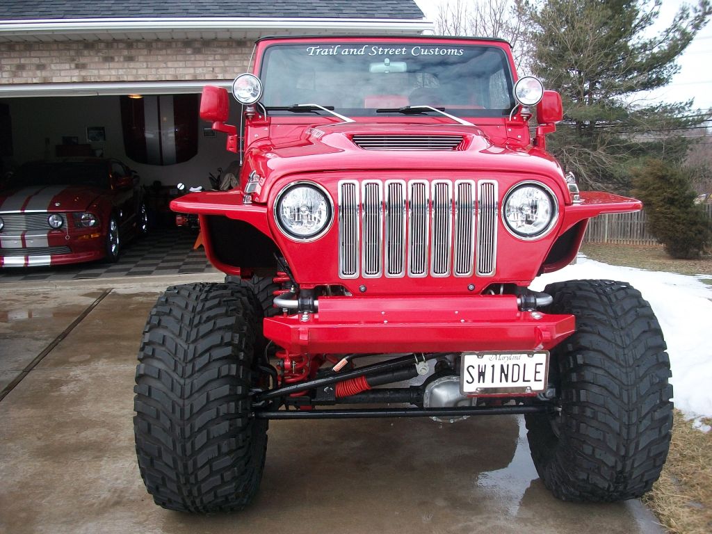

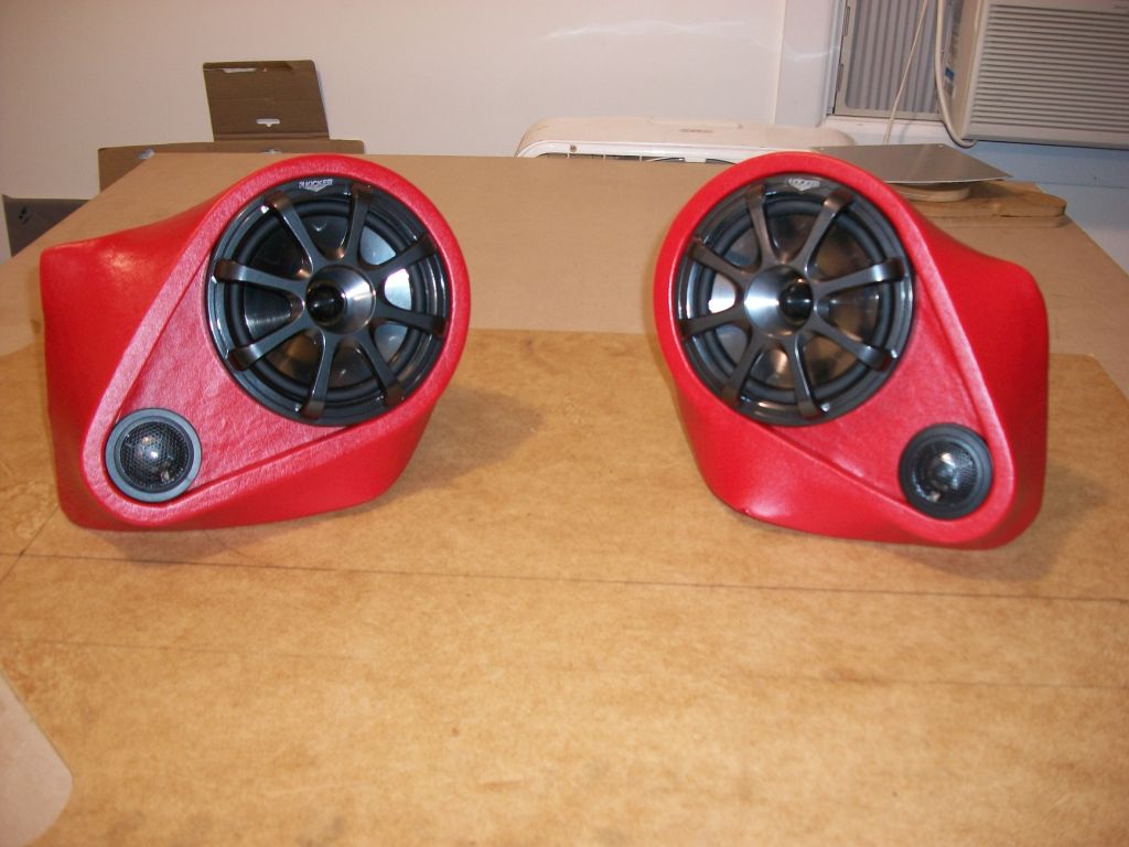

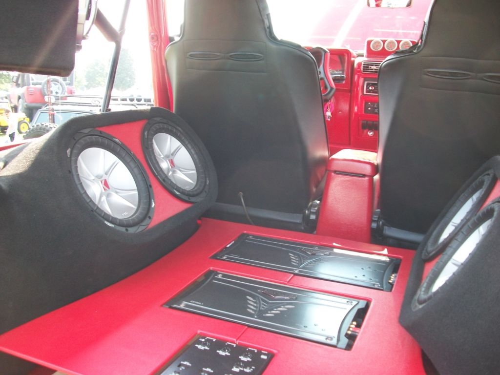

I, on the other hand, opted to ditch the rear seat altogether...how else would I get 4 tens in there right lol.
1997 jeep tj, fiberglass, rubn1out
