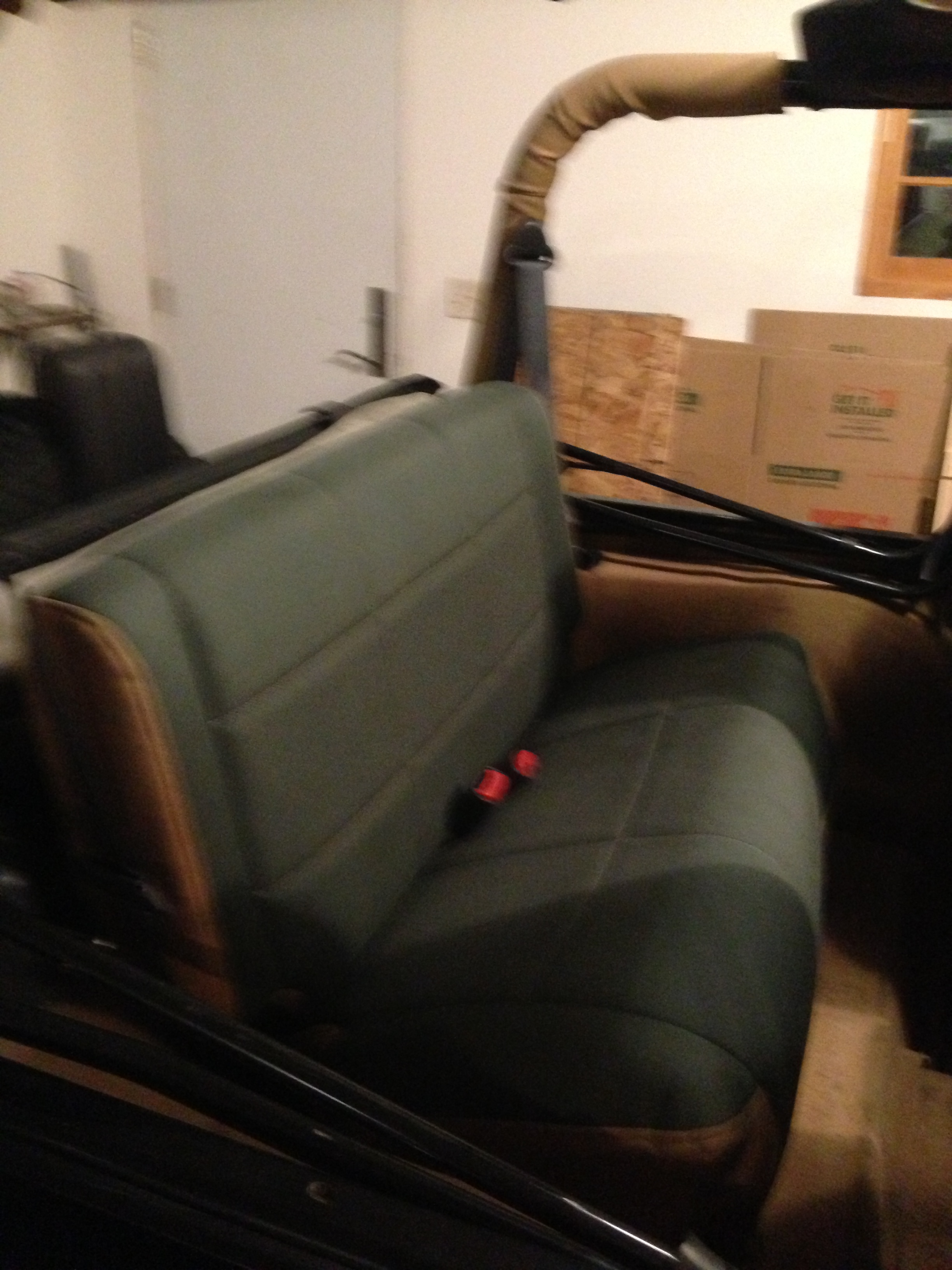

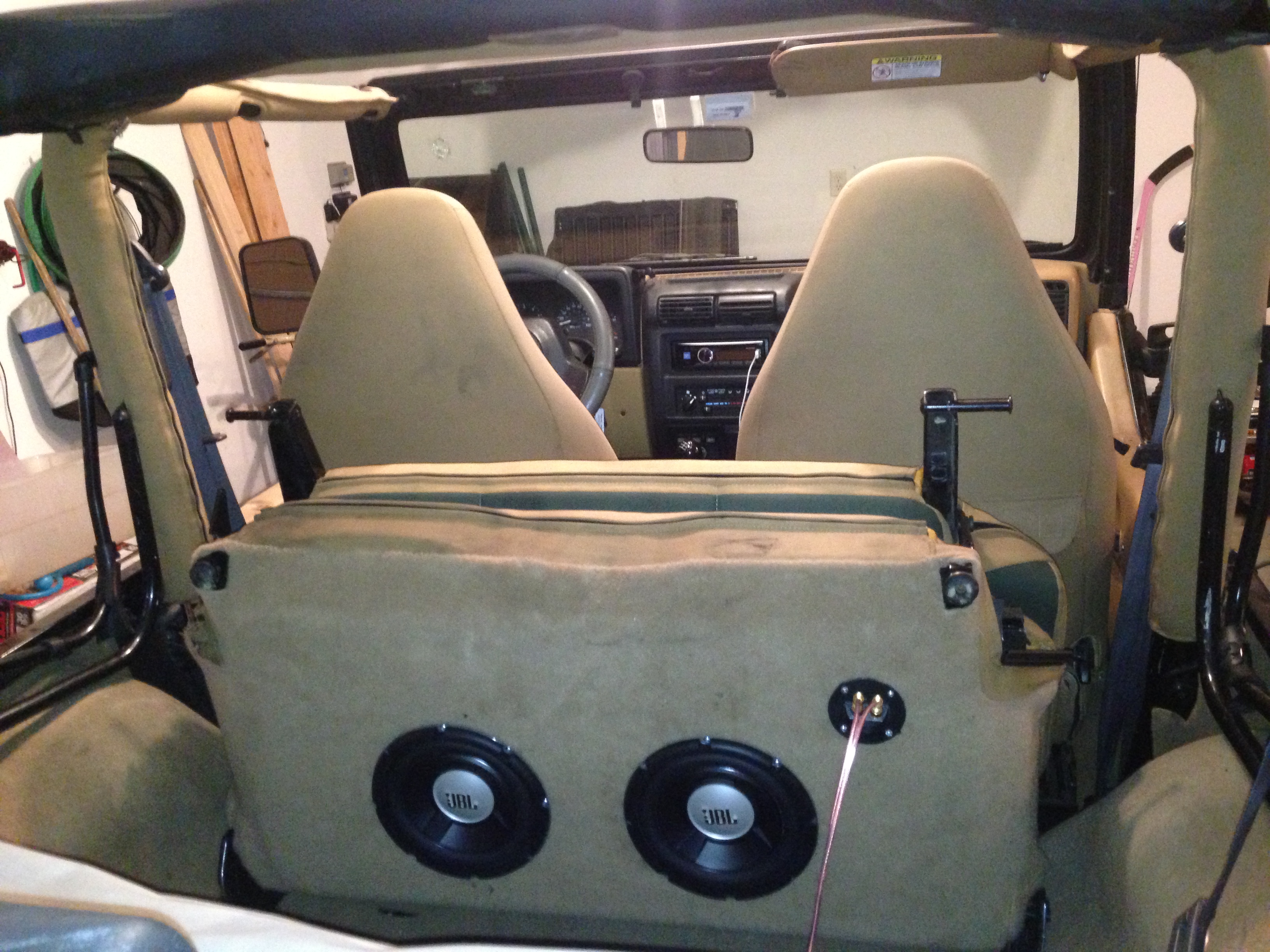

Subwoofer inside of a Jeep Wrangler rear seat
A lot of work, but came out great. Installed 2 8" subs, and 4 channel amp mounted in insta trunk.

I just finished this job with two ten inch subs and it worked great!! I couldn't have asked for better results!

I've read every post before asking the following question... I see you made 3 holes on bottom of box but only mounted one subwoofer. Are there two others that we cant see or is the 3 holes for a 3 sub demonstration but you were just doing 1 sub?
There was space for two 10" subs, but not three. Take a look at the first couple of posts again (there was a glitch for the forum software, and many photos were missing - it's fixed now). For me, one sub was great.
