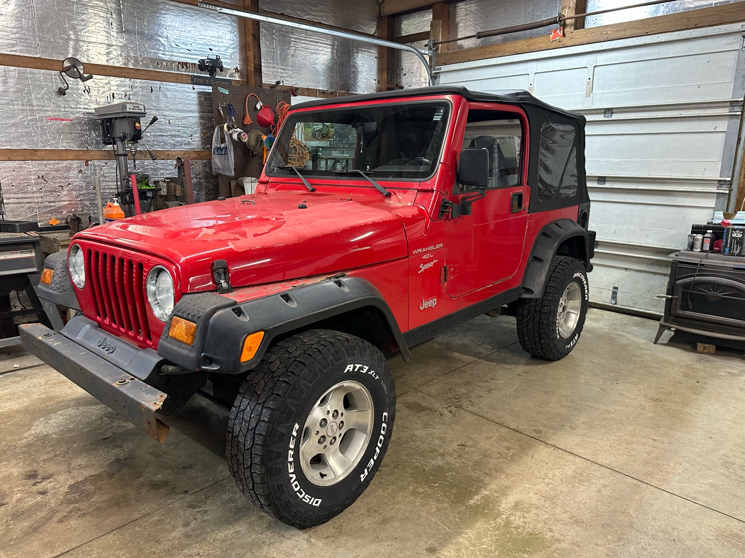

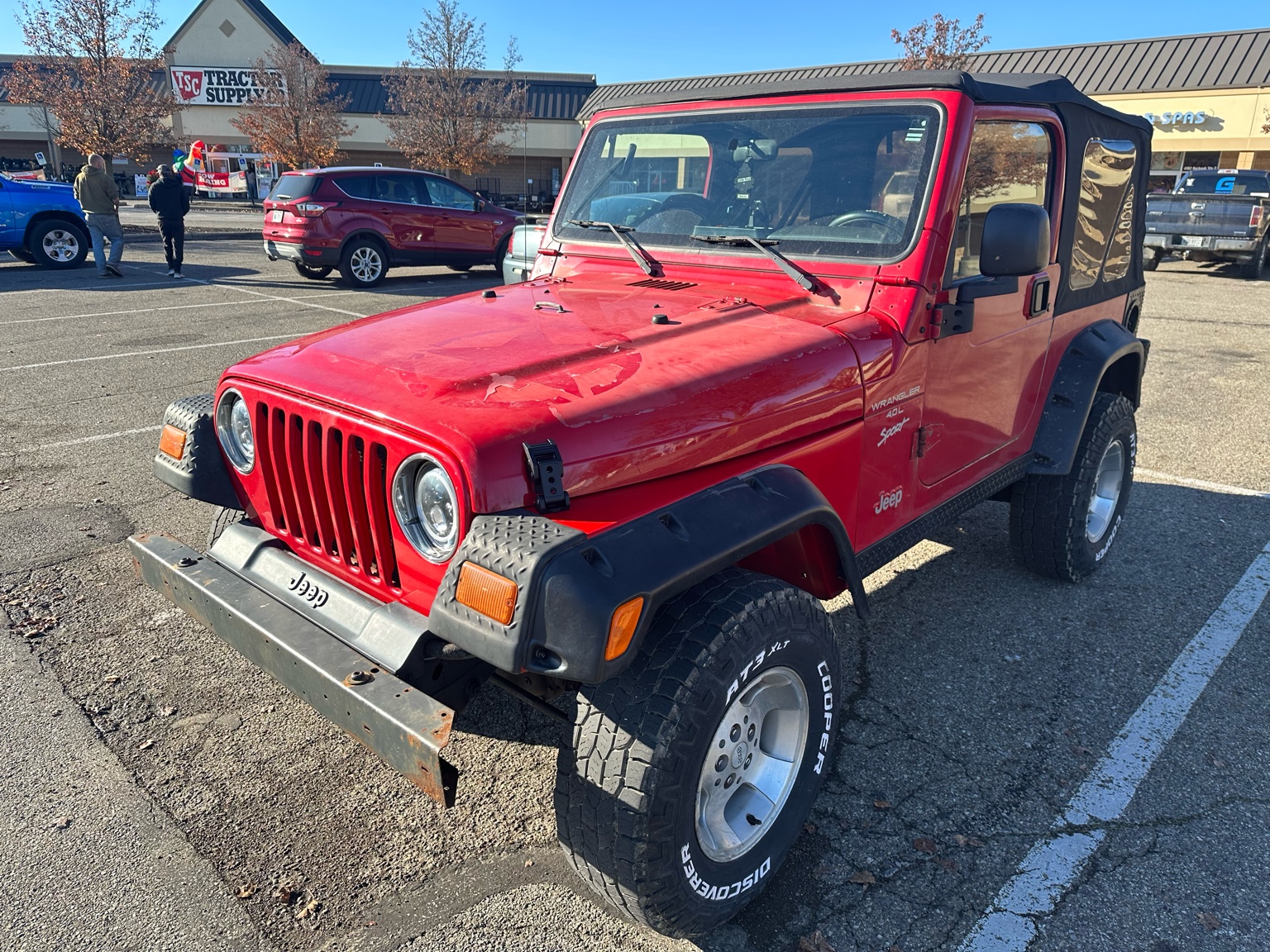

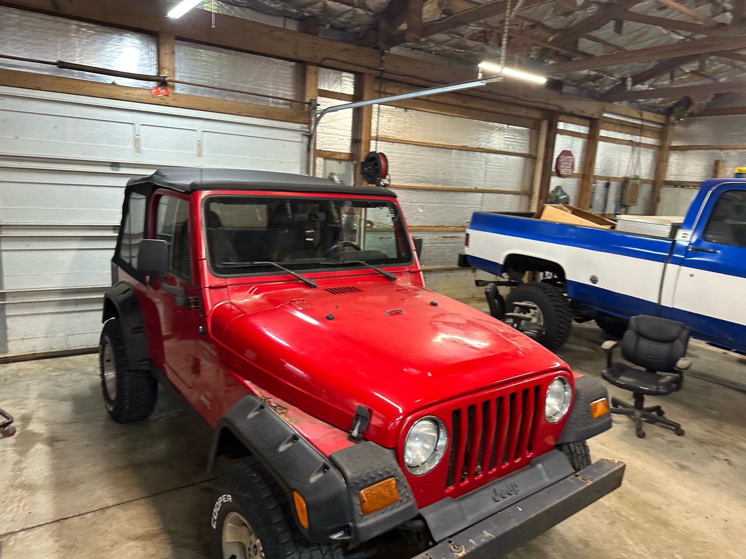

Been awhile since I updated this, going a different direction at this point. I?m being ?encouraged ? to part out the TJ. My wife wanted something she can drive?ended up picking up a 1999 4.0 auto
This is as it was getting it home. Does have some body rust (will be fixed) frame is pretty nice.

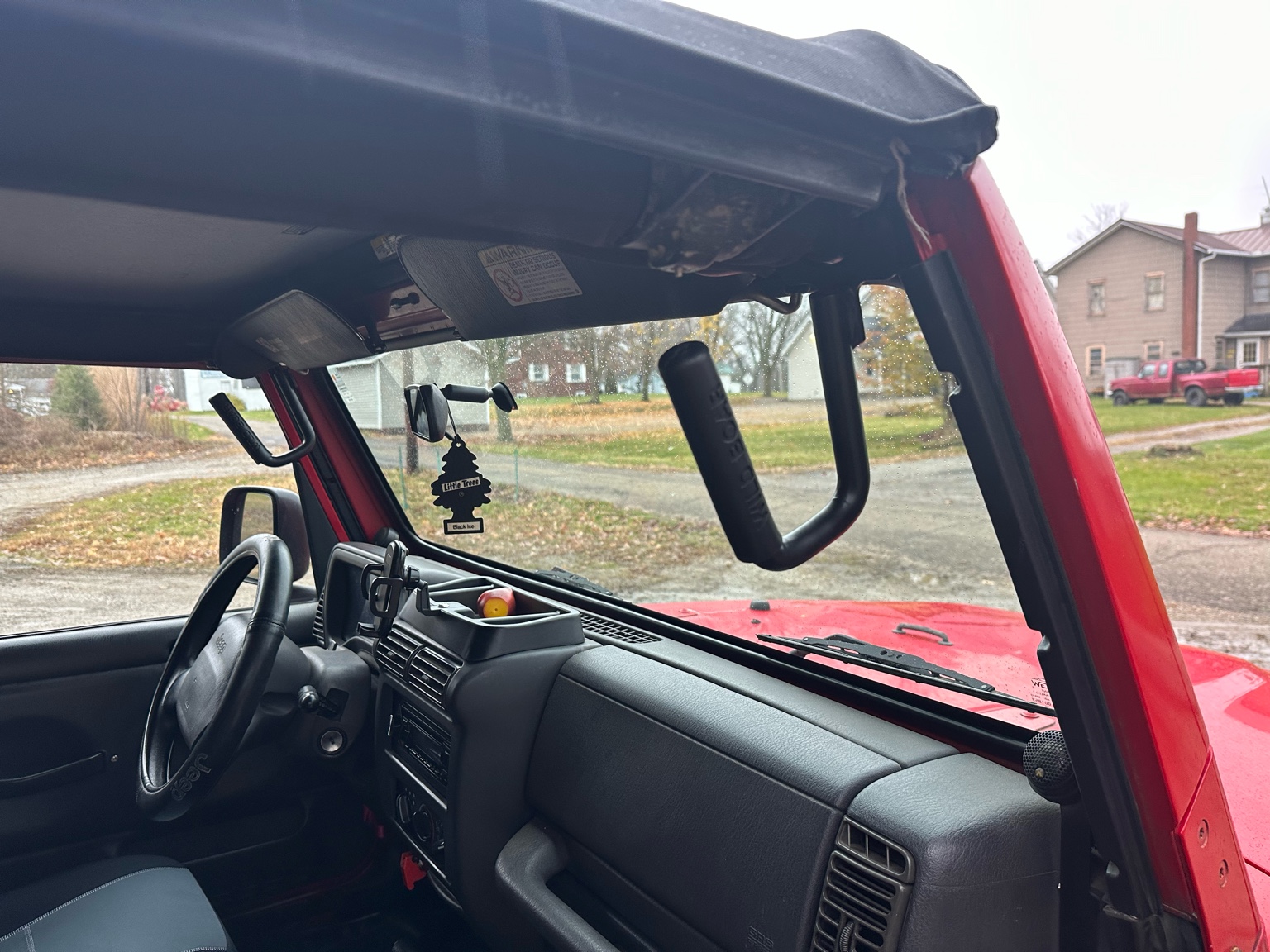

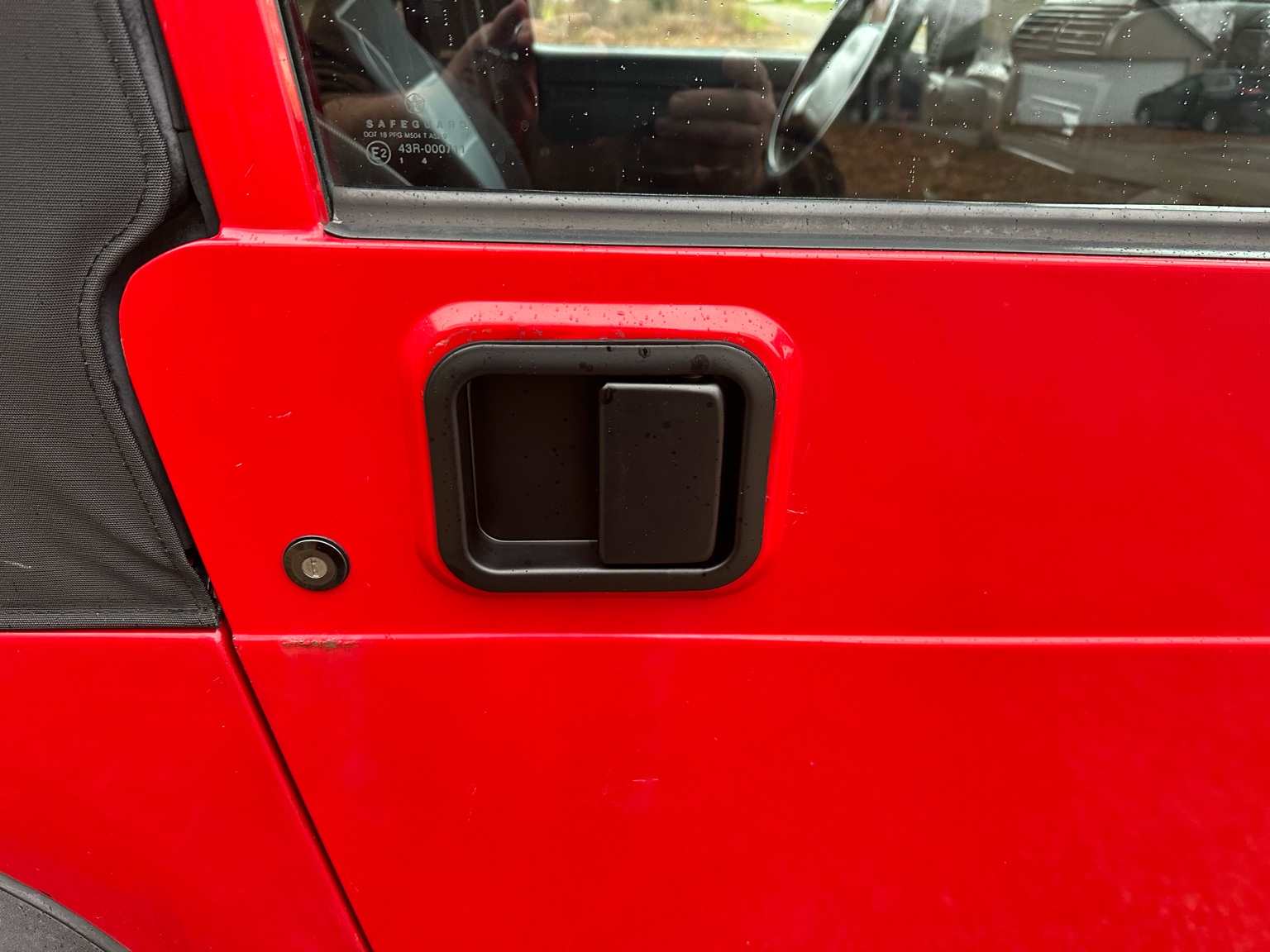

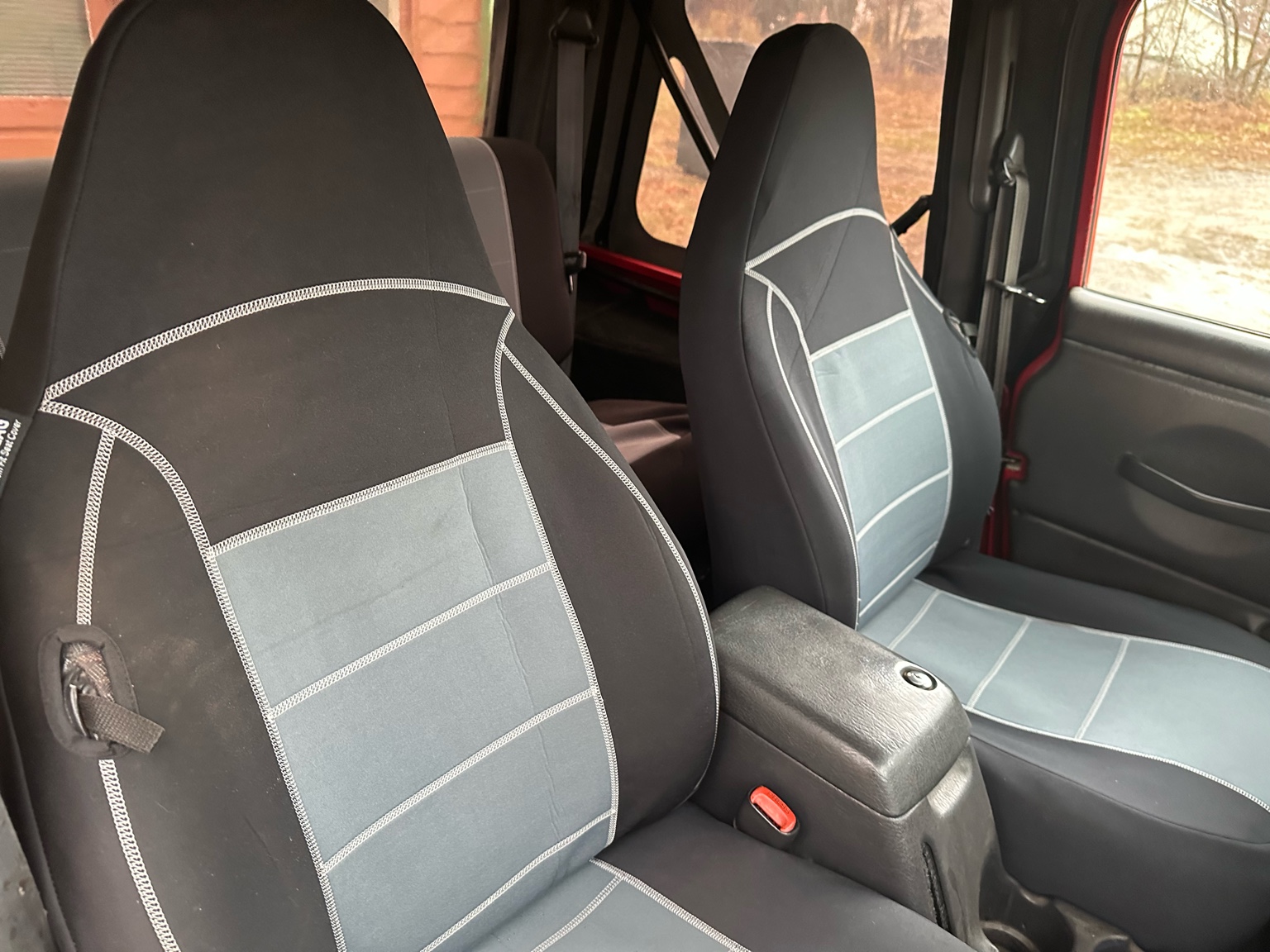

Started with some cosmetic upgrades, grab handles, seat covers, phone mount, new door handles as the originals were rusty. As an aside I now know way more about the inner workings of TJ doors than I ever had a desire too?

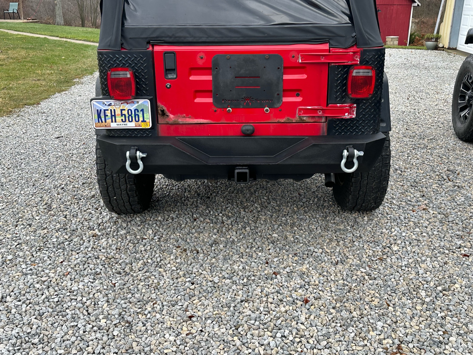

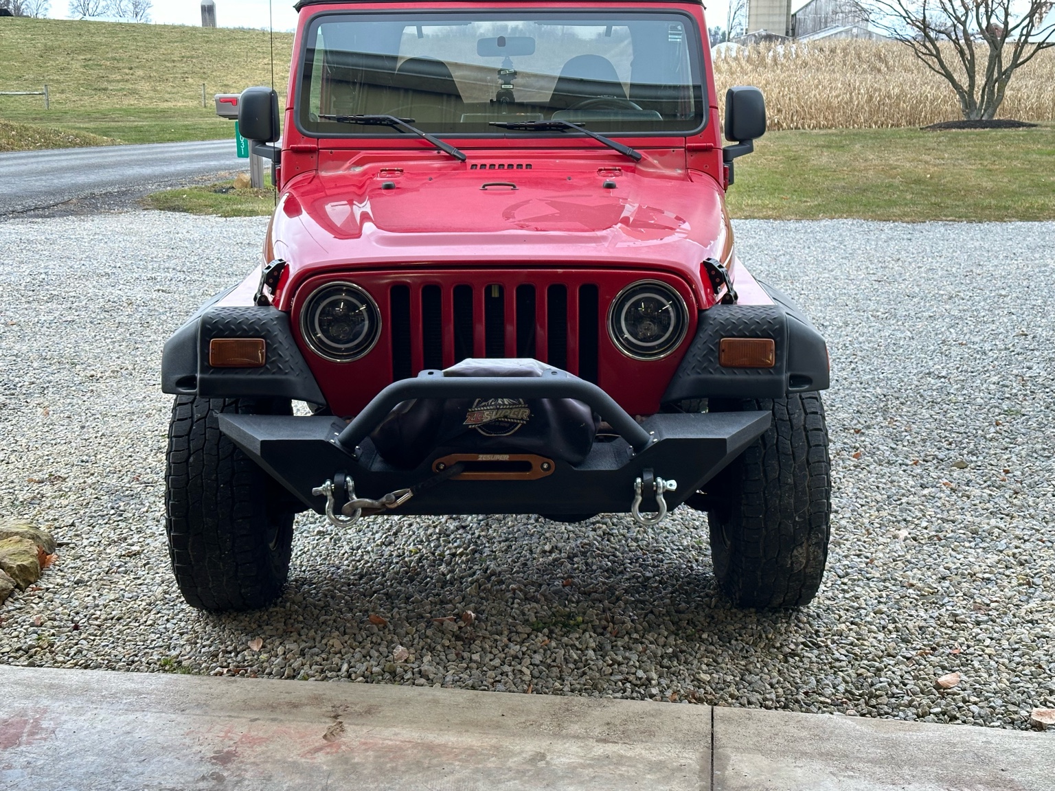

Got the front and rear bumpers done and winch on. Also trimmed the frame cover and got it back on.
