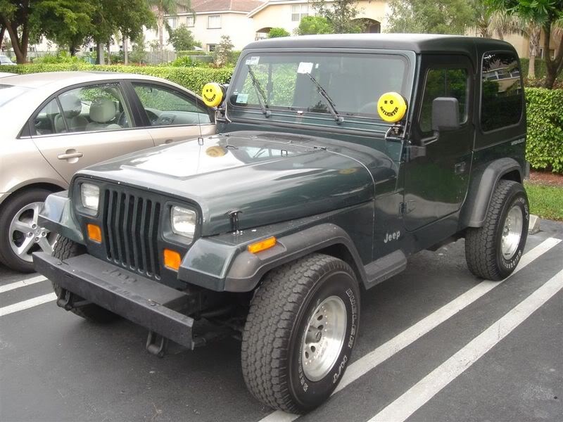

Here's how my Jeep looked when I bought it with no lift and 31's (note the springs are arching UP, so they are sagging; they are suppossed to be flat in stock form):

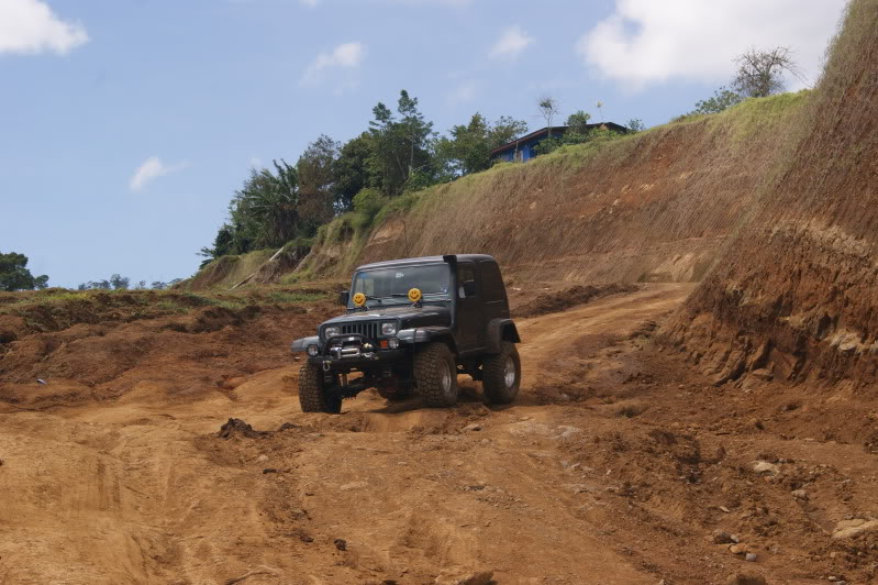

Of course, this is how it looks now... (could not post a pic of the Jeep looking so crappy without showing off how it looks now!)
