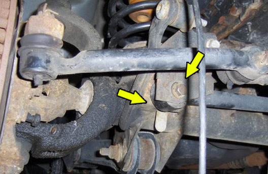

Death Wobble is the shaking that happens when the front end components of your Jeep end up reacting to, or fighting each other - the end result is a violent shaking of the wheel, the Jeep itself shaking like crazy, and you eventually needing new pair of shorts. Death wobble is most commonly seen in Jeeps that have just been lifted, but can also be found in stock Jeeps.
There are two aspects that contribute to make death wobble. First something to begins to wobble, like a tire imbalance or hitting a pothole or bump in the road. The second aspect is generally a loose or worn part that allows the minor wobble to escalate into full-blown death wobble.
Toe-in, caster setting, and tire balance all help contribute to the beginning of a wobble. Loose/worn parts like the front track bar, steering, and control arm bushings contribute to the second phase, when the wobble is exaggerated into DW.
I like to start with the cheapest option first, which is tightening up all the loose components on your Jeep. Here are the common torque specs for a Wrangler:
Ft. Lbs. (max - min)
Shock Absorber Upper Nut 23 - 17
Shock Absorber Lower Nut 28 - 25
Suspension Arm Lower Axle Bracket Nut 176 - 130
Suspension Arm Lower Frame Bracket Nut 176 - 130
Suspension Arm Upper Axle Bracket Nut 81 - 60
Suspension Arm Upper Frame Bracket Bolt 81 - 60
Stabilizer Bar Retainer Bolts 61 - 45
Stabilizer Bar Link Upper Nut 61 - 45
Stabilizer Bar Link Lower Bolt 102 - 75
Trackbar Ball Stud Nut 81 - 60
Track Bar Axle Bracket Bolt 47 - 40
Hub/Bearing Bolts 102 - 75
Hub/Bearing Axle Nut 237 - 175
Jounce Cup Bolt 42 - 31
CAUTION: Suspension components with rubber/urethane bushings (except stabilizer bar) should be tightened with the vehicle at normal ride height. It is important to have the springs supporting the weight of the vehicle when the fasteners are torqued. If springs are not at their normal ride position, vehicle ride comfort could be affected and premature bushing wear may occur.
Assuming that tightening your suspension didn't fix the problem, it's time to get down to the causes and cures of Jeep Death Wobble (starting with the most common and cheapest then moving on)
