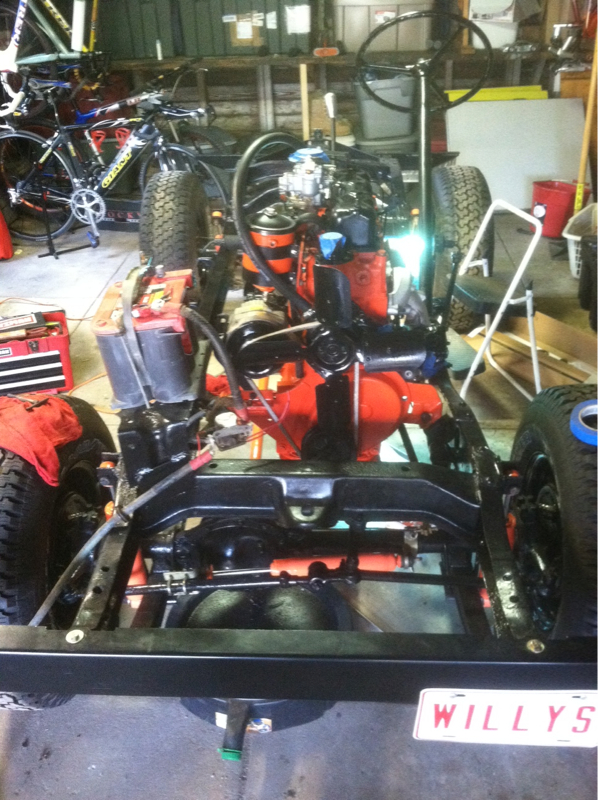

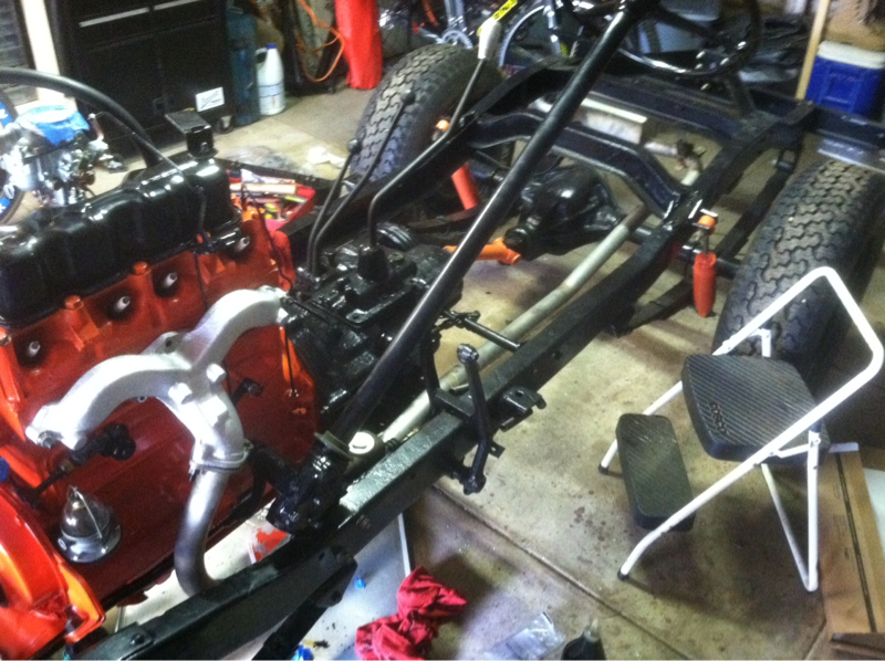

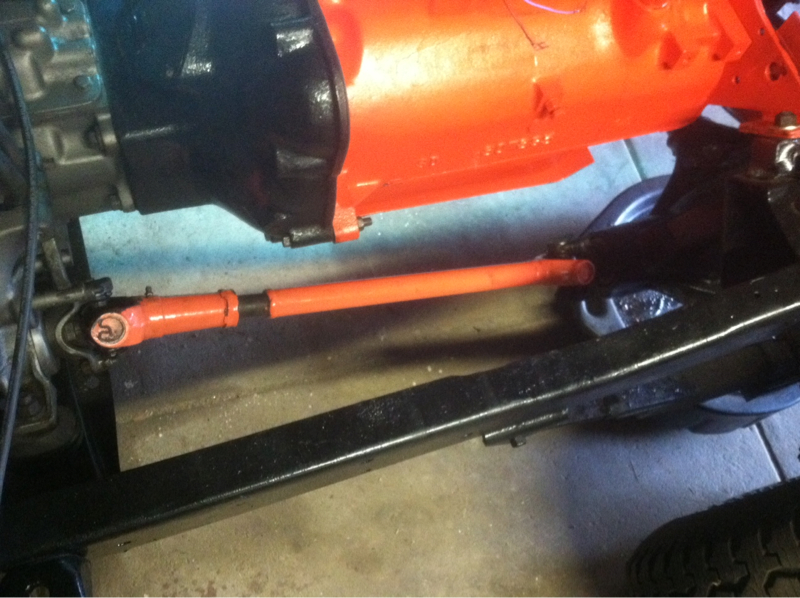

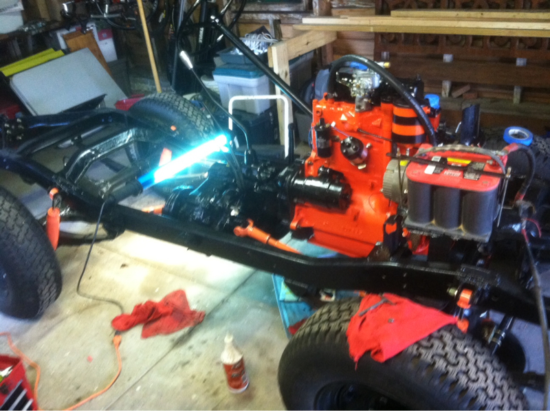

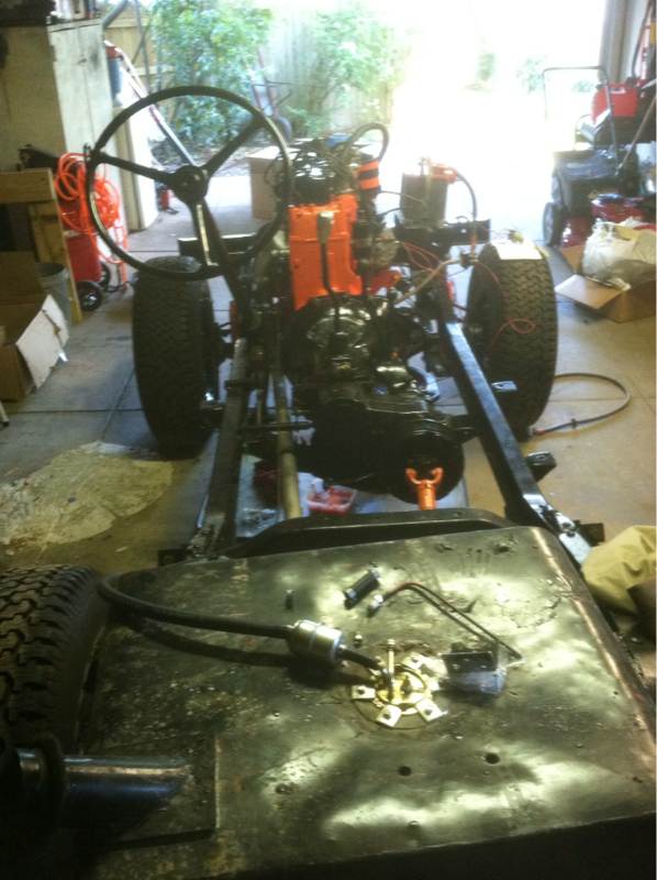

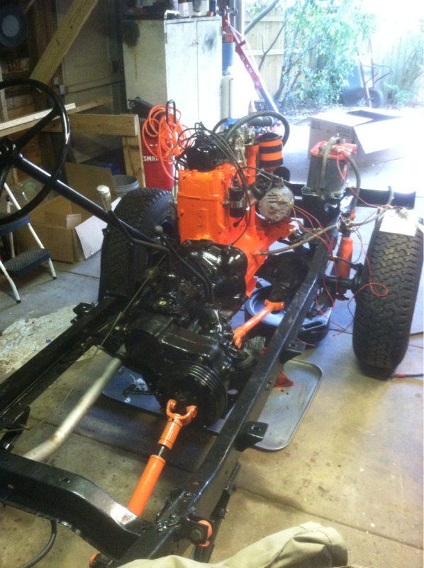

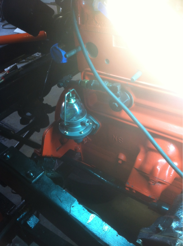

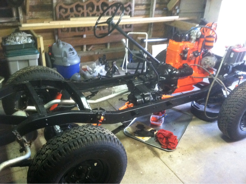

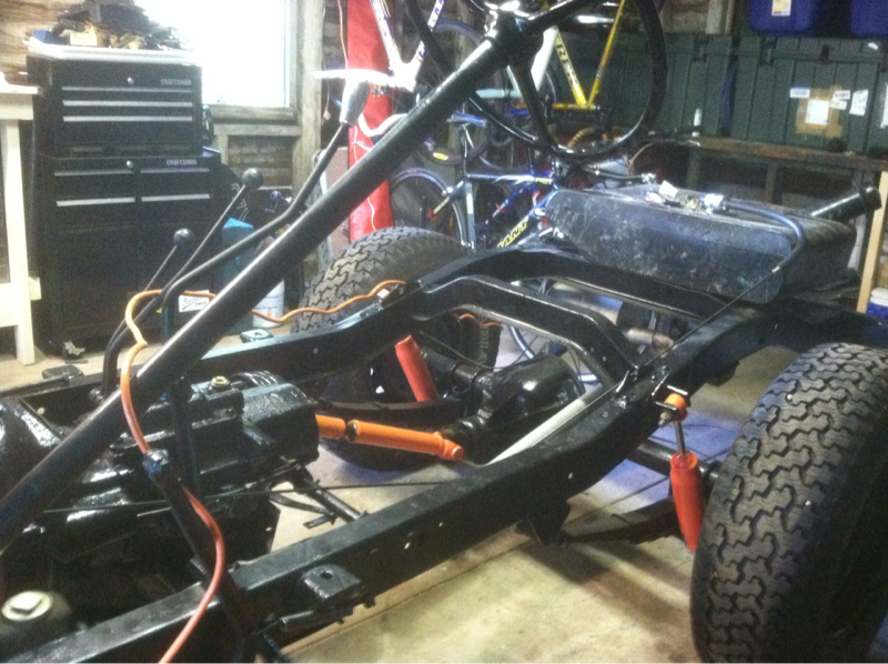

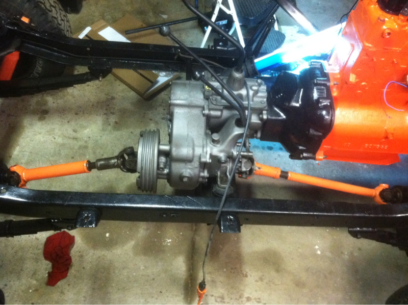

Progress! Installed a new mechanical fuel pump. Installed both drive shafts (painted with POR-15's Hardnose Orange).

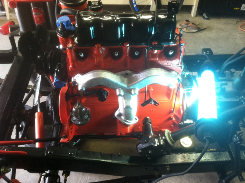

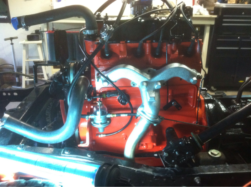

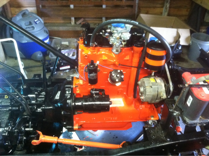

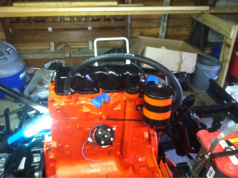

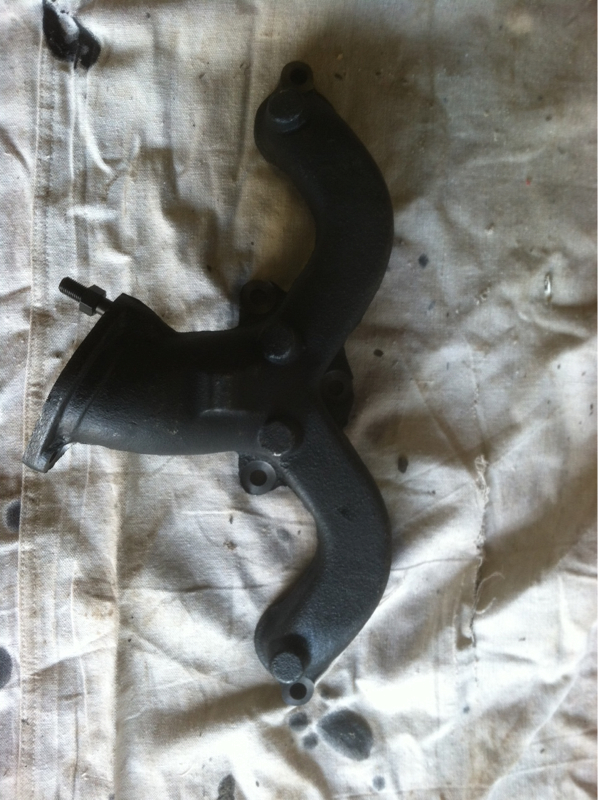

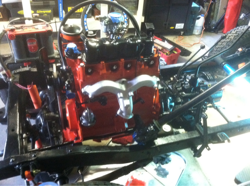

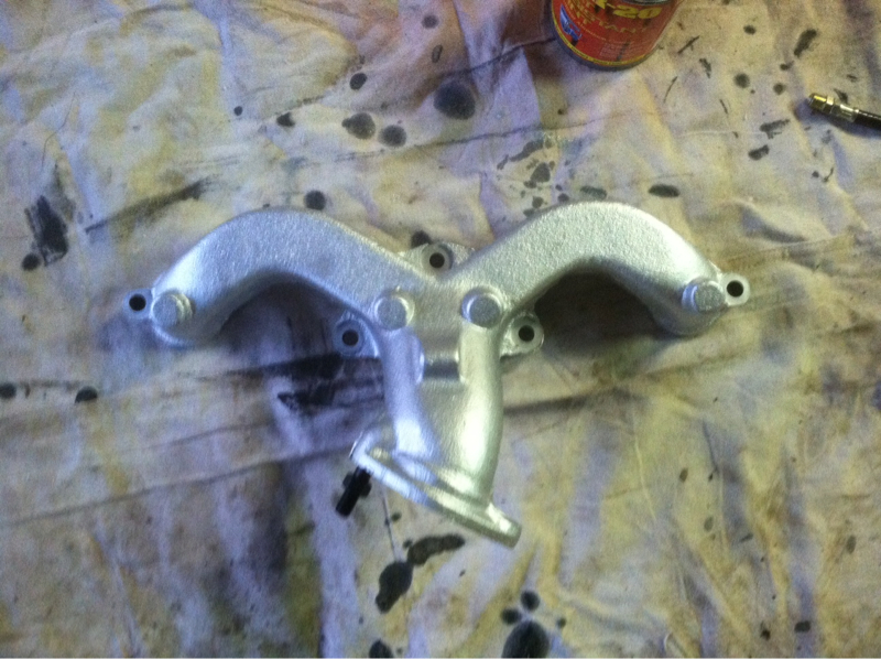

Installed the following new items: Exhaust manifold, ignition coil, starter, and carb. I put a coat of POR-15 on the transmission /transfer case. The fuel pump has become very painful to install. Hopefully I will figure that out tomorrow.

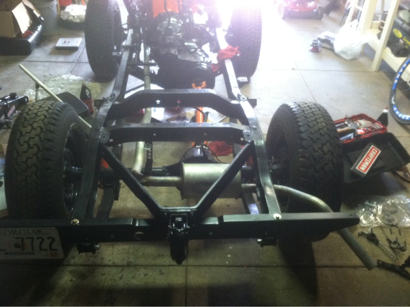

I installed the exhaust today. I am going to weld it together next and put on some POR-20 high heat exhaust paint.

New OEM mechanical fuel pump finally installed despite problems initially. The far left bolt is in a very difficult spot. There is no room to maneuver a wrench. Got the fuel line ran to my tank resting temporarily on the frame. Body update: sandblasting complete, body work started. More detailed pictures of the body to come as I get them. Also, my original starter died so I bit the bullet and ordered a new high torque starter from www.kaiserwillys.com.

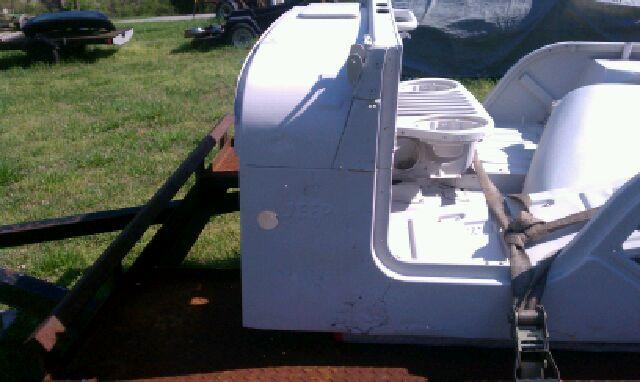

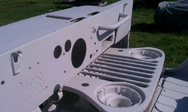

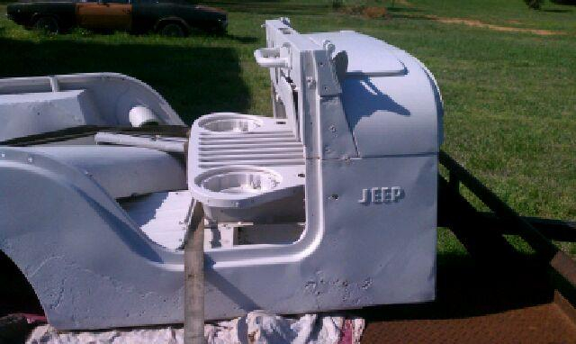

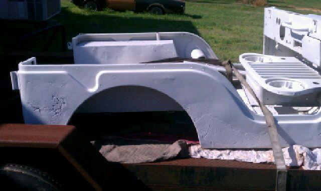

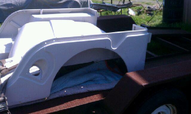

Here are some pictures of my body tub as it is now. Sandblasted but i need of some body work. Any ideas where i can get the front and rear quarter panels as one piece? Ive seen them for later model CJ5s but nothing from the 1950s.

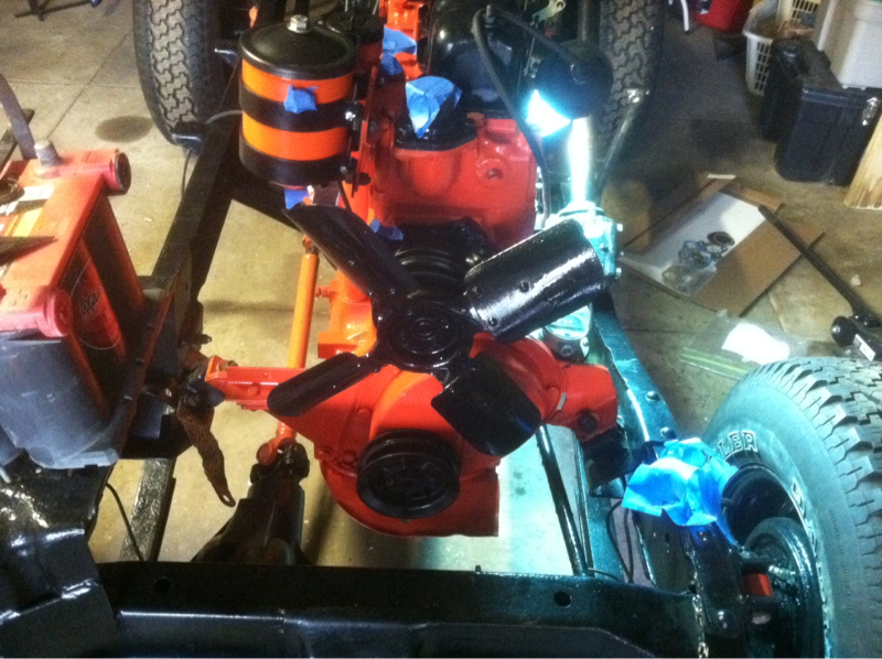

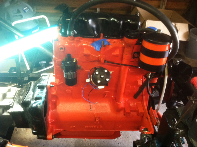

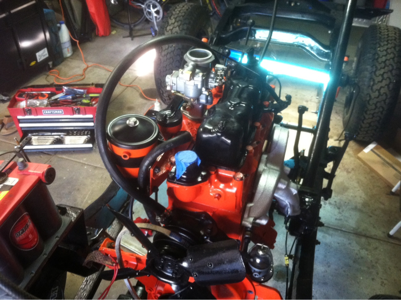

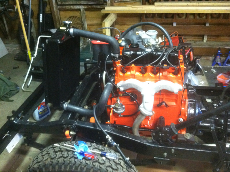

I got the engine started and got it timed. Everything looks, sounds good. I wish I could upload the video of it running. Looking to install the new radiator in the next few days so I can run the engine for more than a few seconds.
The engine has a nice thick coat of orange POR-15 engine enamel. The distributor could not get a good ground. Simple and embarrassing oversight.

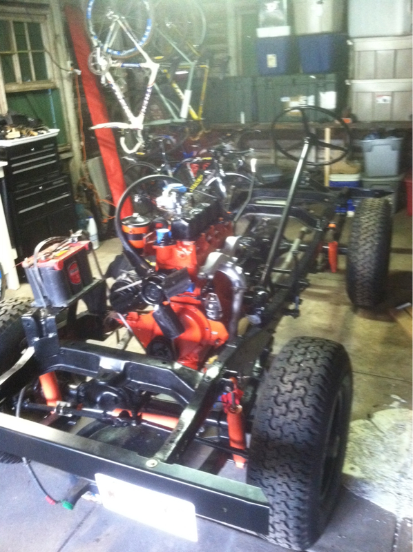

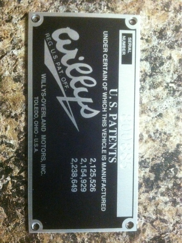

Radiator installed and data plates engraved with my Serial number.
