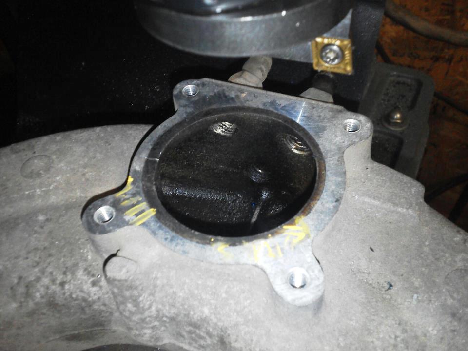

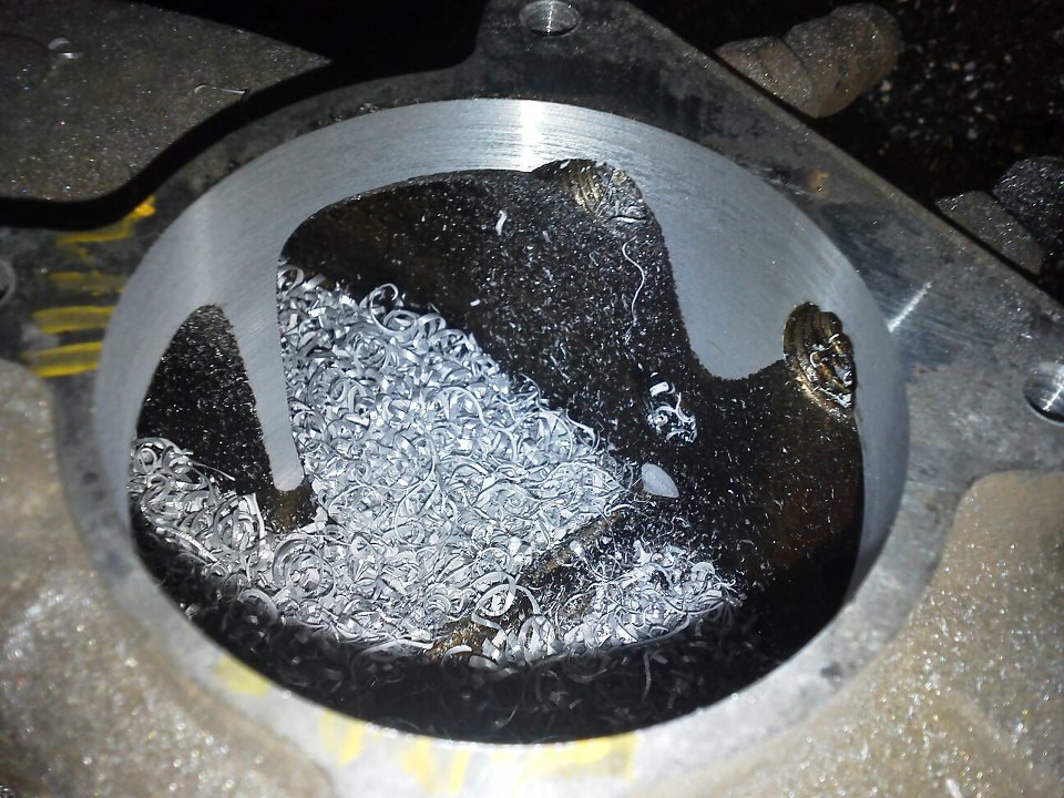

how big is the bore on a stock 4.0 throttle body. i've seen them bored out to 62mm.
I've gotten the intake manifold to 64mm for a 2.5L guy before. 62mm works better for the gasket/rtv though.
that picture is right before the finishing cut...so more like 63.95mm.
here is 55mm from the factory:
Side note: I have 1 YJ and 2 TJ intake manifolds sitting next to the mill if anyone else is interested.
