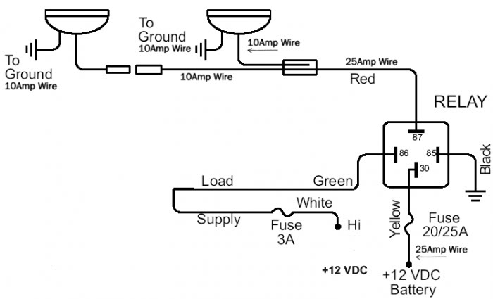

In this pic the lights would be the fan,
Green the switch. So, to make it always on, the green wire goes to a 12 volt source that turns on with the ignition (not the acc side, just the running side).

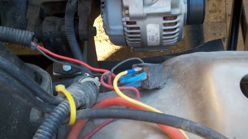

the yellow still goes to the battery because thats what you need, clean strong power,

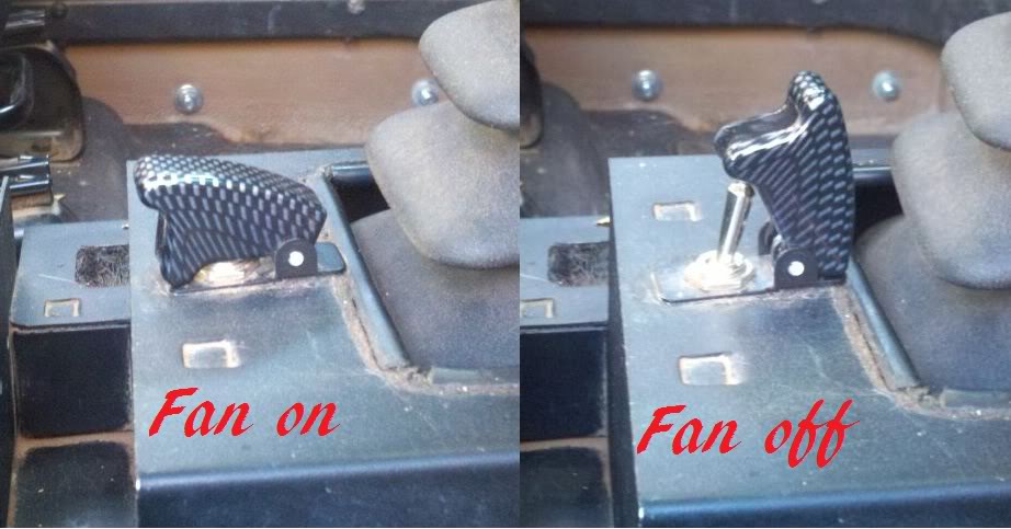

the ground on the relay is where you want your toggle switch, remember that the switch has to be on for to work, when the switch is off, the ground breaks and the fan shuts off, so if you have a shielded switch like this one, the switch has to be turned around so that its on when the cover is closed and off when up.
The fan has its own ground, this needs to be grounded as close to the fan as you can, mine is grounded to a bolt on the inside of the grill right outside the shroud, and you'll want to touch the wires to your battery before hooking it all up and make sure the flow direction, usualy the fan has a black and a yellow wire, on mine black is (+) positive and yellow is (-) negative

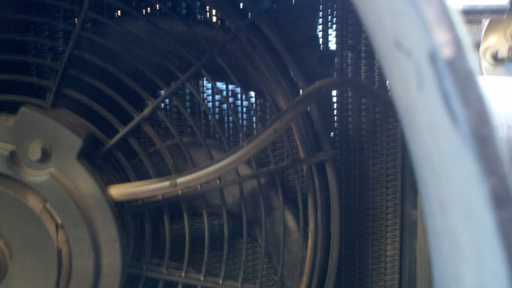

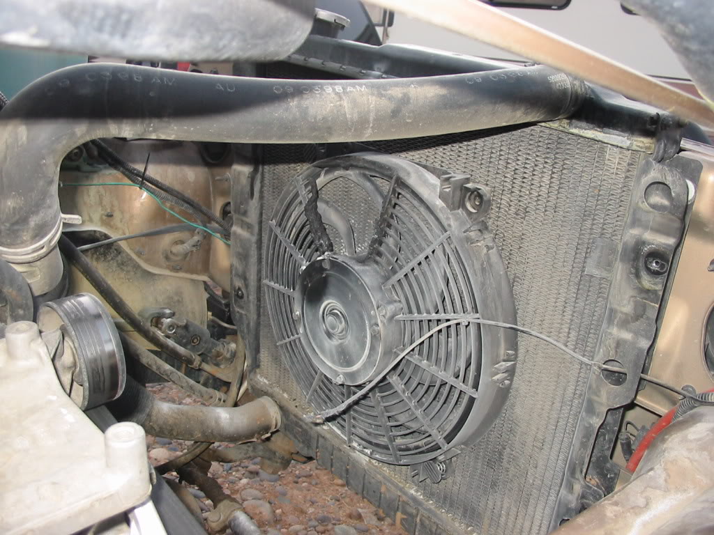

The fan I used was a little under $100 at O'Rielly (may be more in some places), its a Hayden 16" high flow fan and comes with everything to mount it, but not the 30a relay
I have had good luck with this fan crawling and off-road, this is the reason I dont use salvage yard fans, this happened on the trail in Moab, and the flames were about 3' tall and took a full 3 lbs extinguisher to put out.
Of all the ""get more power"" mods I have tried, this is the only one with a seriously noticeable difference. I dont think I made this look easy and it really is, I would reccomend taking the shroud off to attach the fan, just be sure to get it centered and test fit the fan to ensure it fits within the shroud. Happy trails. :)
