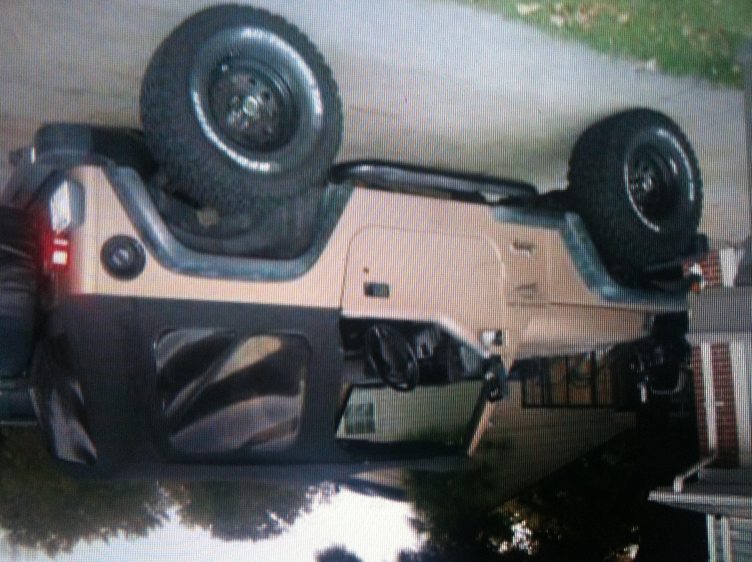

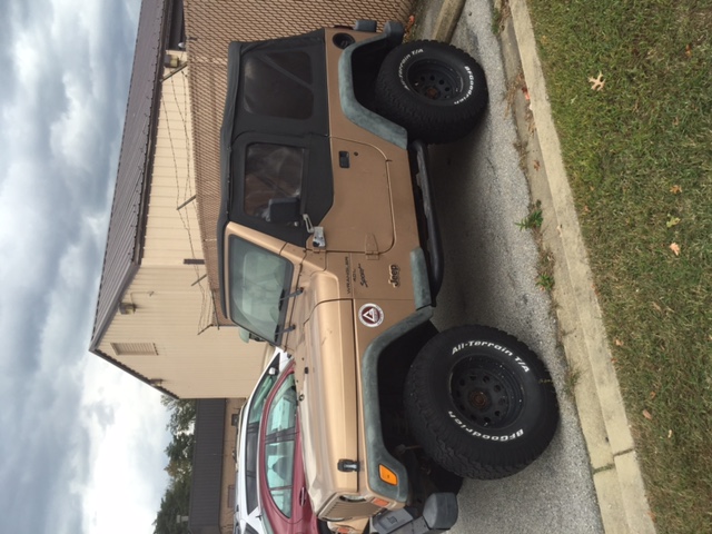

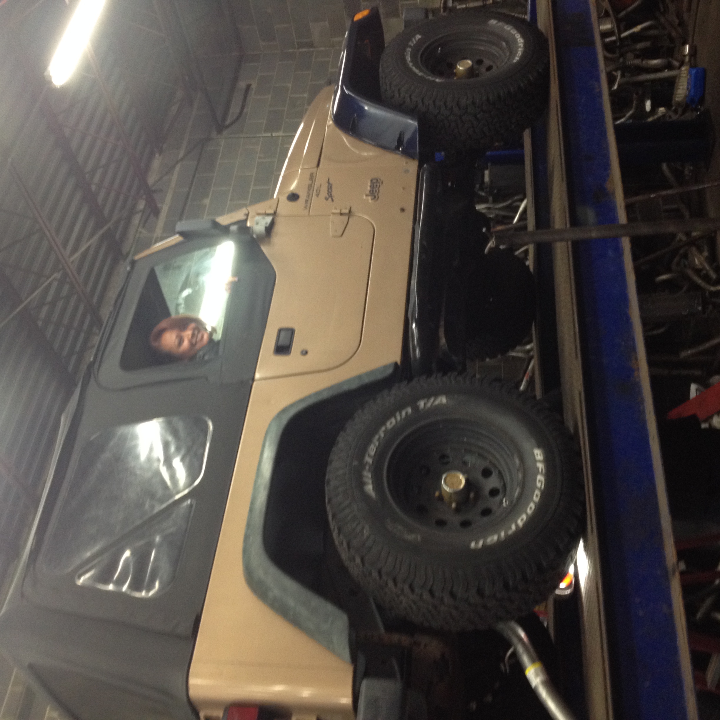

geez i dont know how the upside down pic came upside down its not like that in my library, and thats actualy when i bought, the other two is when i have put work in..thanks again
sorry for all the post, just have thoughts, i guess maybe those pics dont help much but also those pics the tires were overflated. ok thanks
The third pic in the rear wheel well it looks like the well is tight to the frame so you likely do not have a body lift. Body mounts can still be an issue if they are rotted out.

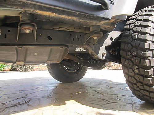

One like this may be helpful.
Take some photos of your control arms, as well as your body mounts. Something along the lines of this perspective
